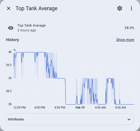

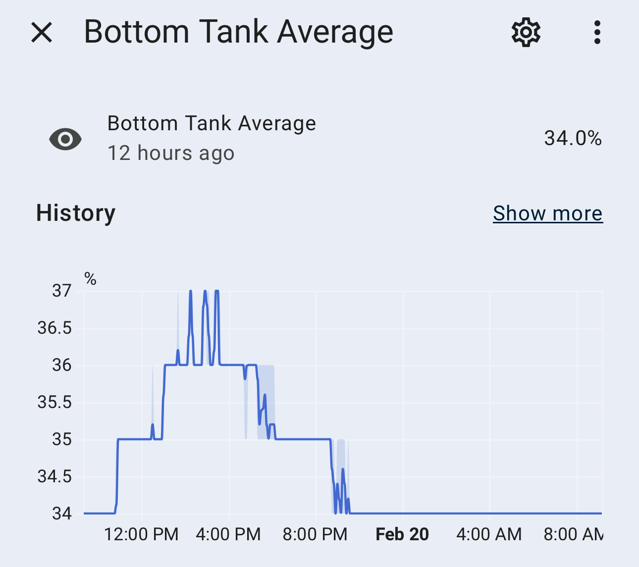

So I have all working now, but I am still getting fluctuations, and I am now wondering if this is due to the ambient pressure differences.
I have added a local barro to my weather station, and wondering if I can use this to offset the pressure changes in HA.
Looking at your graph your fluctuations are within 2%???
I could live with that
Yea true, but sometimes they are like 7% fluctuations.
Just depends on the temperatures etc.
For example.
Looks to be clear that it is temperature. Maybe try and shade your gizmo box. Mine is under cover.

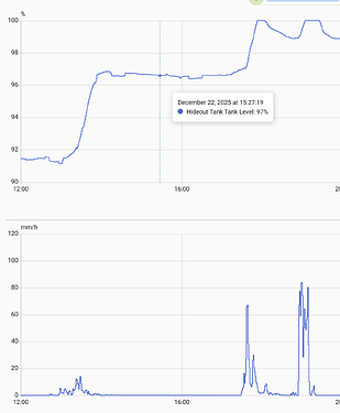

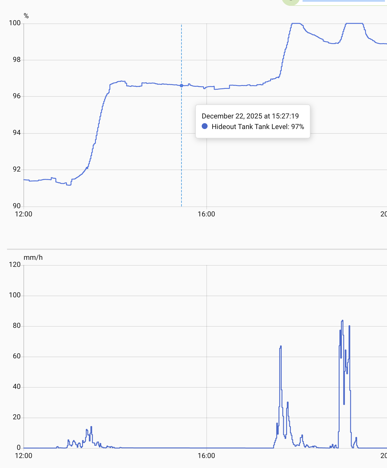

Just adding to the feedback on what works; I installed a pressure sensor (one from Aliexpress, fairly hefty stainless steel probe with a cable incorporating a reference tube) into a rainwater tank, reading with an ESP32-C3 using the ADC.
The tank is about 2m deep, the sensor is 4-20mA rated for 3m depth, so I used a 180ohm load resistor and a 10K/4.7uF LC filter to the GPIO pin, plus a 20 sample sliding window averaging filter in the yaml. The sensor is powered from 12V, the C3 board has a switching regulator dropping the same 12V to 3.3V.
The results are excellent, below is a graph from HA showing reported tank level vs rain rate. My calculated values for converting ADC voltage to % were almost spot on - it’s going to 100% with rain then dropping to 99 so I have since tweaked the multiplier slightly. I previously checked that it read 0% with the sensor out of the water.
I also have an analog threshold binary sensor with hysteresis to control a valve that will refill this tank from a larger one using gravity feed so it gets topped up when usage exceeds rainfall.
