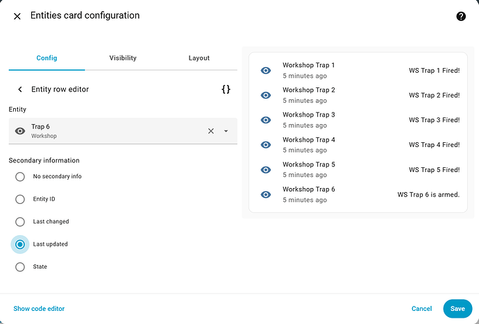

For reference there is secondary information available on dashboard. Thanks for all the help.
