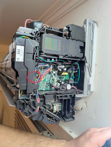

I spent a fair bit of time trying to set up a broadlink IR unit with my Daikin FTXM95WVMA, with very limited success. I bought the Fakin and installed it yesterday. For this daikin unit, accessing the control board was a pain and quite stressful, the entire shell of the unit needed to be removed, including 9 seperate screws (3 hidden) and a bunch of clips. Eventually I accessed the board, plugged in the unit and the faikin popped up on the local wifi. Here’s a photo of the exposed board with the plug location circled for anyone else with the same unit.

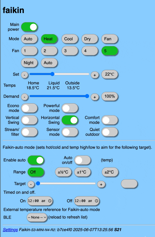

The unit is set up in HA now, but I’m still having a few issues with the functions. Some of the settings such as “powerful” and “comfort mode” can be toggled on in the UI, but the toggle switch automatically switches off again after a few seconds. Does anyone have any idea how to activate these extra functions? Here’s a gif of this in action

Also, what does the “demand” function do?
I don’t know what all those functions are - I know that they have added a TON to this since I started this post; and there are a bunch of new functions in the Faikin that did not exist when I started - I also know that some functions are specific to some specific models, so while they might be there, they might not do anything for your model.
Fair enough, however the “powerful” and “comfort mode” are certainly features of my model. The comfort mode feature spins down the fan to a super low setting which is great once the room has heated up/ cooled down but you still want a bit of airflow.
There a quite a few FTX* models reported where the “Powerful” mode is not working. Your FTXM95WVMA seems to be not listed at all as a known working model. Maybe you want to add it?
It’s there as FTXMxxWVMA
FTXS here. i can confirm powerful/eco mode are supported by the splits but not controllable via S21 interface. nothing you can do on thi, if your FTXM is the same
The dev is aware of the issue. Another user reports that the mode used to work on an older build, so it’s possible it may be fixable.
