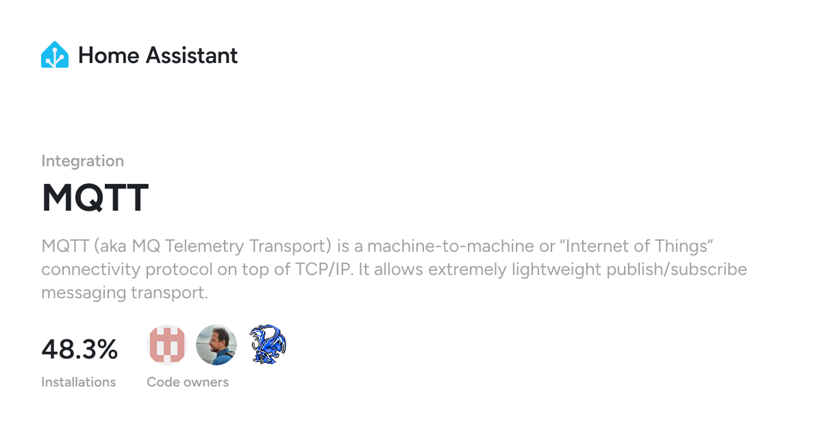

Getting MQTT added to Home Assistant is pretty easy though. I believe you can now use the module without MQTT, though I have not personally tried this.
For what it is worth, MQTT is a great thing to have for automations. I strongly recommend you add it.
Docs here:
Thanks, I thought that installing MQTT just for FAIKIN would be something extra on the system that I wouldn’t use for now (or maybe because I don’t know how to use it because I manage everything even without it… but that’s another topic)

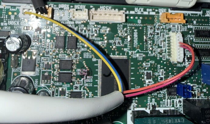

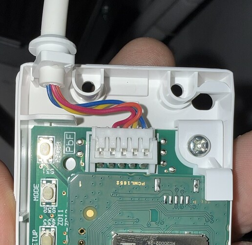

I currently have a BRP069C41 installed, which has 4 wires coming out of it and going to the internal unit with connectors X50A and X35A.
My intention is to replace the pins of the BRO069C41 (where the connection is made up of 5 wires but 4 come out) and install the FAIKIN without touching the X50A and X35A connections inside the unit.

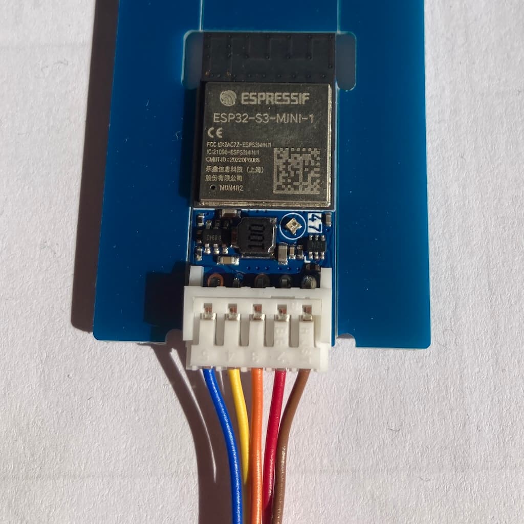

However, I see that the FAIKIN has 5 connection pins. Can I directly replace the BRP069C41 with the FAIKIN or do I have to use the adapter cable (already ordered into the kit ordered) that carries the 5 wires to the internal unit?
(if i am not wring the 5th cable should be the 5V cable)
You can use the BRP069C41 cable. The missing brown wire is the 5V line but you don’t need that as the Faikin can be powered from 12/14V on the blue and yellow wires. Just make sure you get it round the right way
…thank should arrive soon the board…
one thing… how can you cut the PCB board?
If you scroll way way up you can see my picture of one of the original boards. I had to grab the board with two sets of pliers and break it along the scored lines. I believe the new ones are also scored in this same manner.

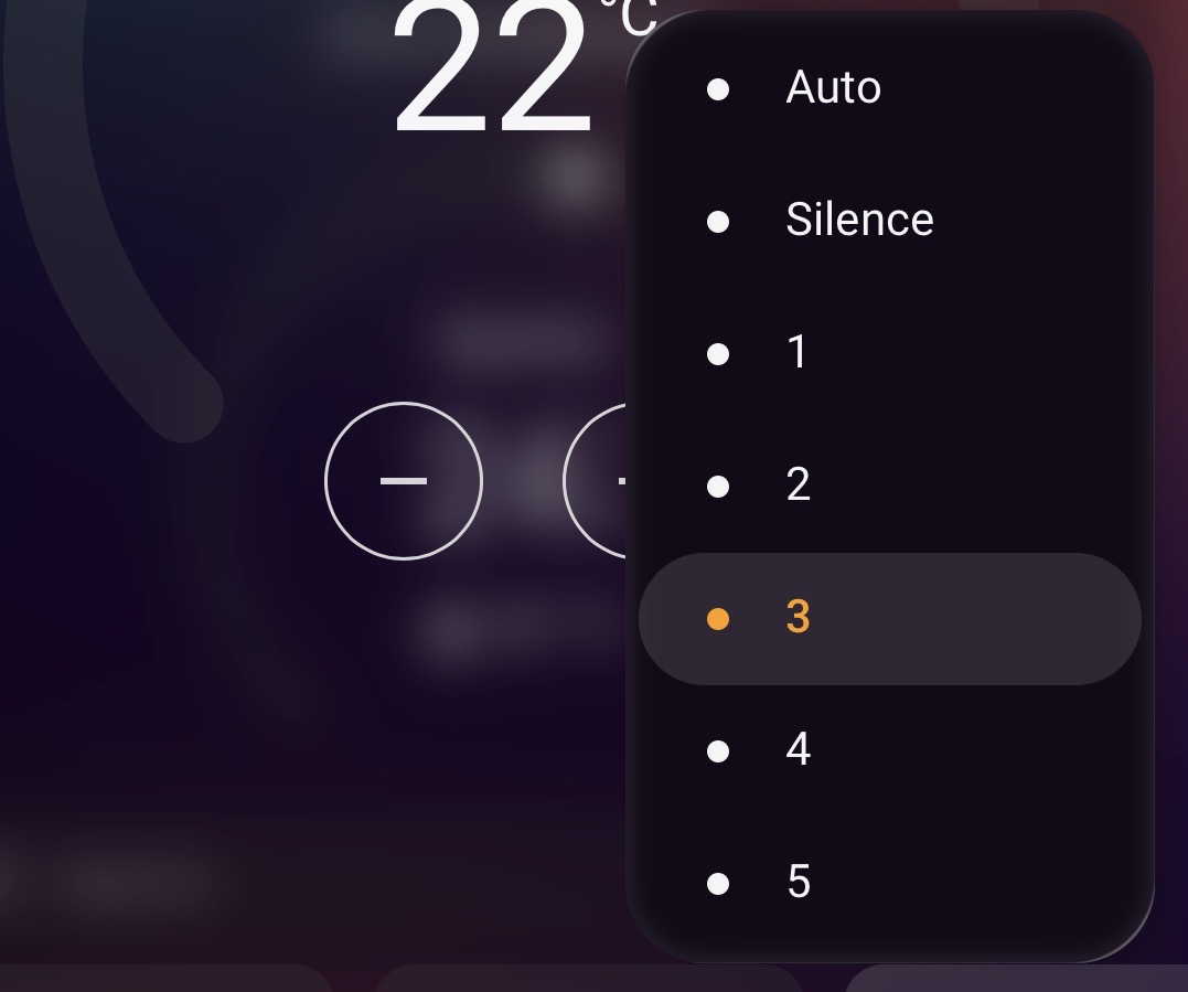

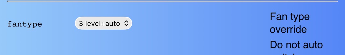

2 questions about this:
I integrated the system with DAIKIN AC integration (without MQTT).
My air conditioner has 3 fan speeds + auto. In the settings I have the option to set ā€œfan speed 3 + AUTOā€ but in HomeAssistant it remains at 5 speeds. (I rebooted the Daikin and restarted HA but nothing)
