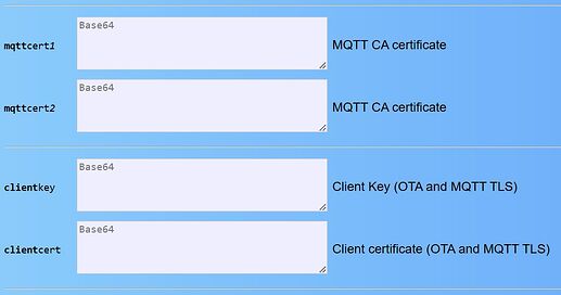

Does this solution support SSL for mqtt with client certificates?
Yes:

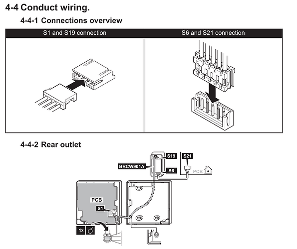

I have two ceiling air conditioner unit with this kind of remote:
(BRC073A1)
On the pdf i saw the S21 port is where it should be connected. Does this mean i need to remove the wired thermostat in order to connect a Faikin board?
Best is to research HERE about compatible models and HERE for discussions.
