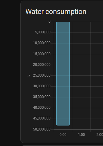

Hello, I have a water flow sensor, and due to a software issue by the developers, its been reporting incorrect (very high) cumulative usage amounts. its been fixed now but when i add it to my energy dashboard, i get a massive correction:
I tried deleting the device, but it is autodiscovered via MQTT, and deleting it didnt seem to clear out the historic data anyway - whats the best way to nuke the history for this one particular sensor (or the whole device, im easy going at this point)
I have a fair few data points that’re quite tedious to set to 0 on the adjustment page (like a month worth as its taken that long to fix)
