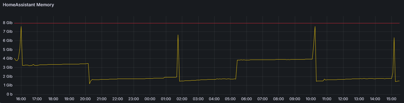

I have an memory issue with my HA installation, which I narrowed down to following log entries:

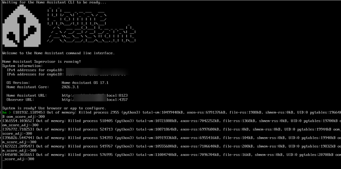

This error is spammed every 1ms until I’m out of memory and HA is automatically restarted:
Unfortunatelly it is not directly reproducable to help exclude specific parts.
I already disabled 90% of the integrations.
