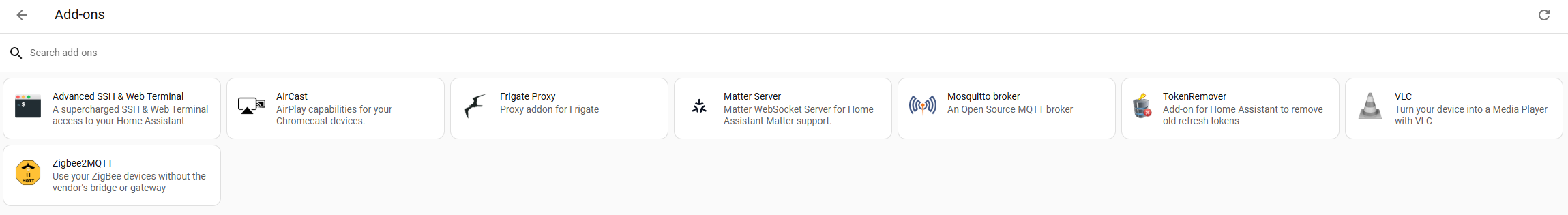

The installation:
HAOS runs in a proxmox VM. It’s running latest available version. 2025.12.2. It’s been running fine for years. Its HDD lives on a NAS. Everything is hardwired via a Cisco 3850 POE switch.

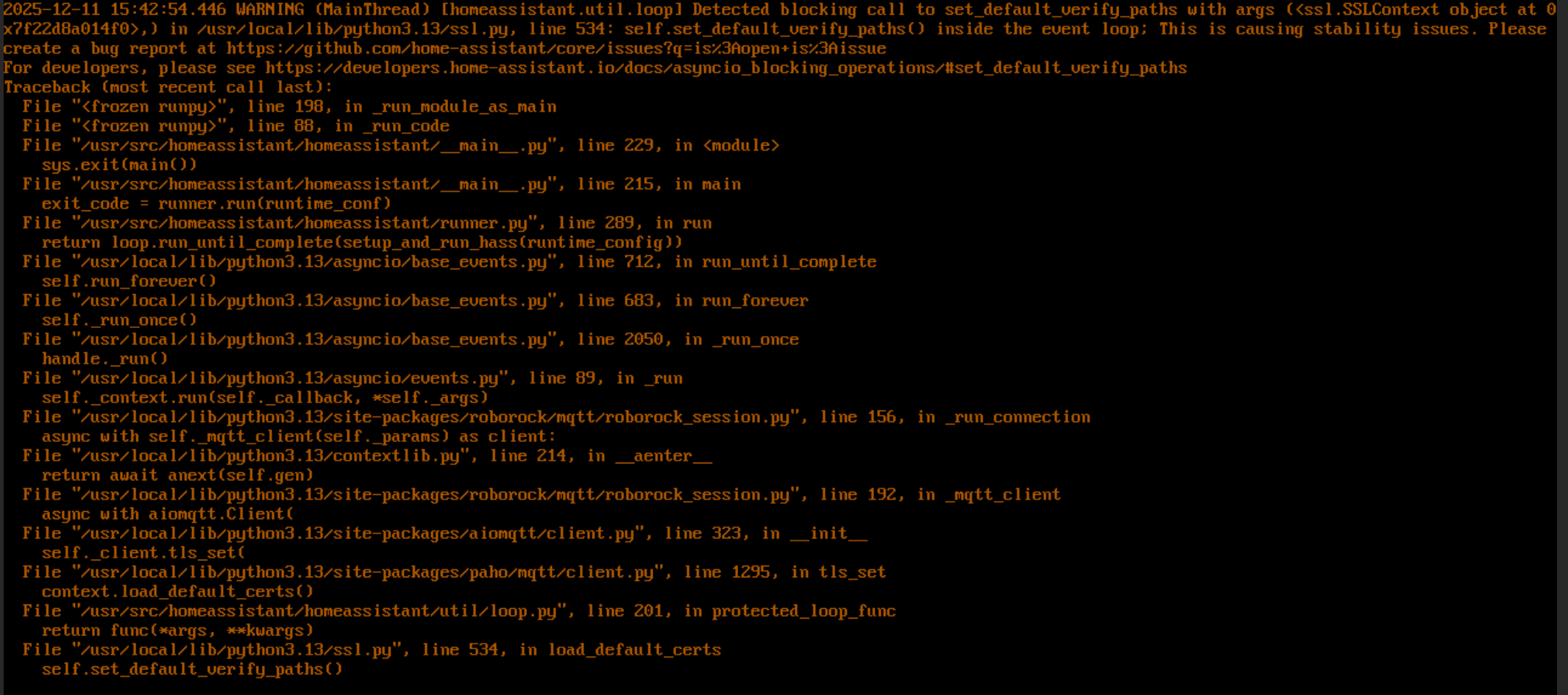

Everything in the logs points straight away to networking issue, since all the network related stuff timeouts/fails to connect. It almost looks like HA’s network interface is being badly throttled however running an iperf test from it to the NAS shows a solid gigabit speed. So I don’t really understand where the problem is and appreciate if someone could point me in the right direction. I’m attaching all the logs I gathered and can attach more if I’m told what’s needed. Really looking forward for help. Thank you very much.

Noticed this in the core logs. Could this cause a problem?
Addons in use
The load certs issue should be reported. But it should not cause a the delay you are experiencing.

I would start by stopping the TokenRemover addon.
Not only is it the most likely culprit, HA made this functionality built in (fixed at 90 days) last February.
Hi @ShadowFist
Thanks for your reply. I sorted this out already. Out of all things it turned out to be the gree AC custom integration - something I never had trouble with. It started duplicating its devices. Instead of original 6 devices I had 36 devices and growing, each time I restarted/rebooted HA. Never seen this before. Issue is reported to the dev.
