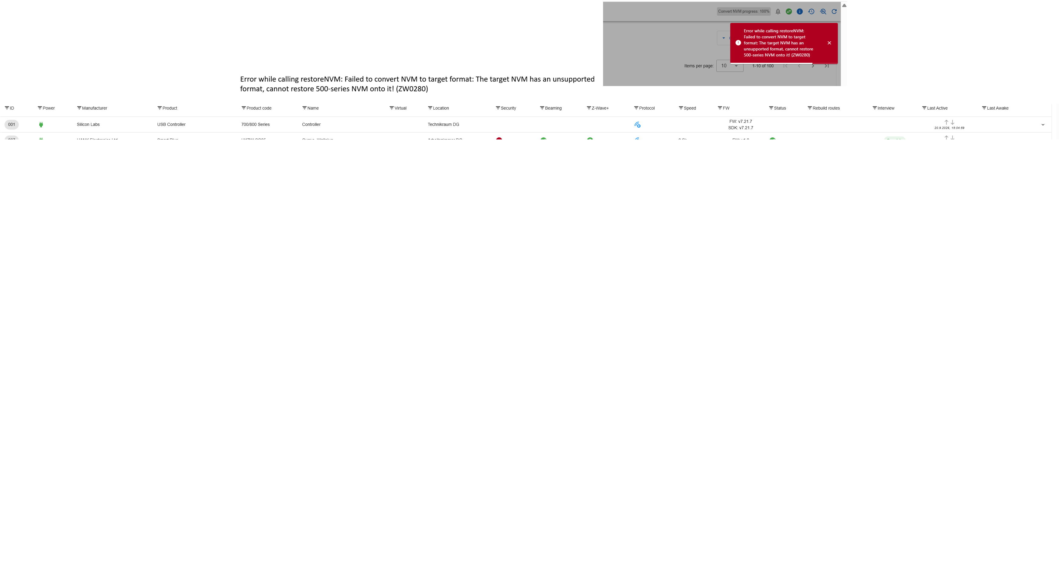

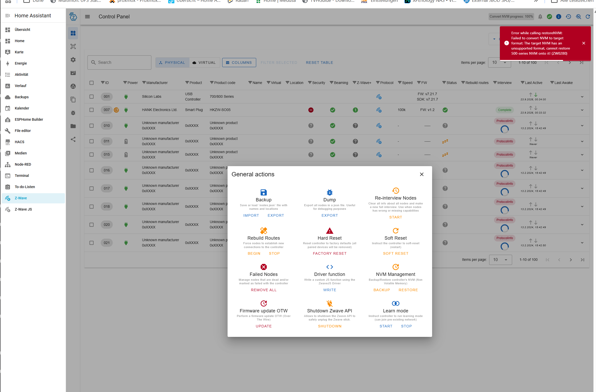

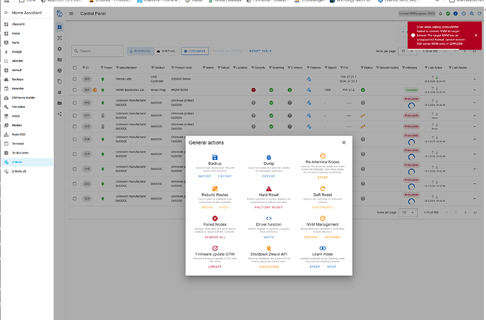

now i wanted to migrate to my latest Aeotec Z-Stick 10 Pro and failed…so i wanted to do the small step to migrate to the Zstick 7 first..
I always get the same error here..

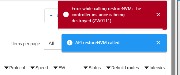

2026-09-20 15:17:59.347 CNTRLR Failed to convert NVM to target format: The target NVM has an unsupported form
at, cannot restore 500-series NVM onto it! (ZW0280)
2026-09-20 15:17:59.348 INFO Z-WAVE: Failed to convert NVM to target format: The target NVM has an unsupported format, cannot restore 500-series NVM onto it! (ZW0280) restoreNVM undefined
it’s the same error for the newest zstick 10 plus…

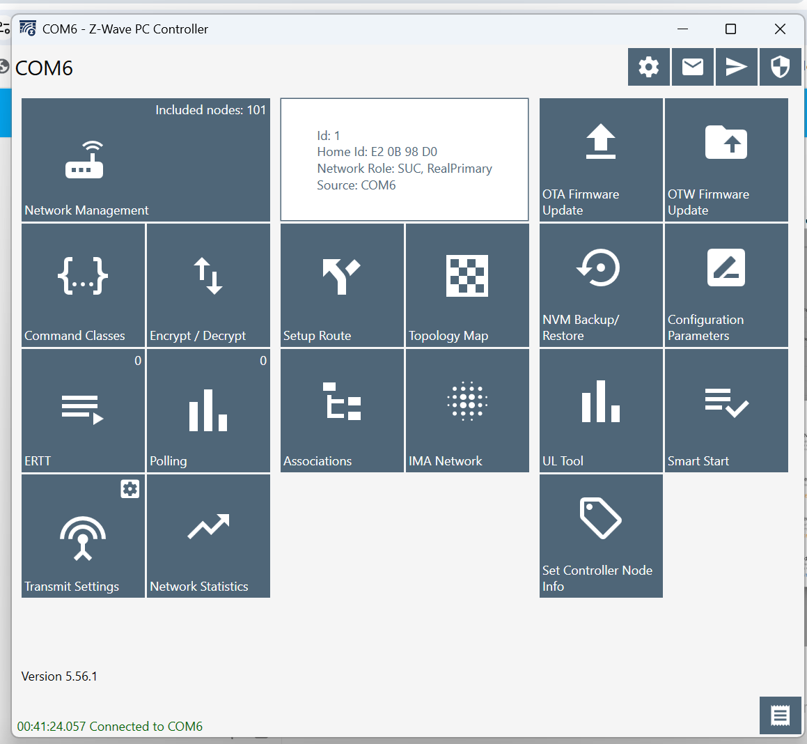

Which SDK does your Gen5 key work with? You need at least 6.61 for the backups to be compatible with the 700 or 800 chips.
hi,
it runs with
FW: v1.2
SDK: v6.81.6

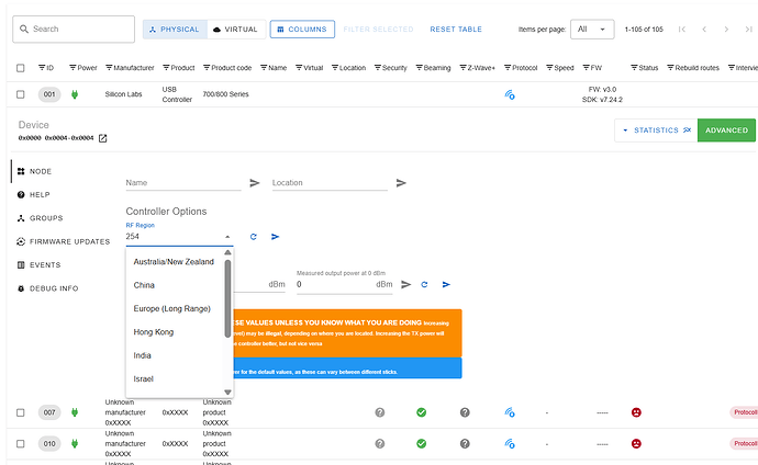

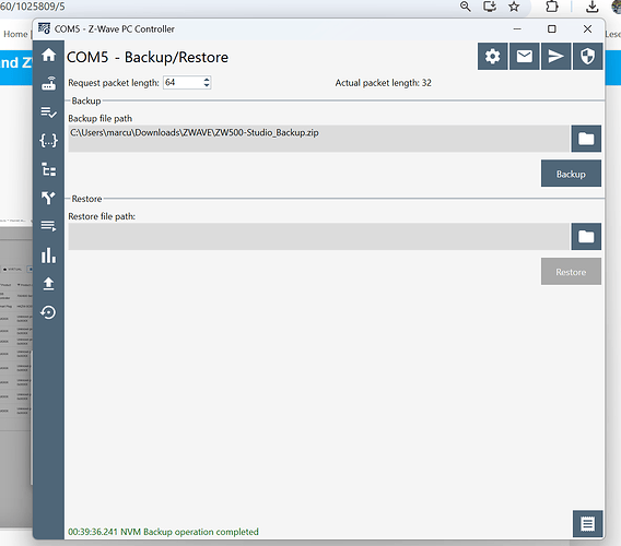

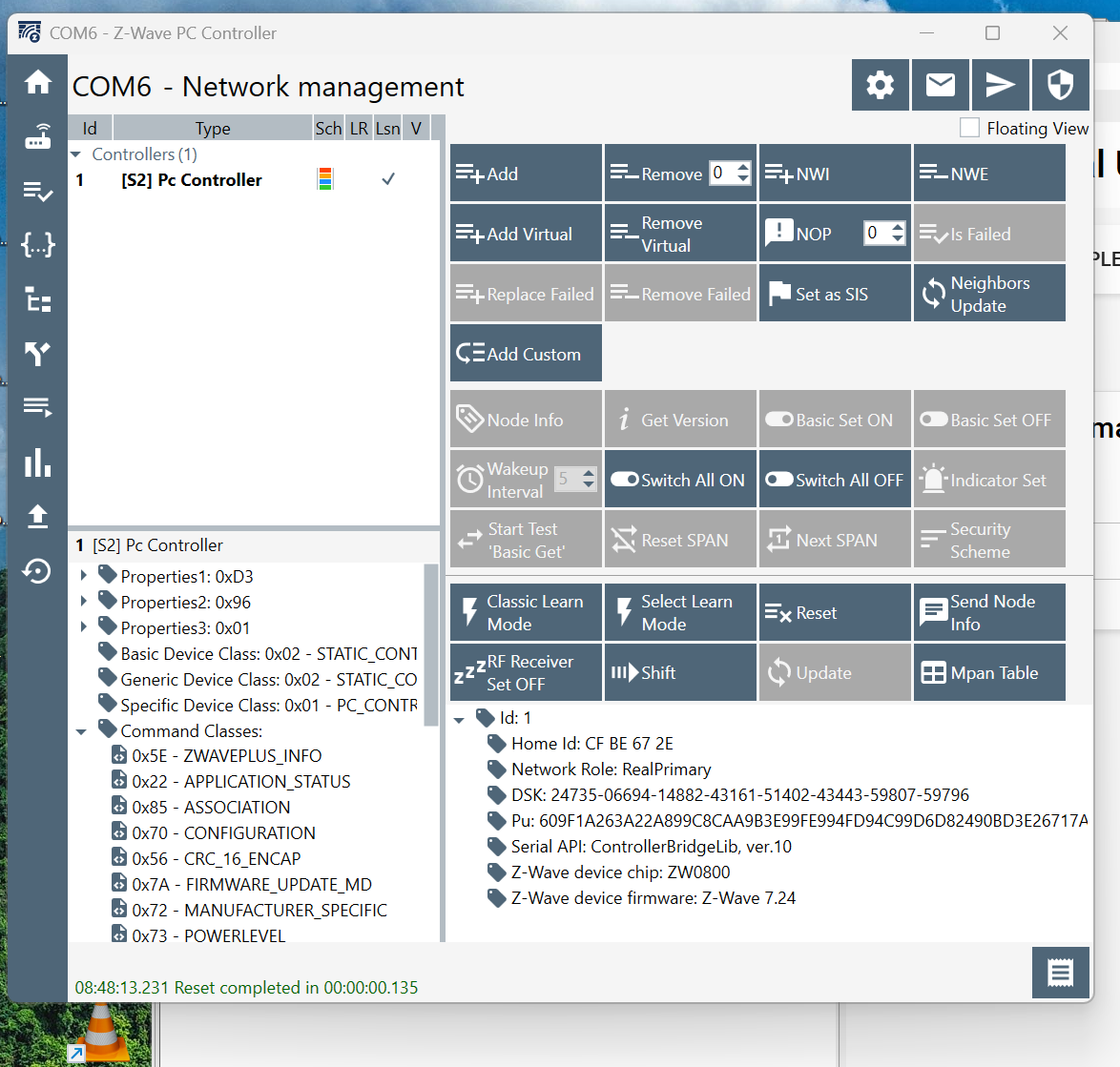

How do you set up the transfer?
Have you tried using Z-Wave JS and Studio 5?
hi,
i’ve tried
ZWAVE-JS
ZWAVE

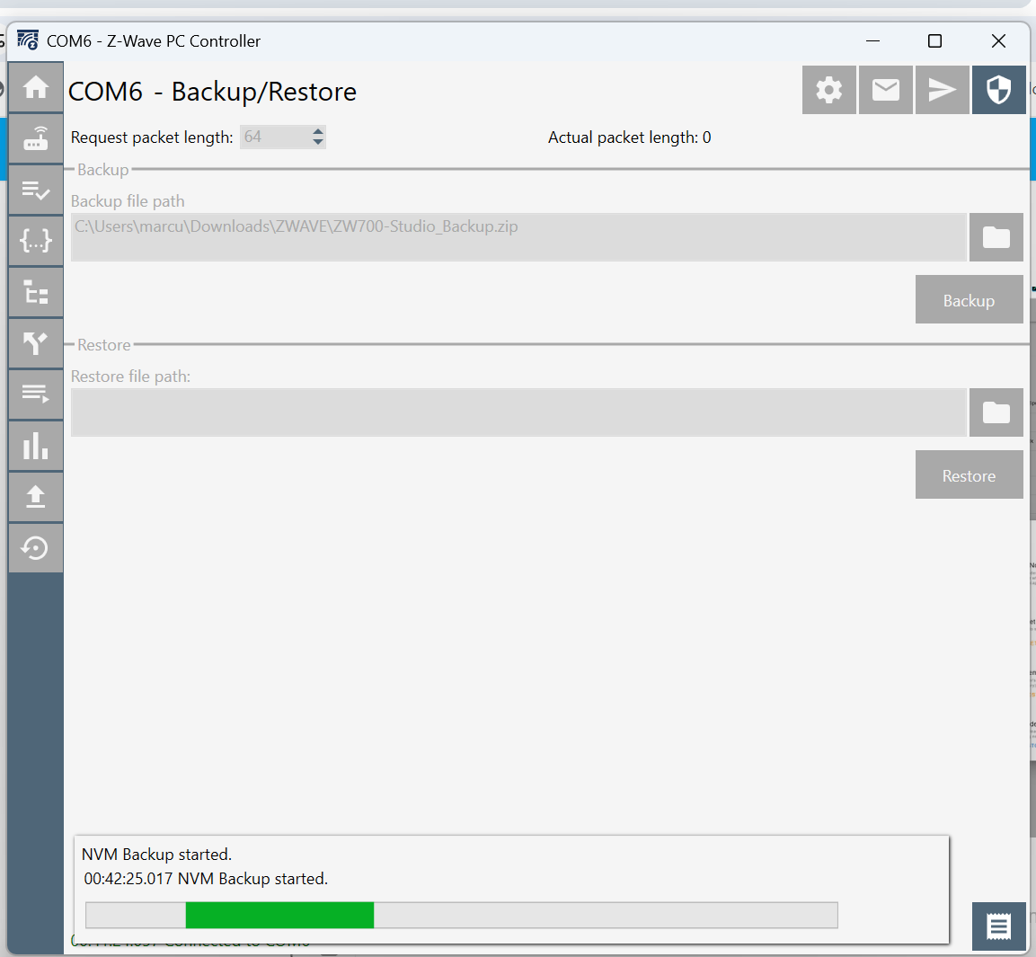

and before Studio 5…

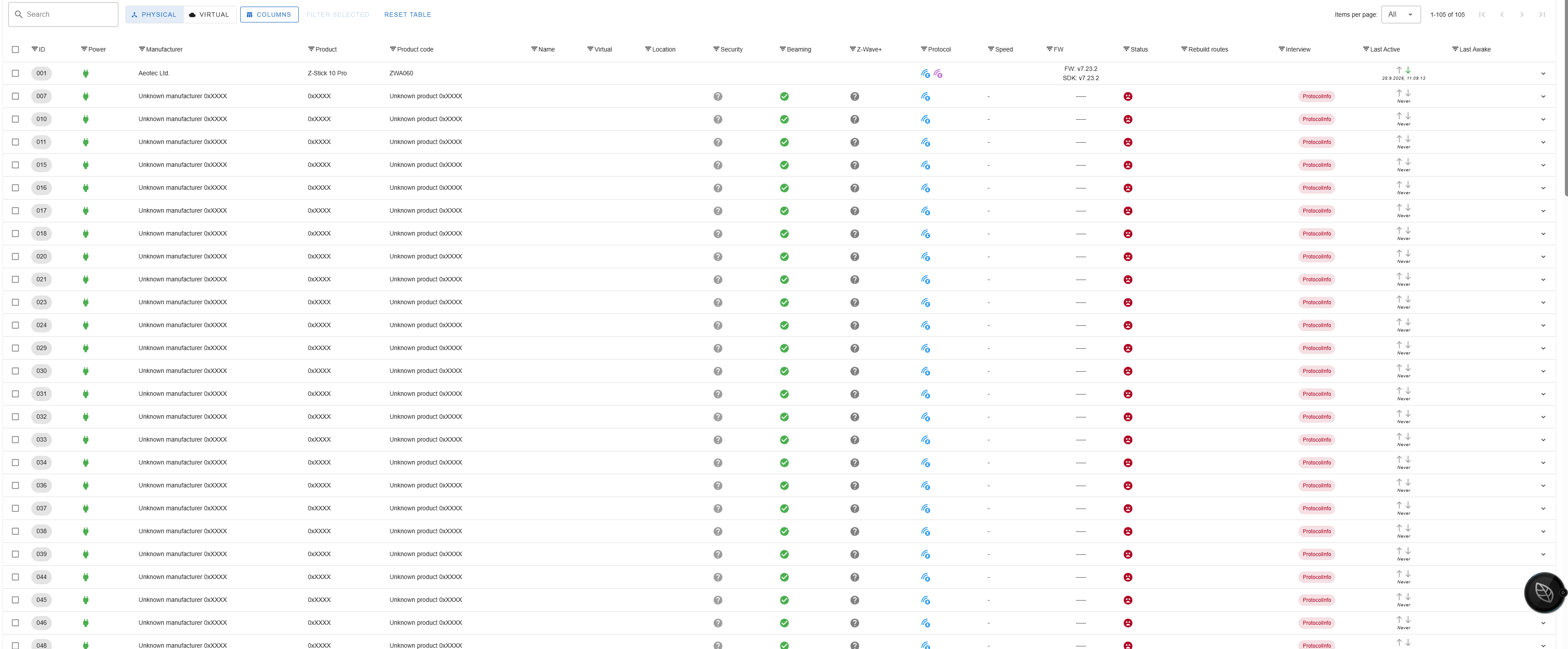

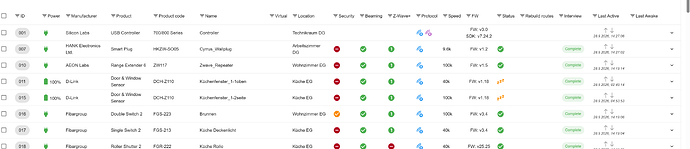

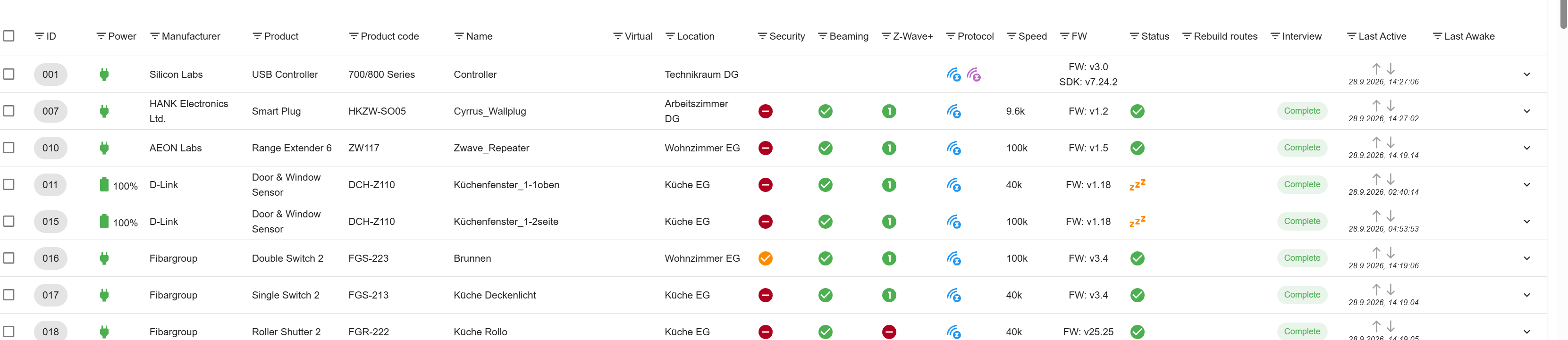

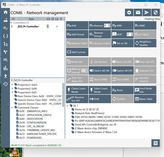

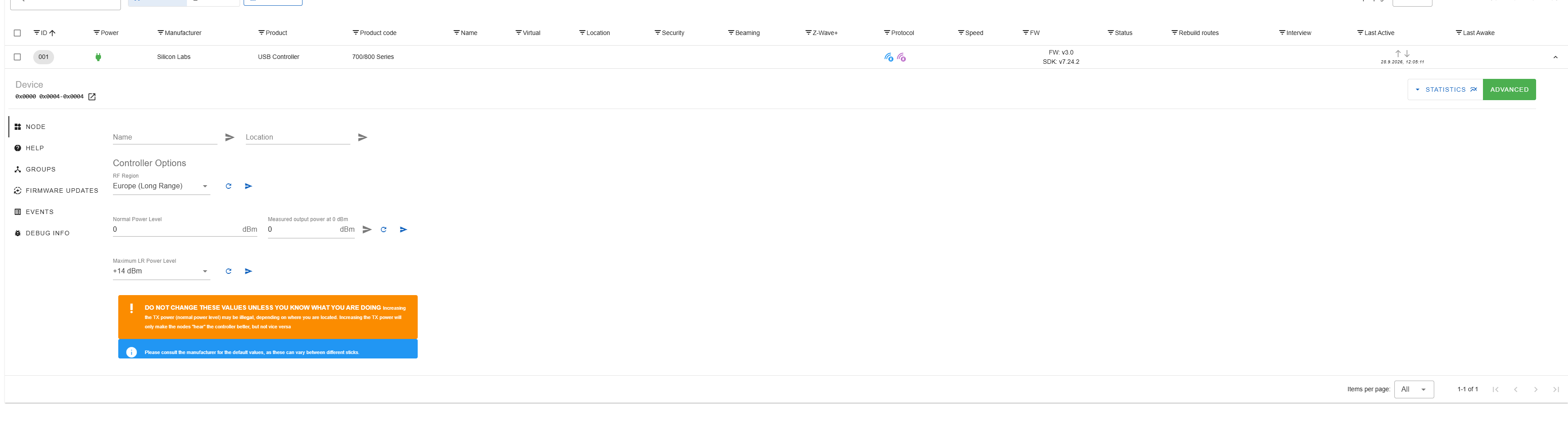

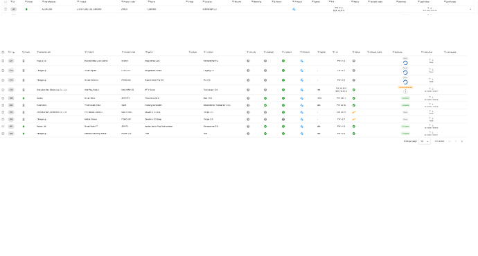

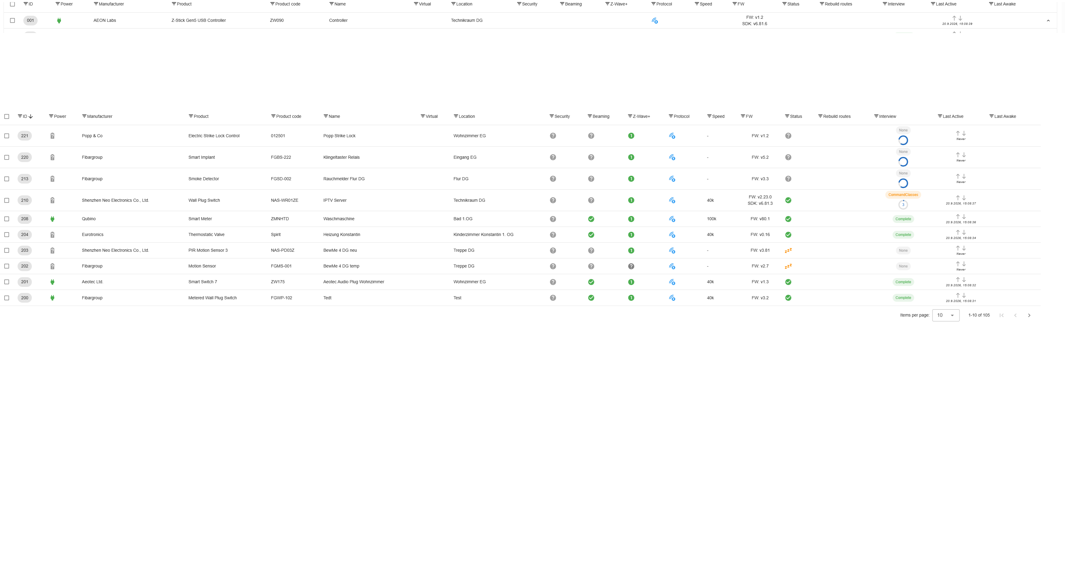

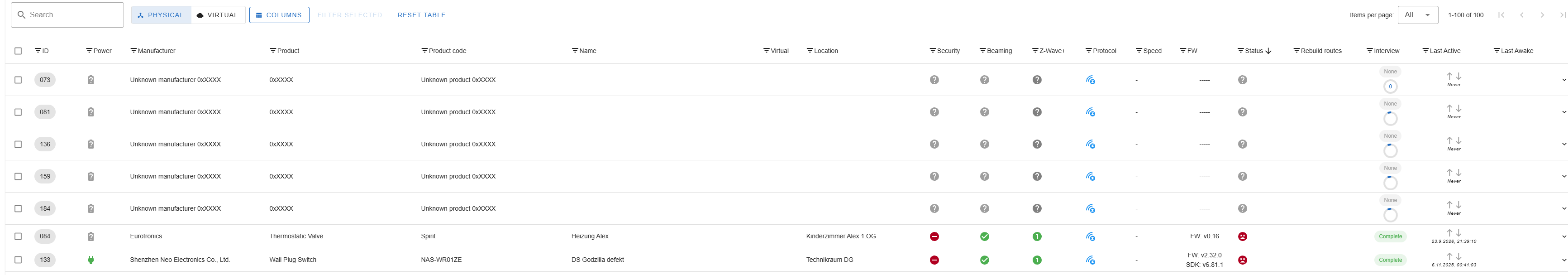

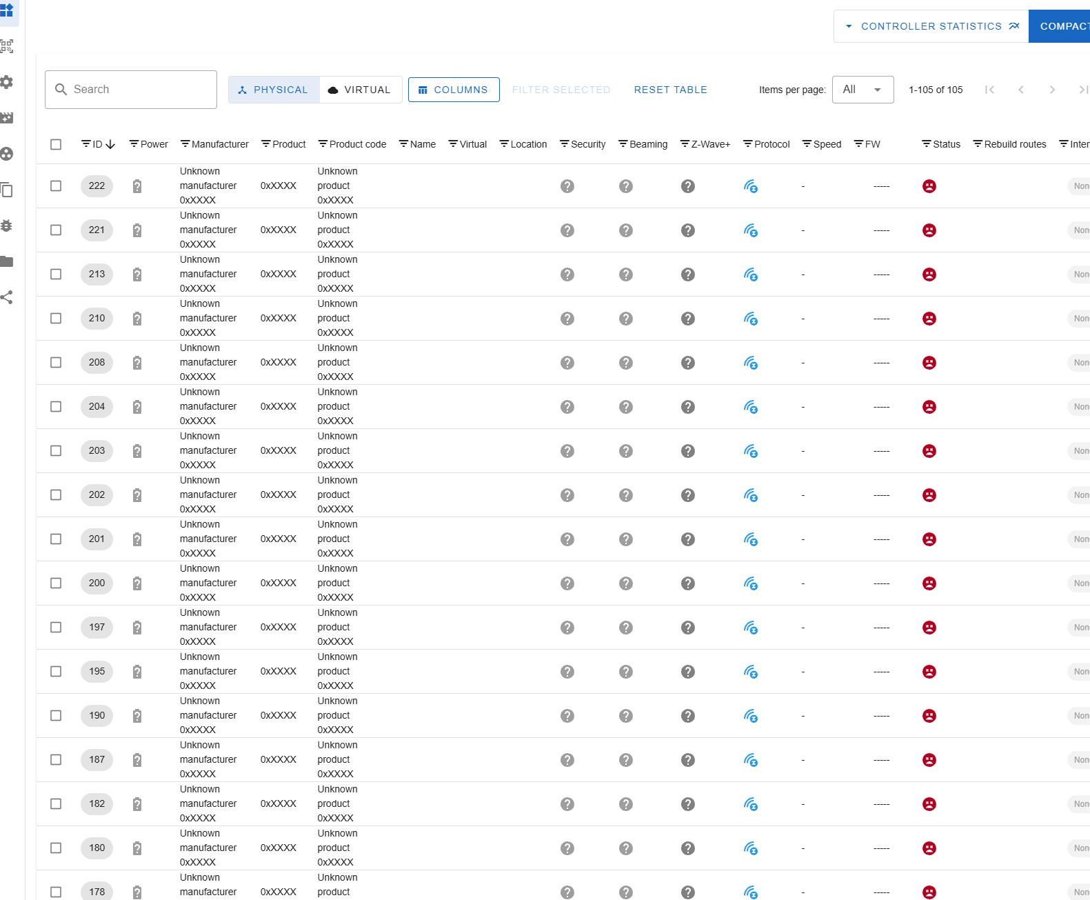

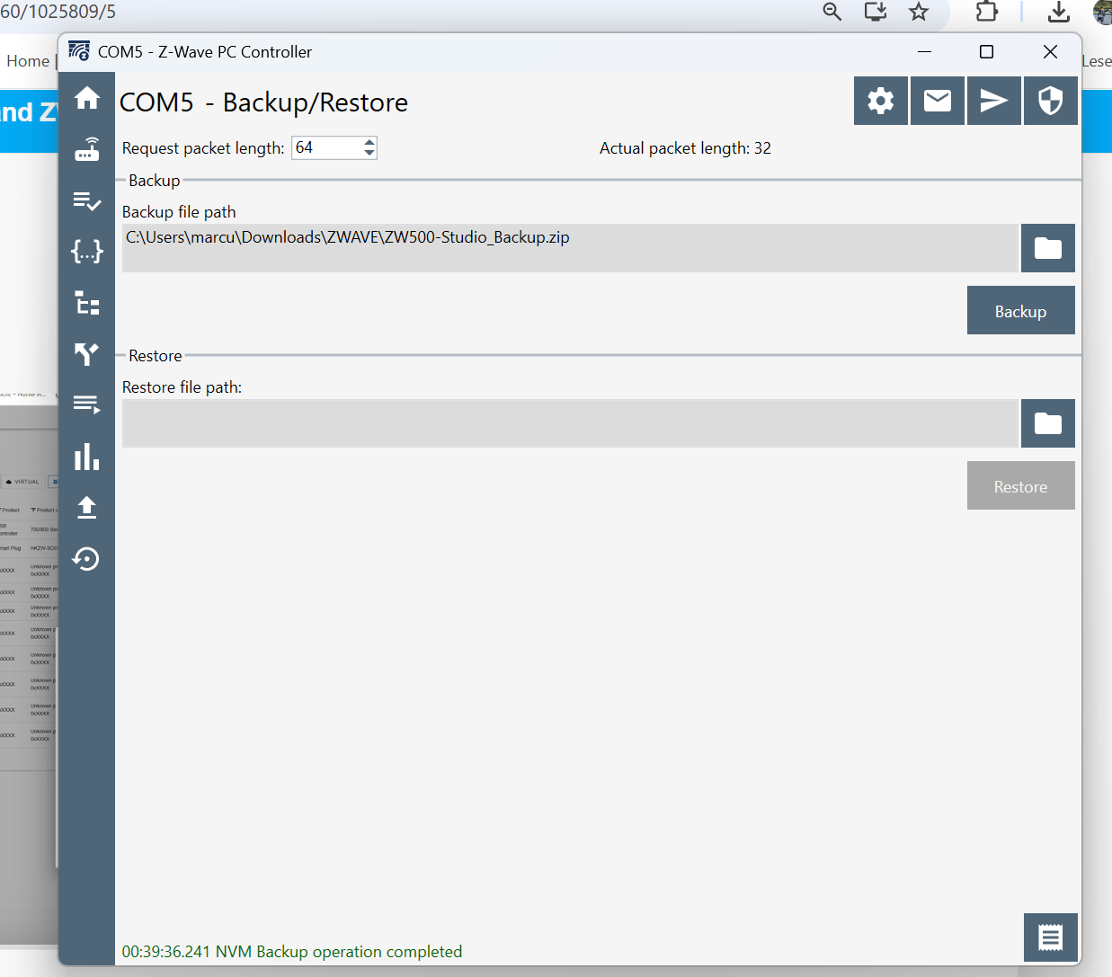

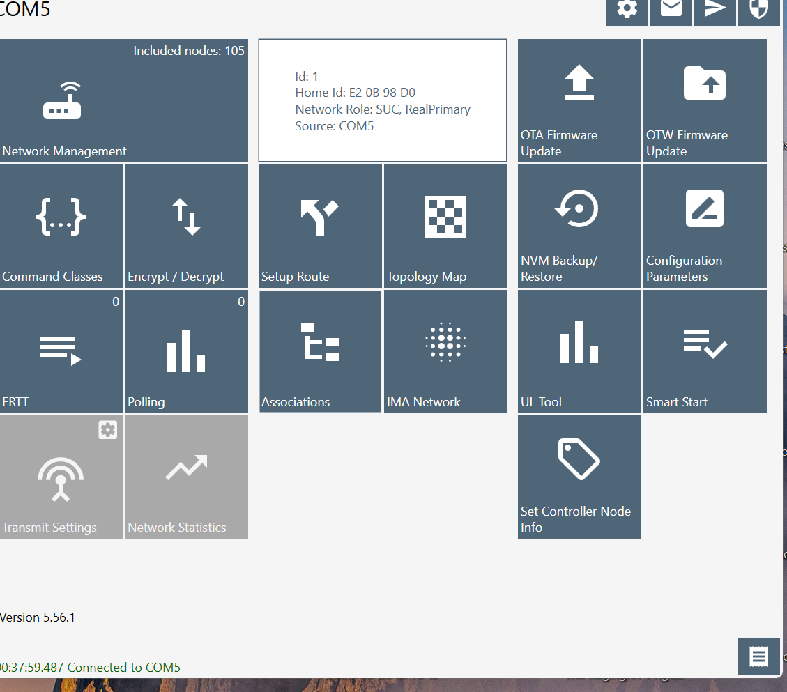

this is my 500 stick in studio 5 … 105 nodes

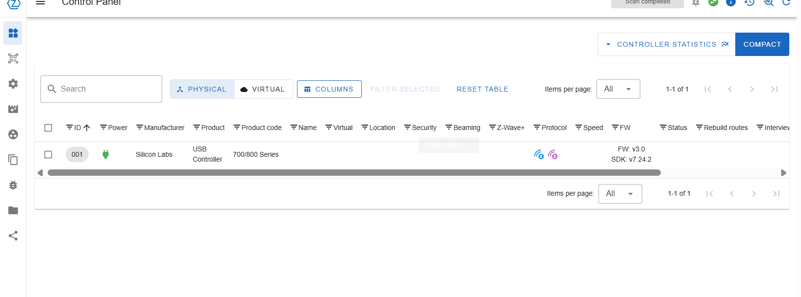

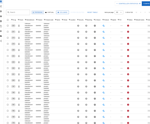

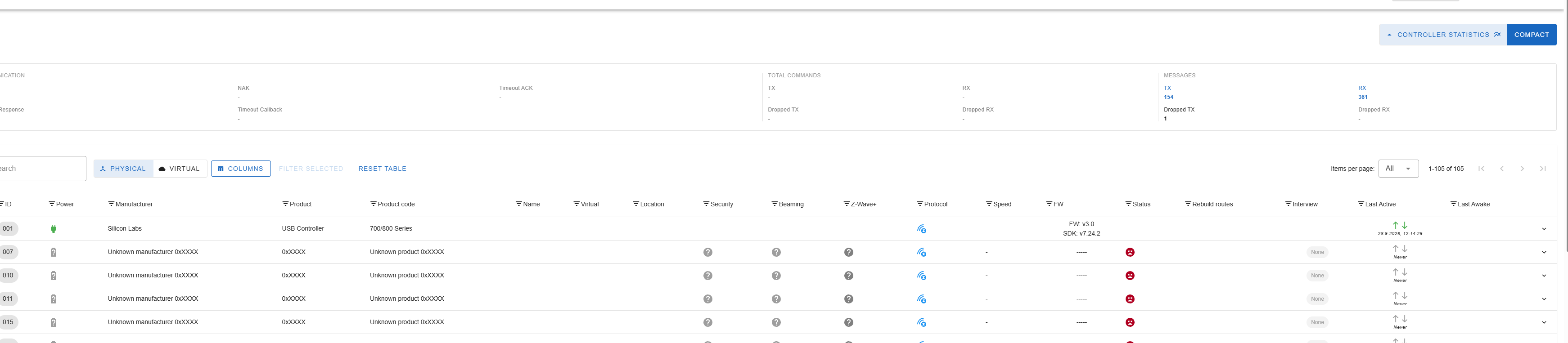

my 800 stick (with old nvram) in studio 5 … 101 nodes
restore with 500 backup
still…101 nodes
And are the 101 nodes working properly?
Do you have any more logs when restoring the backup? Try switching the logs to debug mode in Z-Wave JS UI first.

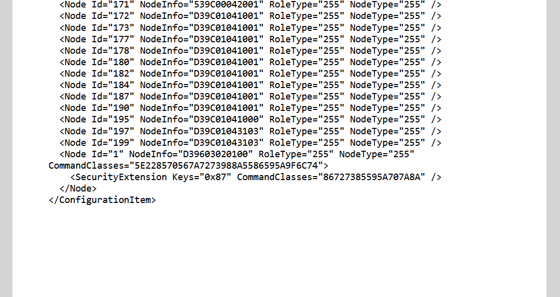

not all, since they are old…and the IDs have changed…

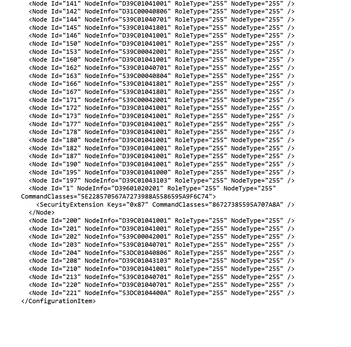

ZW800 001-xxxxxx.xml (from studio backup file)
ZW500 001-xxxxx.xml (from studio backup file)
i can create any log, just tell me what and how…all i want is finally to get the migration working…

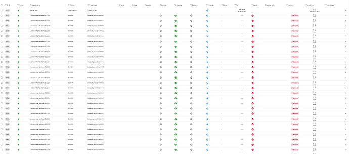

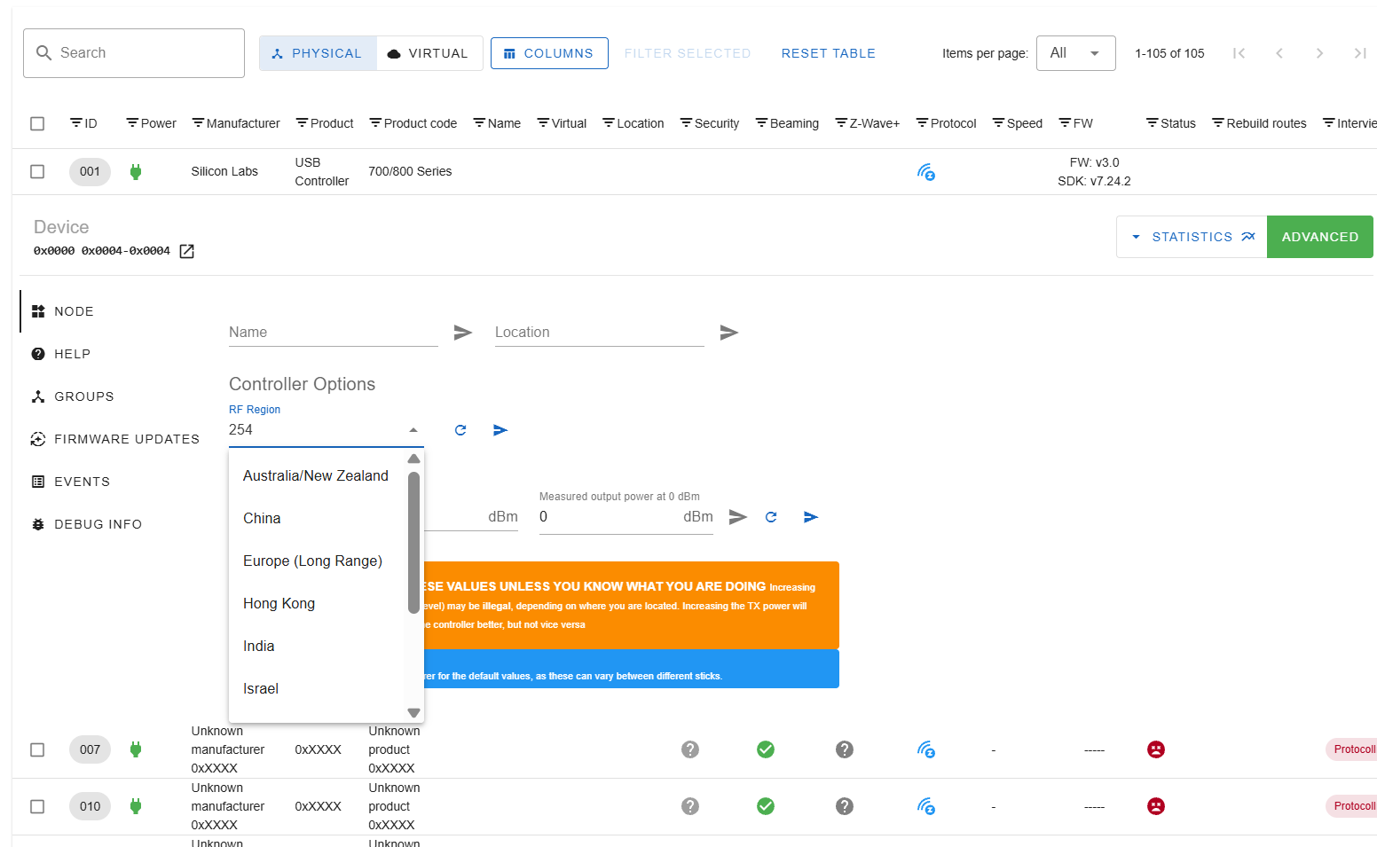

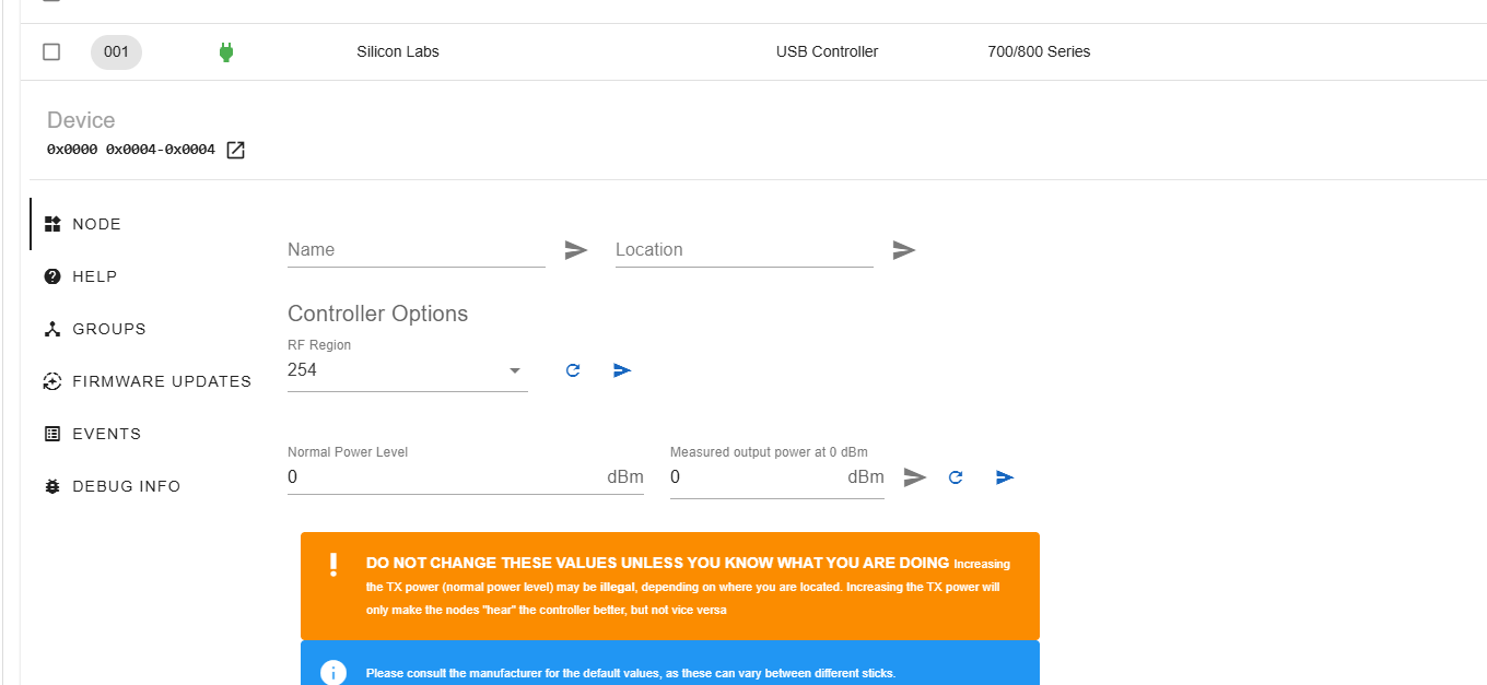

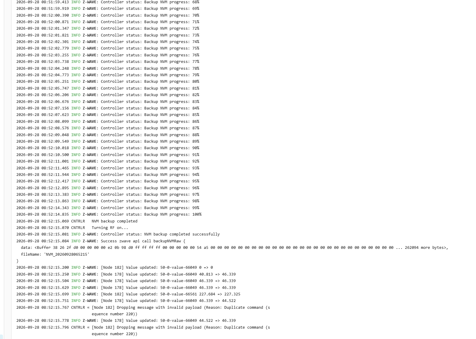

Have you tried creating a new backup on the 500 and restoring it to the 800?
What are you using to manage your network? Z-Wave JS UI? If so, you can find the logs on the corresponding app page.

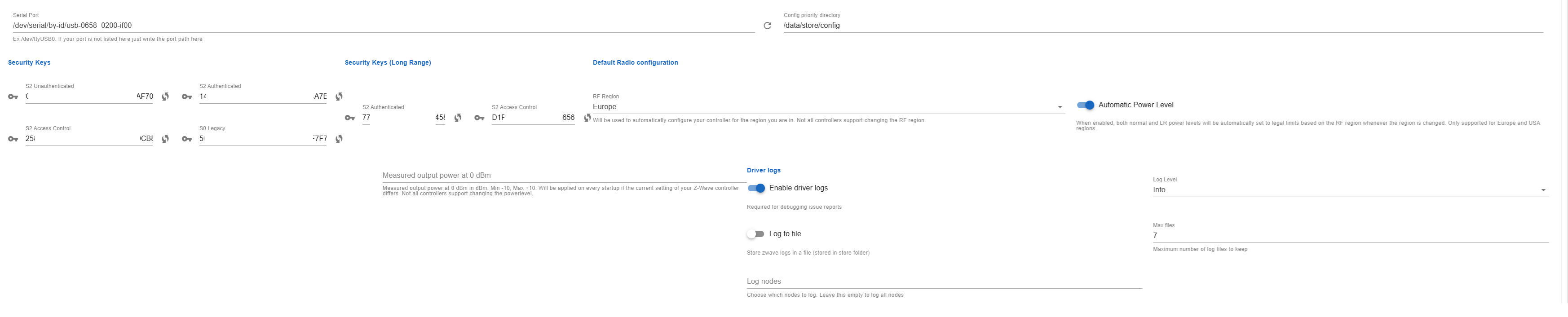

Did you make sure to enter the same security keys?
yes, i do everytime i try a new backup of the zw500 stick…and i also try to install it on the zw800 stick

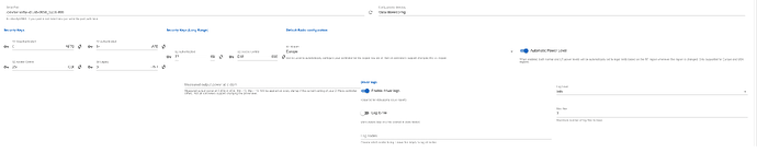

about the security key… i usually do it like this
  • within zwave js ui i use the internal function to backup the nvram
  • unplug the stick
  • plug in the zw700 or zw800 stick
  • change the device path in zwave js ui
  • wait till it has been restarted
  • restore nvme on zw700 or zw800 sitck
the security key i did not change, but i copied it from the zw500 settings
and i guess you mean this ones
this is the log from the backup

now try to restore on zw700 stick
as you can see…not all 101 devices are able to come back, since some moved or were deleted
and this is the log…
2026-09-24 00:33:56.629 CNTRLR Switching to 16-bit node IDs successful
2026-09-24 00:33:56.639 CNTRLR Switching to 16-bit node IDs successful
2026-09-24 00:33:56.643 CNTRLR Converting NVM to target format…
2026-09-24 00:33:56.718 INFO Z-WAVE: Controller status: Convert NVM progress: 0%
2026-09-24 00:33:56.767 INFO Z-WAVE: Controller status: Convert NVM progress: 1%
2026-09-24 00:33:56.880 INFO Z-WAVE: Controller status: Convert NVM progress: 2%
2026-09-24 00:33:57.005 INFO Z-WAVE: Controller status: Convert NVM progress: 3%
2026-09-24 00:33:57.111 INFO Z-WAVE: Controller status: Convert NVM progress: 4%
2026-09-24 00:33:57.239 INFO Z-WAVE: Controller status: Convert NVM progress: 5%
2026-09-24 00:33:57.358 INFO Z-WAVE: Controller status: Convert NVM progress: 6%
2026-09-24 00:33:57.461 INFO Z-WAVE: Controller status: Convert NVM progress: 7%
2026-09-24 00:33:57.574 INFO Z-WAVE: Controller status: Convert NVM progress: 8%
2026-09-24 00:33:57.698 INFO Z-WAVE: Controller status: Convert NVM progress: 9%
2026-09-24 00:33:57.806 INFO Z-WAVE: Controller status: Convert NVM progress: 10%
2026-09-24 00:33:57.918 INFO Z-WAVE: Controller status: Convert NVM progress: 11%
2026-09-24 00:33:58.026 INFO Z-WAVE: Controller status: Convert NVM progress: 12%
2026-09-24 00:33:58.122 INFO Z-WAVE: Controller status: Convert NVM progress: 13%
2026-09-24 00:33:58.238 INFO Z-WAVE: Controller status: Convert NVM progress: 14%
2026-09-24 00:33:58.354 INFO Z-WAVE: Controller status: Convert NVM progress: 15%
2026-09-24 00:33:58.467 INFO Z-WAVE: Controller status: Convert NVM progress: 16%
2026-09-24 00:33:58.569 INFO Z-WAVE: Controller status: Convert NVM progress: 17%
2026-09-24 00:33:58.681 INFO Z-WAVE: Controller status: Convert NVM progress: 18%
2026-09-24 00:33:58.795 INFO Z-WAVE: Controller status: Convert NVM progress: 19%
2026-09-24 00:33:58.894 INFO Z-WAVE: Controller status: Convert NVM progress: 20%
2026-09-24 00:33:59.004 INFO Z-WAVE: Controller status: Convert NVM progress: 21%
2026-09-24 00:33:59.114 INFO Z-WAVE: Controller status: Convert NVM progress: 22%
2026-09-24 00:33:59.212 INFO Z-WAVE: Controller status: Convert NVM progress: 23%
2026-09-24 00:33:59.324 INFO Z-WAVE: Controller status: Convert NVM progress: 24%
2026-09-24 00:33:59.434 INFO Z-WAVE: Controller status: Convert NVM progress: 25%
2026-09-24 00:33:59.528 INFO Z-WAVE: Controller status: Convert NVM progress: 26%
2026-09-24 00:33:59.643 INFO Z-WAVE: Controller status: Convert NVM progress: 27%
2026-09-24 00:33:59.760 INFO Z-WAVE: Controller status: Convert NVM progress: 28%
2026-09-24 00:33:59.864 INFO Z-WAVE: Controller status: Convert NVM progress: 29%

2026-09-24 00:34:19.066 CNTRLR Failed to convert NVM to target format: The target NVM has an unsupported form
2026-09-24 00:34:19.068 INFO Z-WAVE: Failed to convert NVM to target format: The target NVM has an unsupported format, cannot restore 500-series NVM onto it! (ZW0280) restoreNVM undefined

There are some strange entries in the logs during the restore process. The key is trying to call nodes during the restore. That’s not normal. Was it reset properly?
La clef 700 est bien avec le dernier firmware ? =>
Is the 700 key updated with the latest firmware?
i don’t know about the entries during the restore session, however…it seems the process is up to 100%…
what’s the french with the firmware?
the zw800 and zw700 are on the latst firmware from aeotec
You tried to completely reset your key before restoring your backup.
Normally, the key cuts off communication, loads the backup, and then resumes communication. Normally, there is no data exchange during the transfer.
ok…here we try again..
i fac res the zw800 aeotec stick using simplicity studio
doing a fresh backup on the zw500 controller
now, the new stick is online
now try to restore
it seems the backup was succesfull…
however, all nodes are dead now

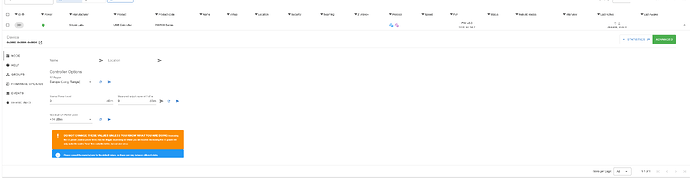

the stick seems to have an issue with the region settings…but manually writing it won’t be persistent
2026-09-28 09:08:45.565 INFO Z-WAVE: Calling api updateControllerNodeProps with args: [ null, [ 'RFRegion', [length]: 1 ], [length]: 2 ]
2026-09-28 09:08:45.575 INFO Z-WAVE: Success zwave api call updateControllerNodeProps undefined
after reload…back to undefined again..
2026-09-28 09:16:24.745 INFO APP: ::ffff:127.0.0.1 GET /health/zwave 301 162 - 2.597 ms
2026-09-28 09:16:45.484 INFO Z-WAVE: Calling api driverFunction with args: [
‘const result = await driver.controller.setRFRegion(0x00);\n’ +
'return "Region auf Europa gesetzt! Ergebnis: " + result;\\n',
[length]: 1
2026-09-28 09:16:45.498 INFO Z-WAVE: Success zwave api call driverFunction ‘Region auf Europa gesetzt! Ergebnis: false’
2026-09-28 09:27:57.357 INFO APP: ::ffff:127.0.0.1 GET /assets/prismeditor.esm-CSdUteMf.js 304 - - 0.917 ms
2026-09-28 09:28:01.021 INFO Z-WAVE: Calling api driverFunction with args: [
‘const result = await driver.controller.setRFRegion(0x0B);\n’ +
'return "Ergebnis für Europe LR: " + result;\\n',
[length]: 1
2026-09-28 09:28:01.034 INFO Z-WAVE: Success zwave api call driverFunction ‘Ergebnis für Europe LR: false’
finallly…

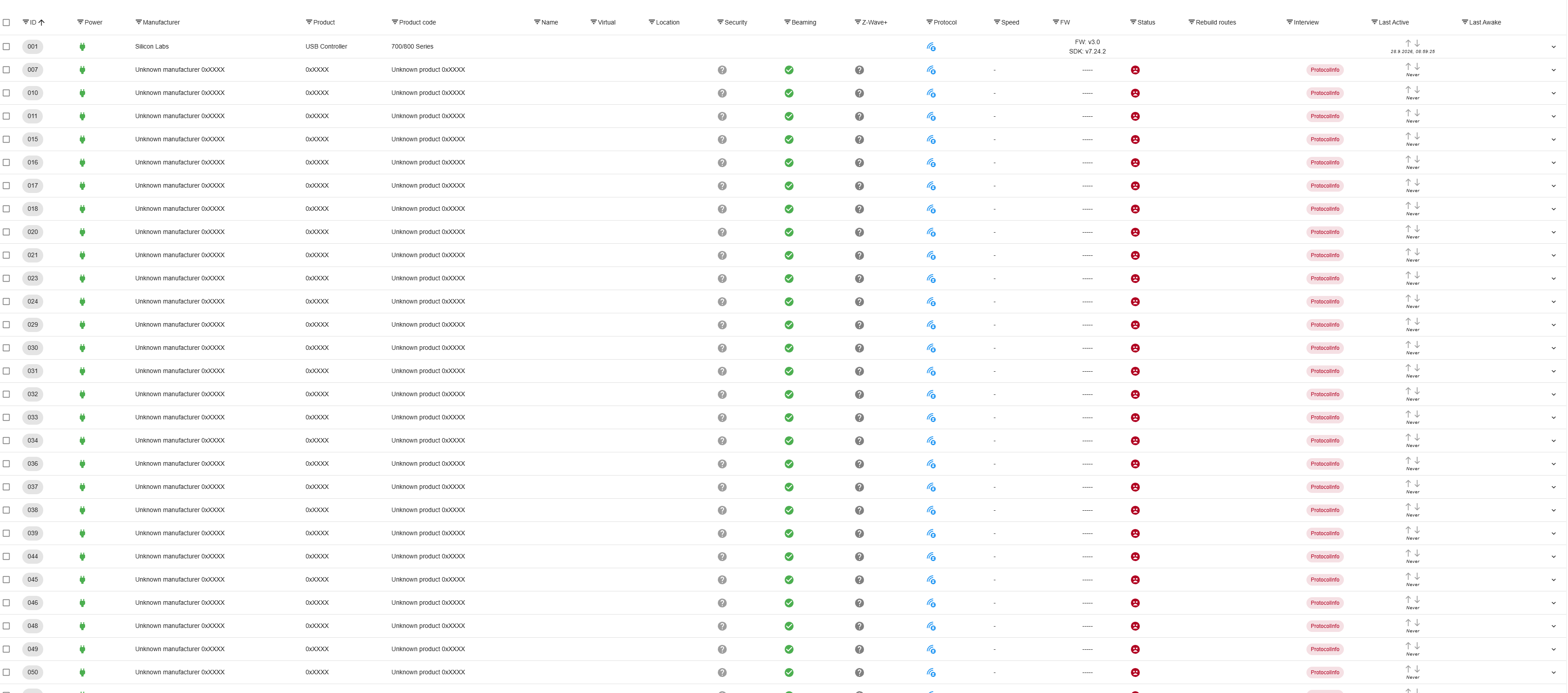

after several fac res and manually setting of the region…i finally have this
but NO device reachable/all dead
First, use only the key 700 to transfer the backup.
Turn off the app Z-Wave JS UI. Then unplug the 500 key and plug the 700 key and start the app again. Stay like that five min, made a bakup of this empty network and see the logs.
It seems that your key is having trouble initializing. Do you get the same message and have the same problem with both keys ?
ok…i did a hard reser on the stick
now do the restore after i shutted zwave js ui (and started it again)

2026-09-28 12:08:03.175 CNTRLR The powerlevel is 0 dBm (0 dBm calibration)
2026-09-28 12:08:03.178 CNTRLR Querying configured max. Long Range powerlevel…
2026-09-28 12:08:03.186 CNTRLR The max. LR powerlevel is 0.0 dBm
2026-09-28 12:08:03.187 CNTRLR Current RF region (Unknown) differs from desired region (Europe (Long Range)),
                              configuring it...
2026-09-28 12:08:03.196 CNTRLR Changing the RF region failed!

now drink coffee…and wait
UPDATE…
already have dead devices…
2026-09-28 12:08:23.762 CNTRLR » [Node 221] querying protocol info...
2026-09-28 12:08:23.783 CNTRLR « [Node 221] received response for protocol info:
                             basic device class:    Static Controller
                             generic device class:  Remote Controller
                             specific device class: Unused
                             node type:             Controller
                             is always listening:   true
                             is frequent listening: false
                             can route messages:    true
                             supports security:     false
                             supports beaming:      true
                             maximum data rate:     100000 kbps
                             protocol version:      3
2026-09-28 12:08:23.784 INFO Z-WAVE: [Node 221] Interview stage PROTOCOLINFO completed
2026-09-28 12:08:23.784 CNTRLR [Node 221] Interview stage completed: ProtocolInfo
2026-09-28 12:08:23.784 CNTRLR » [Node 221] pinging the node…
2026-09-28 12:08:23.961 CNTRLR [Node 221] The node did not respond after 1 attempts, it is presumed dead
2026-09-28 12:08:23.962 CNTRLR [Node 221] The node is dead.
2026-09-28 12:08:23.964 INFO Z-WAVE: [Node 221] Is dead
2026-09-28 12:08:23.965 CNTRLR [Node 221] ping failed: The node did not acknowledge the command (ZW0204)
2026-09-28 12:08:23.966 CNTRLR [Node 221] Interview attempt (1/5) failed, node is dead.
2026-09-28 12:08:23.966 ERROR Z-WAVE: [Node 221] Interview FAILED: The node is dead
2026-09-28 12:08:23.967 CNTRLR [Node 222] Beginning interview - last completed stage: None
2026-09-28 12:08:23.967 CNTRLR [Node 222] new node, doing a full interview…
2026-09-28 12:08:23.967 INFO Z-WAVE: [Node 222] Interview started
2026-09-28 12:08:23.968 CNTRLR » [Node 222] querying protocol info…
2026-09-28 12:08:23.982 CNTRLR « [Node 222] received response for protocol info:
                             protocol version:      3
2026-09-28 12:08:23.985 INFO Z-WAVE: [Node 222] Interview stage PROTOCOLINFO completed
2026-09-28 12:08:23.985 CNTRLR [Node 222] Interview stage completed: ProtocolInfo
2026-09-28 12:08:23.985 CNTRLR » [Node 222] pinging the node…
2026-09-28 12:08:24.115 CNTRLR [Node 222] The node did not respond after 1 attempts, it is presumed dead
2026-09-28 12:08:24.118 CNTRLR [Node 222] The node is dead.
2026-09-28 12:08:24.118 CNTRLR All nodes are ready to be used
2026-09-28 12:08:24.122 INFO Z-WAVE: Controller status: Scan completed
2026-09-28 12:08:24.125 INFO Z-WAVE: Network scan complete. Found: 106 nodes
2026-09-28 12:08:24.125 INFO Z-WAVE: Starting bulk firmware update check for all nodes
2026-09-28 12:08:24.129 INFO Z-WAVE: [Node 222] Is dead
2026-09-28 12:08:24.142 CNTRLR [Node 222] ping failed: The node did not acknowledge the command (ZW0204)
2026-09-28 12:08:24.143 CNTRLR [Node 222] Interview attempt (1/5) failed, node is dead.
2026-09-28 12:08:24.144 ERROR Z-WAVE: [Node 222] Interview FAILED: The node is dead
UPDATE 2
no data in the air…and nothing in the logs

@Idaho947
THANK YOU!!! YOU MADE MY DAY…
as per your suggestion i did backup my ZW700 (zstick 7) + ZW800 (zstick 10 pro) and did a factory reset…
also i downgraded the ZW800 from 7.24 to 7.23
afterwards i did fac res both devices and installed into the ZW700 the ZW500 backup…
the stick then suddenly discovered all devices…so i did an NVM Backup of the ZW700 ones.
This new backup then i installed into the ZW800 one and it immediately became working.
So it seems that
  • ZW800 FW 7.24 is buggy while upgarding (regarding the RF Region ERROR 254)
  • the direct upgrade from 500 > 800 my not be supported, since i had the issues with the RF before…
the failed devices are ok…one is broken and the other one not in use anymore..
now backup and update to 7.24
and working ^^
THANK YOU AGAIN!!!
