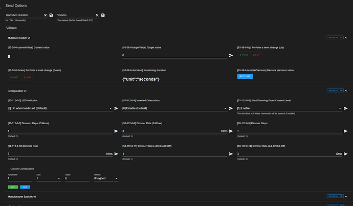

The “configuration” options within the Z-Wave device details are pretty limited:
The Z-Wave JS UI interface is a little bit more promising, but I’m not really sure what’s what here:

Some of the older Jasco dimmers have an undocumented config option to change the dimmer into an on-off switch. This works on a 14294:
Parameter 16, set to 1 to convert to on/off switch
This only affects the physical control, the switch will still dim with Z-Wave controls. There is no perceptible ramping at least.

You can set it value back to 0 if you think it had some effect.
I tried that before I posted above and it wouldn’t let me. It only gave me positive integers as an option, nothing with a zero. I even tried to manually type a “0” but it also wouldn’t let me. shrugs
