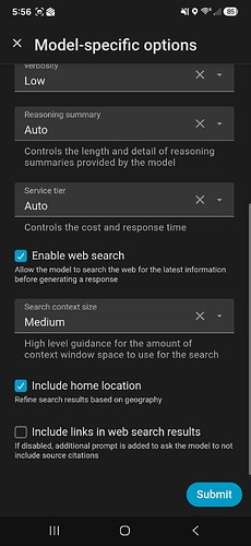

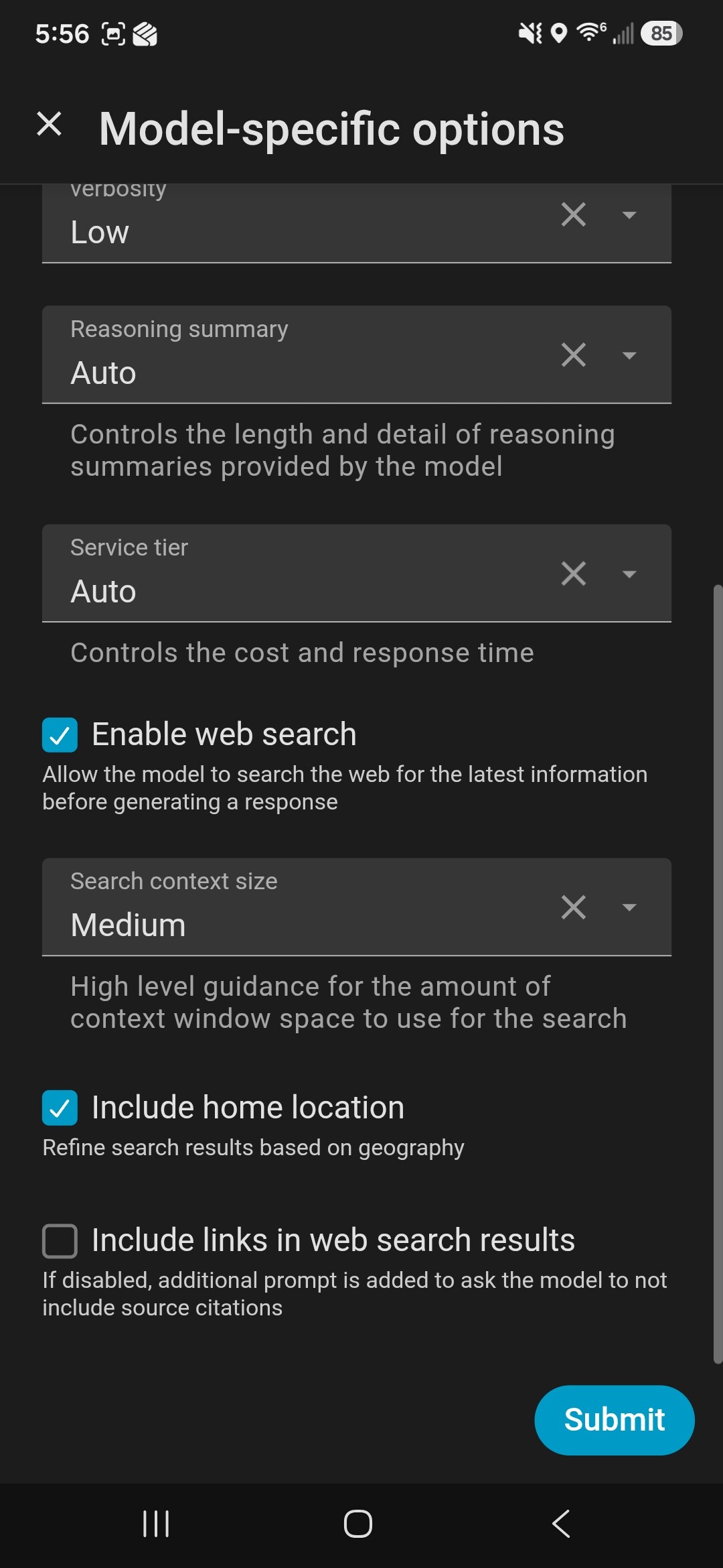

The stock OAI does indeed support it..
In the OAI conversation integration, the web search options only show up on screen 3 of the config, IF you choose a model that supports it.
In my case 5.6 luna. Gets..
On the bottom of the screen after step three in the next, next, next finish…
