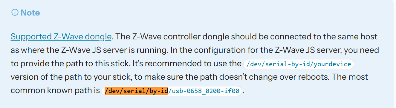

The Z-wave page also contains an identical warning:
A device path like /dev/ttyUSB0 is subject to change. Essentially your usb devices will be fighting to grab the first path available after a restart or update. In your case, you seem to have been lucky that they landed back in their original slots when you put the NUC back together.
Using /dev/serial/by-id mitigates this issue, because it searches for the device address instead of its path. I suggest you use that to avoid future headaches.
