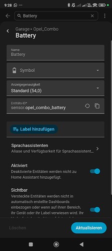

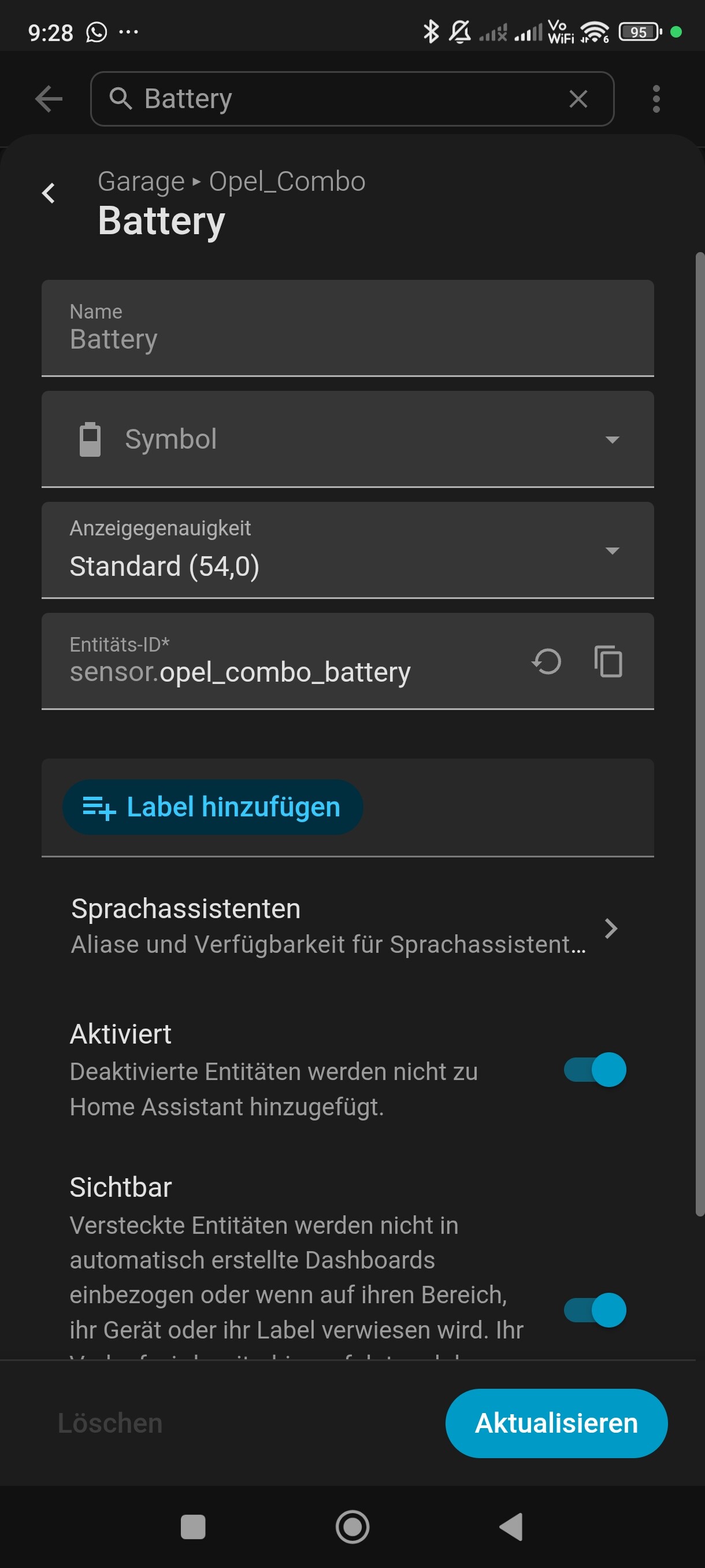

My sensor seems to read unknown, although when I check it gives me a value

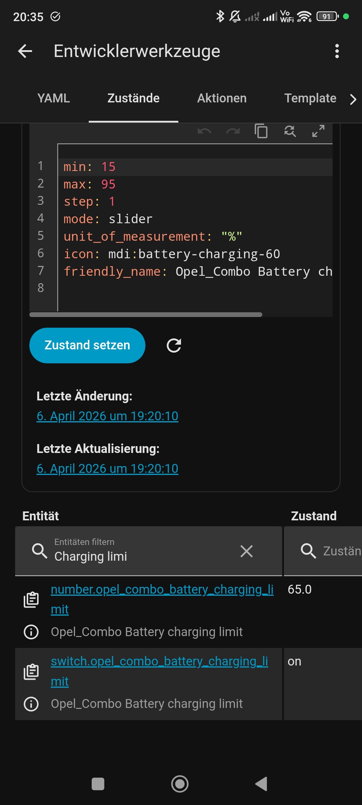

What does it say for the value in the developers tools->states table (not the entity details as you show)?

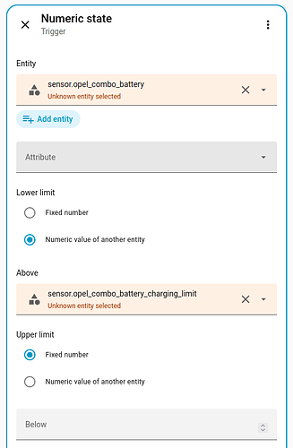

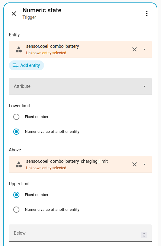

Instead of a Template Trigger, I suggest you use a Numeric State Trigger.
In the Automation editor’s Visual mode, the Numeric State Trigger would look like this.
Ignore the “Unknown entity selected” message. That’s because your sensors don’t exist on my system.
The same trigger in the Editor’s YAML mode looks like this (short and simple).

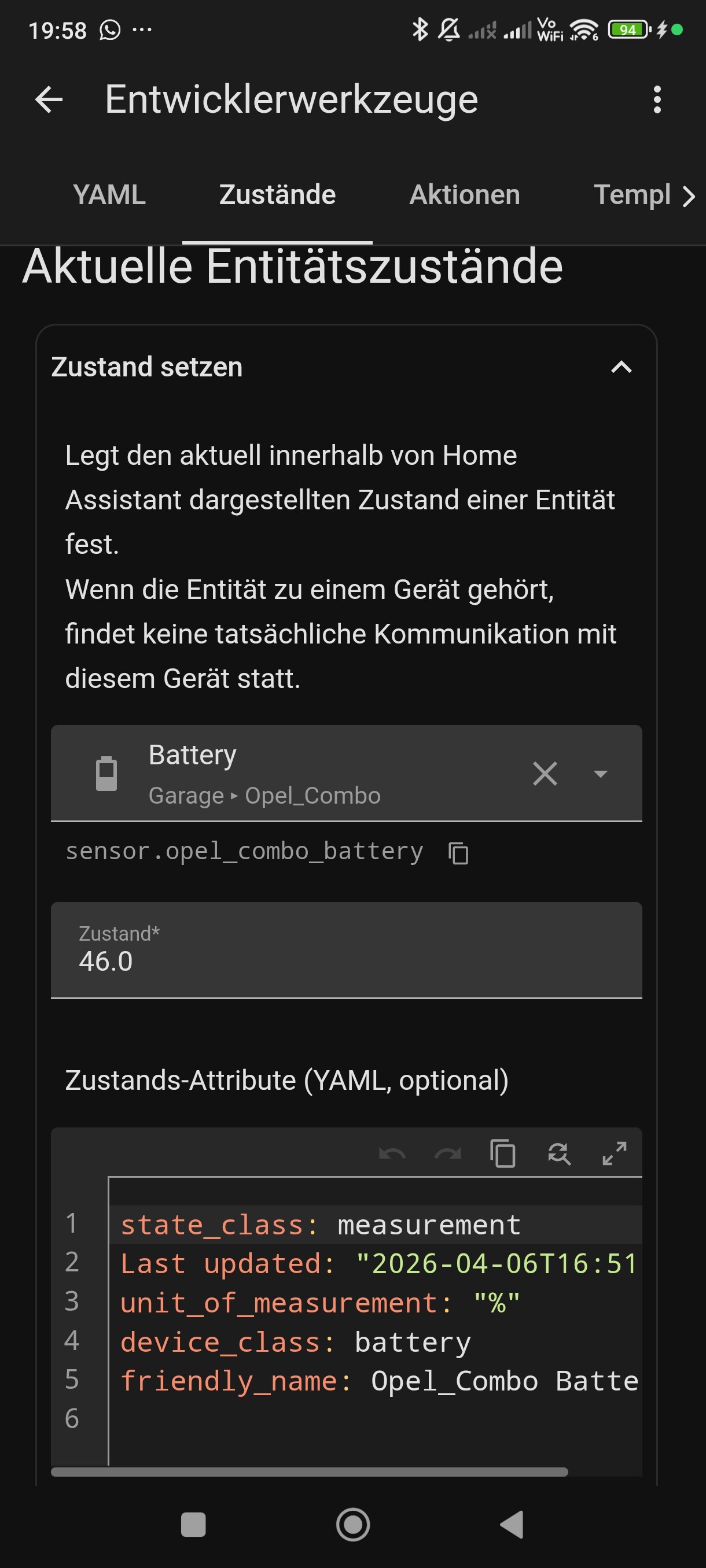

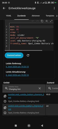

The developer tools- states gives me the following output,
so it should be 46 or whatever percentage is there. The sensor also has been available all the time in the timeline.

I just found the solution, the hint with the states developer tool helped.
The problem was the charging limit sensor, as that had two states (on, 80). number.opel(…)limit gave me the correct result instead of sensor.opel(…)limit.
Technically, sensor never existed, the entities were always called number.opel_combo_battery_limit and switch.opel_combo_battery_charging_limit
Thank you guys very much!
@123 @finity @Blacky
For completeness sake, my new template and the output of the states tool for the battery charging limit sensor:
{{ states(‘sensor.opel_combo_battery’) | int >= states(‘number.opel_combo_battery_charging_limit’) | int }}
