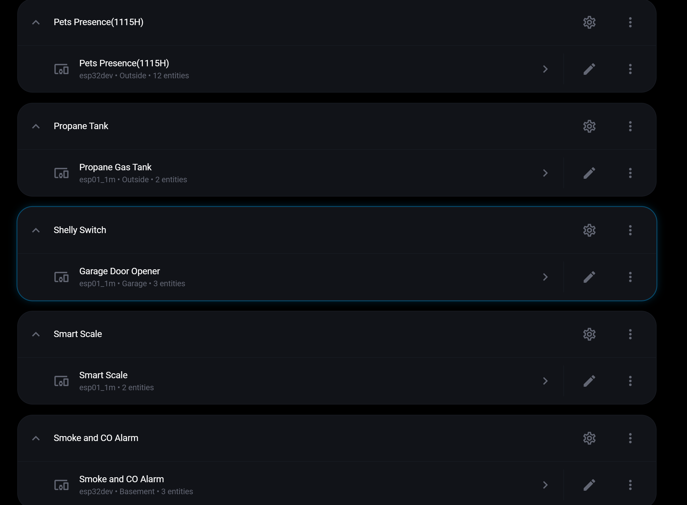

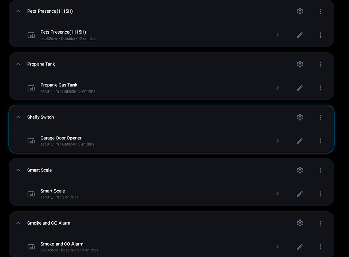

Hello smart community. I flashed Shelly1 with esphome and use for Garage Door Opener. Yesterday I accidentally delete this device from ESP Home UI page, but I can see and operate this device in Home Assistant normally. How can I re-add this device to ESPHome ? Thank you in advanced

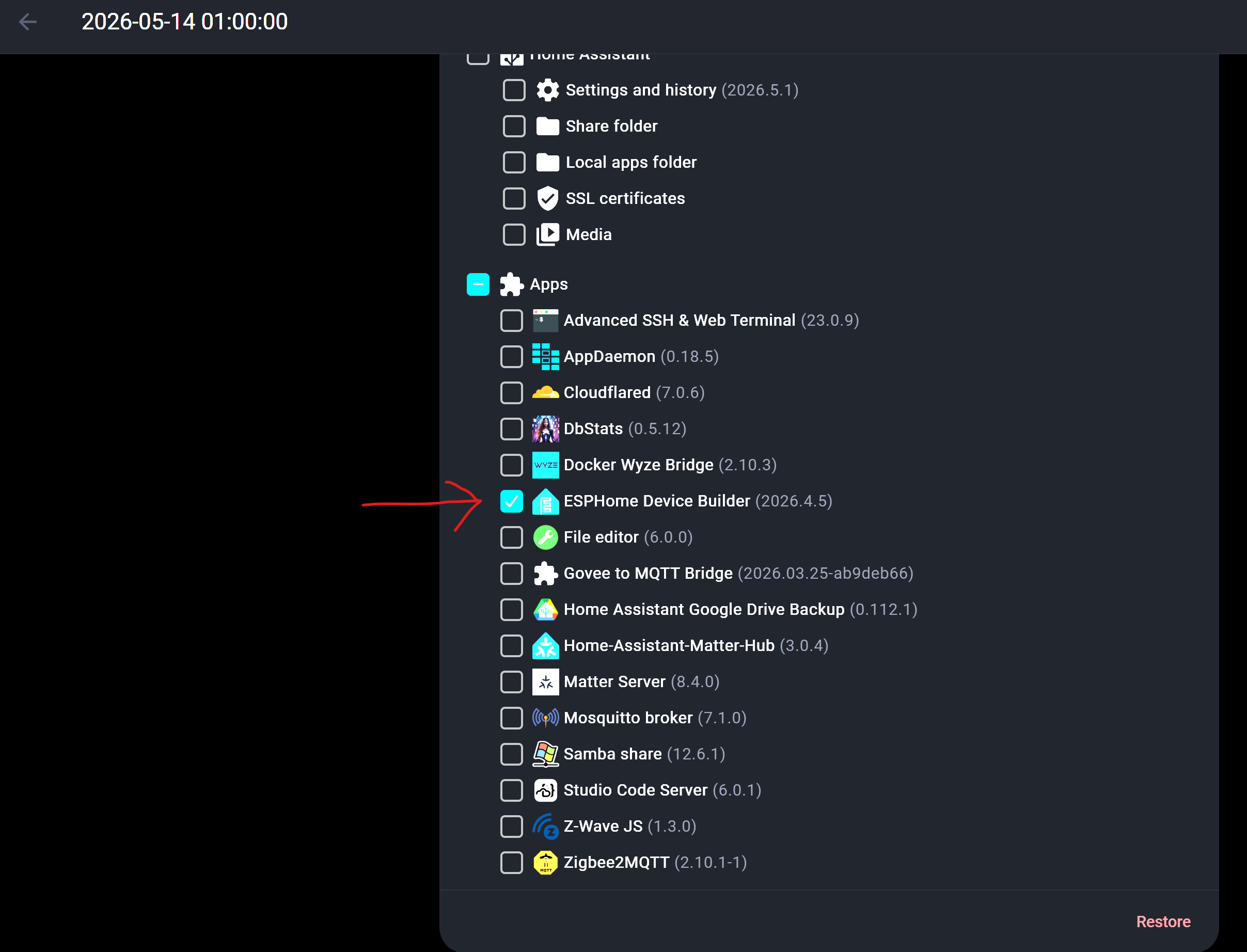

I tried this option yesterday as soon as I realized what I did, but still can't see this devices in ESPHome for some reason
Thank you for quick respond. This is what I did

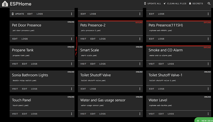

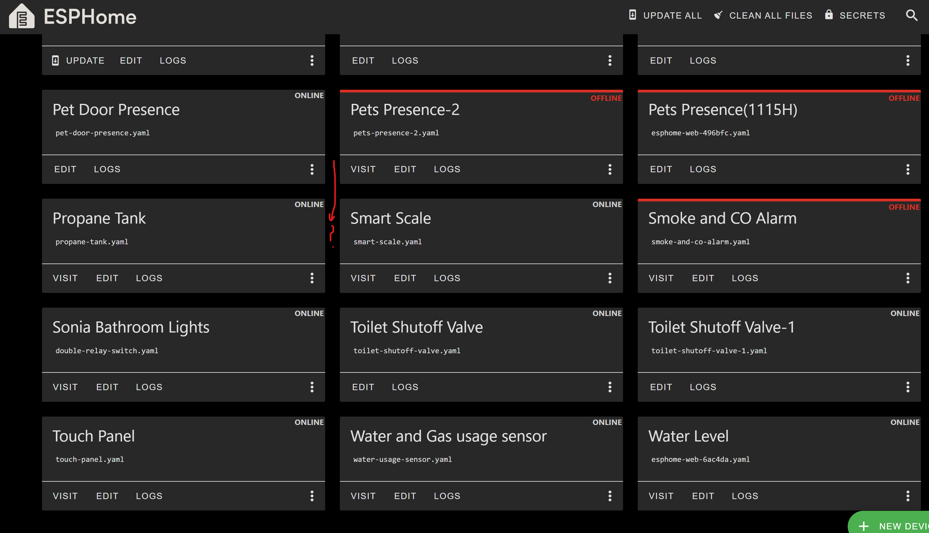

and no changes in ESPHome UI

Thank you for your solution. It's back. And I can see it and update it.
