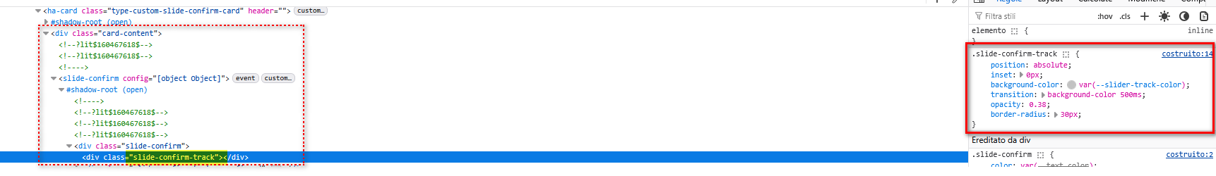

But I cannot reference the DOM shadow-root class .slide-confirm-track.
Can someone please help? @itsbrianburton

I want to add a different background color for the .slide-confirm-track class but since it is within a shadow box, the normal css coding (which works for .card-content class) is not working.

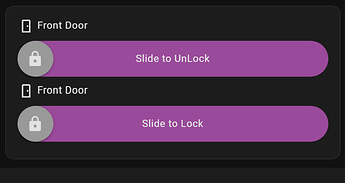

    slide-confirm$: |
        .slide-confirm-track {
          background-color: purple !;

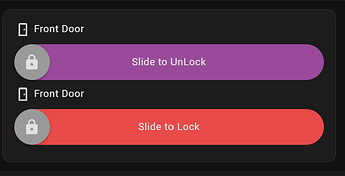

Try it without the .card-content: before stating it doesn’t work. You added additional code. that needs to be defined different.
card_mod:
  style:
    slide-confirm:nth-child(1)$: |
      .slide-confirm {
        background-color:purple;
    slide-confirm:nth-child(2)$: |
      .slide-confirm {
        background-color:red;
     div {
       padding: 25px 15px 15px 25px !important;

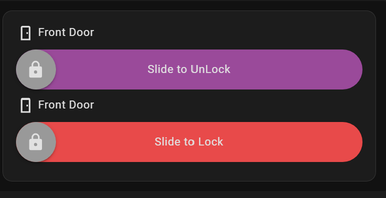

My screenshots are to validate the code I provide works.
Here is a sample card code
type: custom:slide-confirm-card
sliders:
  - name: null
    icon: null
    textUnconfirmed: Slide to Turn On
    textConfirmed: Light On
    iconUnconfirmed: mdi:lamp
    confirm_action:
      action: call-service
      service: light.turn_on
       entity_id: light.night_stand
  - name: null
    icon: null
    textUnconfirmed: Slide to Turn OFF
    textConfirmed: Light OFF
    iconConfirmed: mdi:lock-open
    confirm_action:
      service: light.turn_off
card_mod:
  style:
      .slide-confirm {
      .slide-confirm {
     div {
