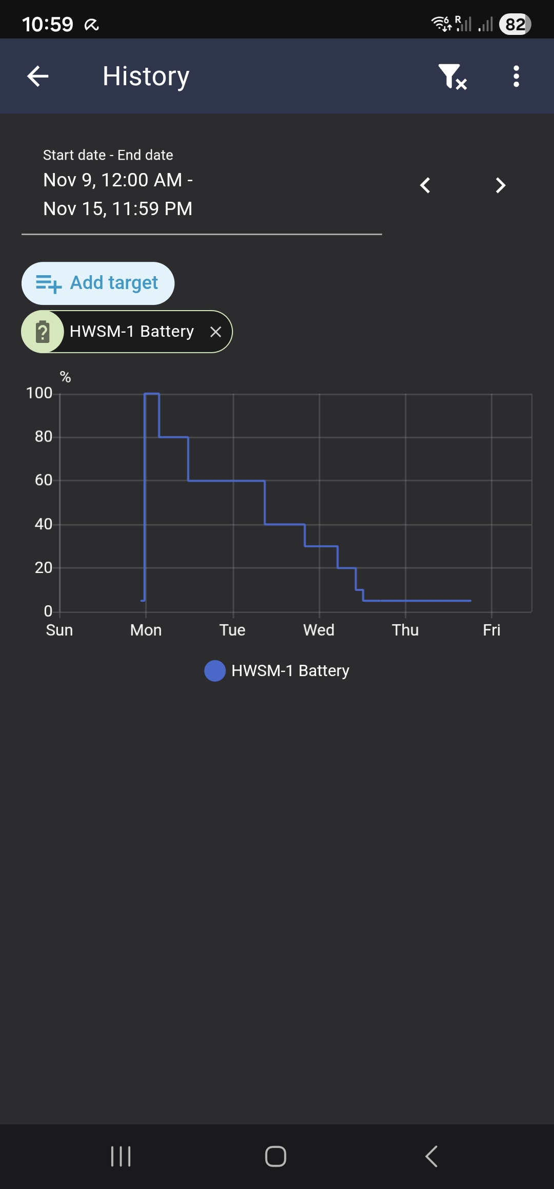

I need help to understand why the battery of my philips hue wall module become empty after 2 or 3 days…
The coordinator is not very far from the module, maybe uses 1 relay.
I tried to use other high quality battery
But same issue😔
You can see the baterry history in he screenshot attached.
If someone had the same issue and fixed I I will be more than happy
Best

I’ve found a fix
I have linked the to the official hue bridge. it proposed an update.
After that I have removed it from hue bridge and re-enter it to HA.
And then it work like a charm :wink:
