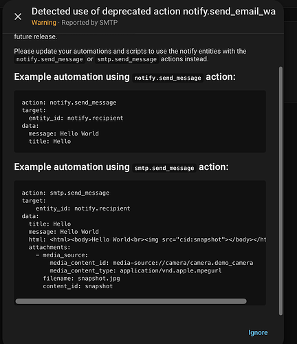

Recently got repair issues with SMTP notifications I am using in automations so now I’m editing all my automations to correct the syntax but not having much luck.
Repair notification-

With the new edit I get this error when trying to save it-
Message malformed: not a valid value for dictionary value @ data['actions'][0]['target']['entity_id']
I am using the entity ID shown in the SMTP integration. Not sure what I’m missing???

send_email is not an entity id, go into developer tools / states and find the correct name.
Thanks. Just discovered that I was using the friendly name instead of the ID. I had been using the friendly name in the past to avoid posting my email as @fleskefjes noted. Is that no longer possible without maintaining all my automations in a automations.yaml file?
Found the solution. Edit the entity ID. DUH :laughing:
I don’t really understand what the two have to do with each other…
Just like any other action that expects a target, you can target the action at Entities, Devices, Areas, and/or Labels. Based on the screenshot of the Entities list you posted it looks like you have 3 separate devices, so that is likely going to be the best target type for you to use.
If you prefer to stick with Entities as targets, another option would be to simply edit the entity IDs so they don’t contain the actual email addresses.
