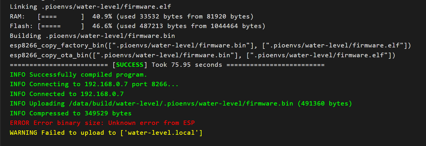

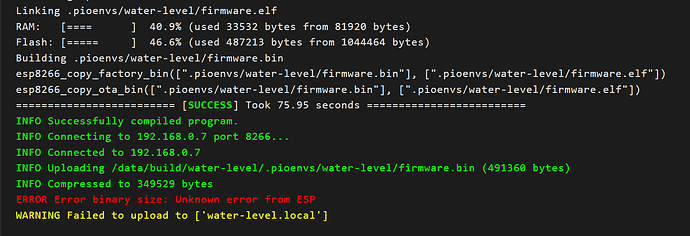

I have a water level esp devices. It’s online and no problem with log and functionality, but I cant update to lates esphome version. It’s shows this:

Can someone help me, please to understand what is going on. It’s not a big deal, if I will not update this device, but I would like to know why, to prevent this happened in a future. THANK YOU

I don’t know where this “Error binary size…” error comes from, but whenever I’ve encountered it, I’ve been able to resolve the problem by briefly disconnecting the power supply, performing a “Clean Build Files”, rebuilding and flashing.
However, I have two ESP8266s, which are operating at near their maximum memory capacity. With every update, I have to check whether they’re still working or not.
A trick has often helped me during flashing. I disconnect them from the power supply and only reconnect it during the linking process, just before flashing. In many cases, this has allowed me to flash the ESP8266s without removing them and flashing them via cable on my PC (the 2025_10_4 ESPHome Version was working at this ESP8266, the 2025_10_5 Version not…).
Same here… it happens with (very) recent esphome versions. Method mentioned above works (so far…). A bug in esphome?

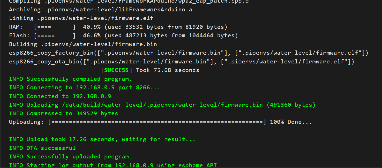

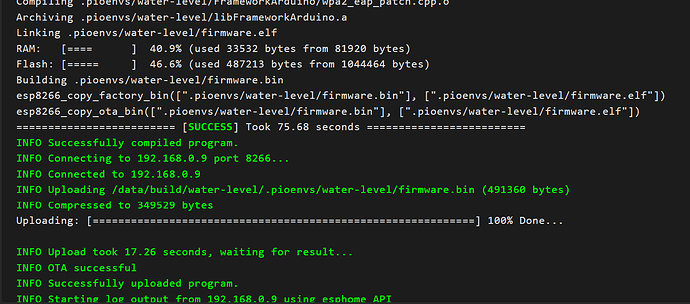

Thank you, guys, for all your suggestions and explanations. I will keep all this in mind. For some reason, today after I tried again to update , it’s updated without any problem :thinking:
