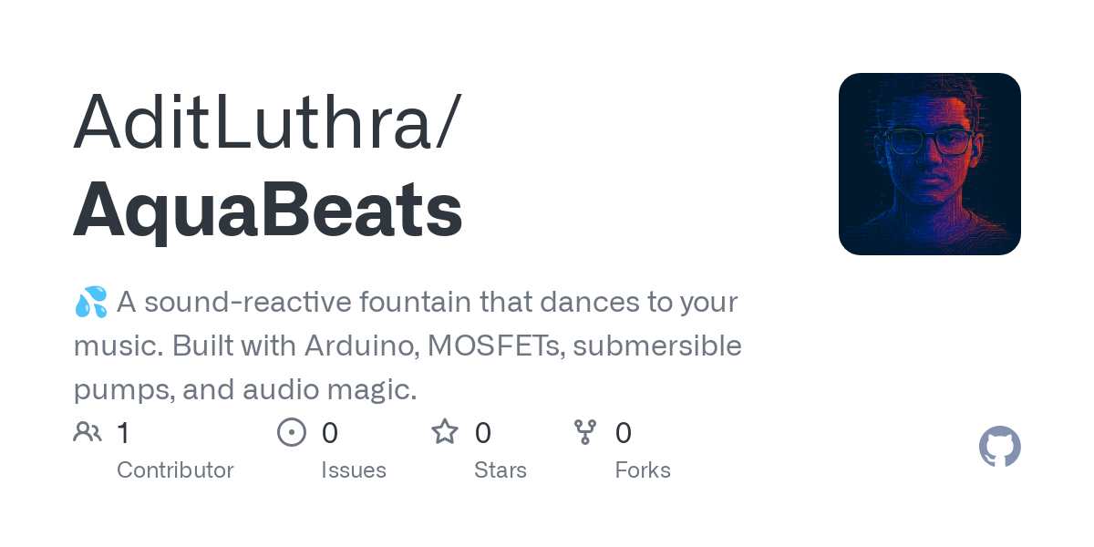

💦 A sound-reactive fountain that dances to your music. Built with Arduino, MOSFETs, submersible pumps, and audio magic.
