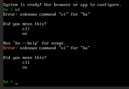

You’ll need familiarity with vi as the CLI doesn’t have nano installed.
Thanks for the quick reply. vi would be fine, but it seems that this is not available via HA-CLI either.

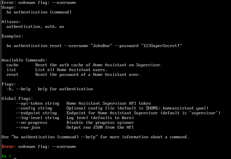

Thanks for the idea, but I get an “unknown flag: --username” error.

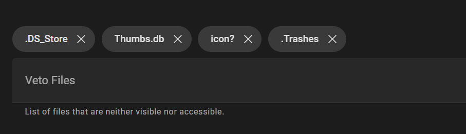

I recommend you set up Samba Share Addon so you can simply edit these files in notepad on your PC if something like this ever happens again.
You just need to remove .storage in the addon settings Veto Files section so you can see the hidden storage folder.
