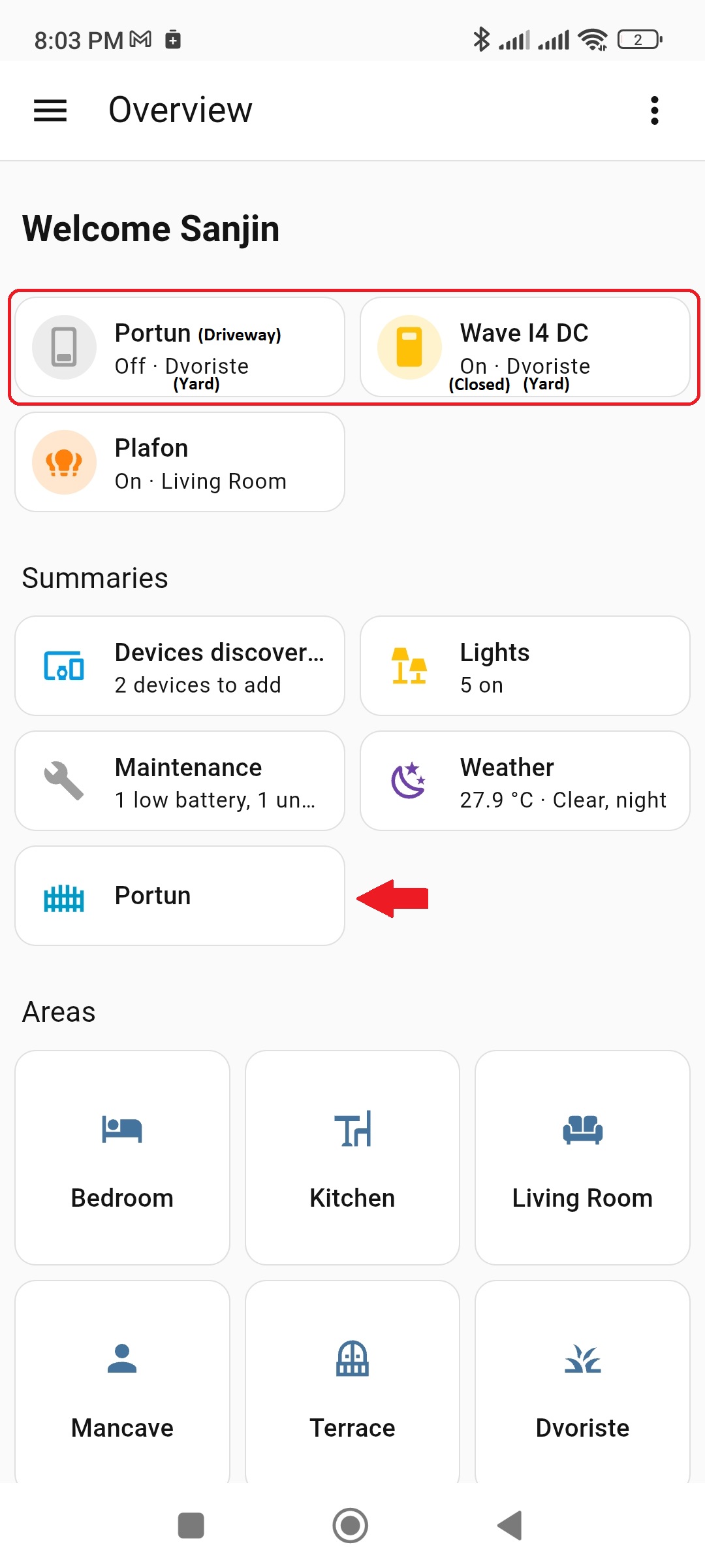

I’ve spent hours with Google Gemini trying to create a card on my dashboard but we just kept spinning in circles with the occasional “Oh you’re right, my bad, you must be using the new and improved Home Assistant.” Basically, it kept trying to get me to add a Button or a Tile card (which don’t exist?), so for the time being I just added two favorites to my dashboard (circled red) which I would like to get rid of (they really don’t amount to much) and have them display on a separate card (currently the “Portun” entity card that has the arrow pointing to it). I literally started yelling at Gemini at one point, so here I am, no caps lock, hoping you guys can help out. “We”'ve tried Helpers, Automations… nothing worked.
This is what it currently looks like:
I would like to add a simple button (ideally a “power” button since the toggle button doesn’t make much sense - it’s a push button, not a toggle - with the text that would read either “Opened” or “Closed” above or below the button inside the “Portun” entity card (or whatever else I need). Opened would obviously be the i4’s “Off” and Closed the i4’s “On”.

Edit: And the text “Off” below the “Portun” button top left means absolutely nothing since it’s configured as a momentary push switch - it’s just there. It does turn “On” until I press it again, but it’s irrelevant, I don’t even want it there.

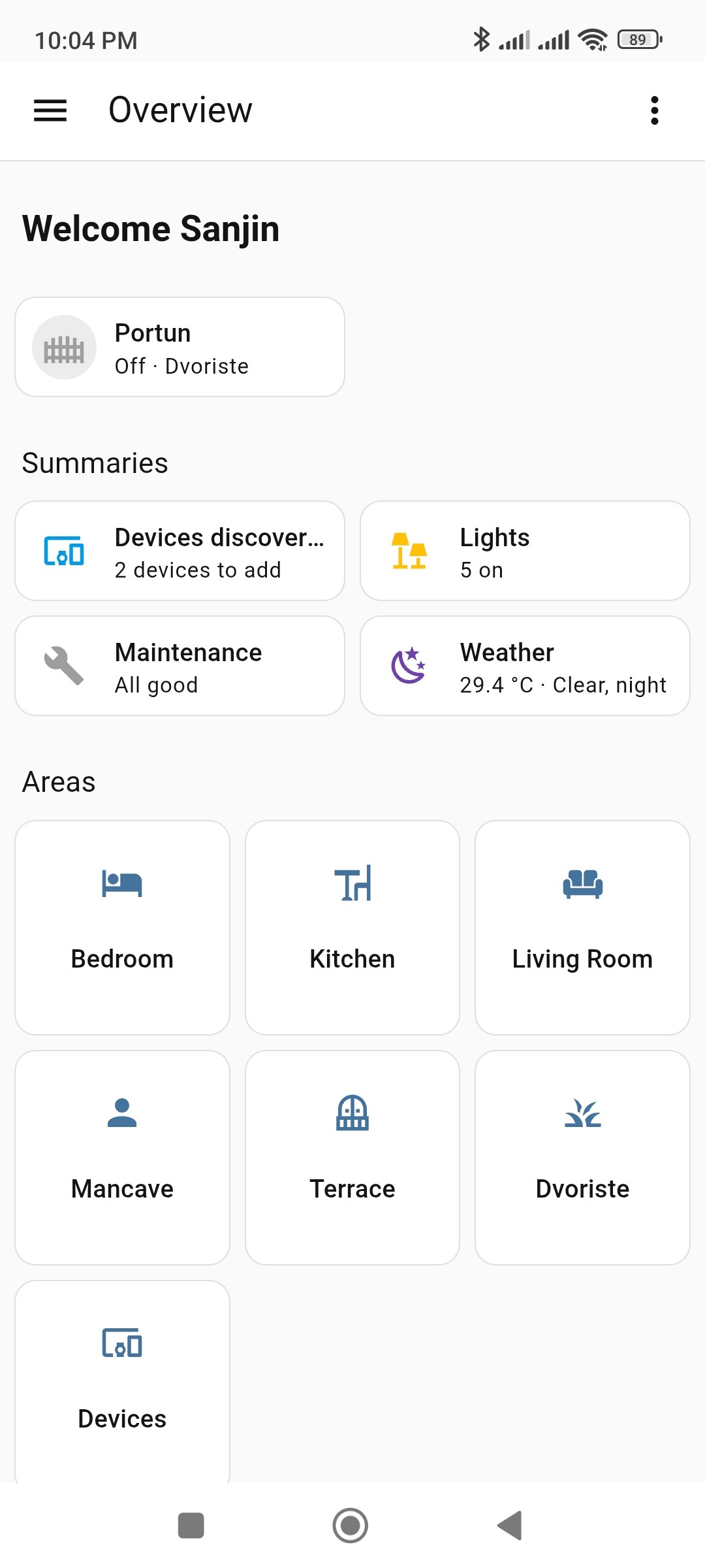

Anyway, managed to create a helper - it’s not ideal, but until I muster up the willpower to dive into dashboards it gets the job done at a quick glance. The “Off” text is a bit off-putting, but it can’t be helped since it’s a switch. But it’s tied into the reed magnet sensor so the icon is yellow when the gate is open and grey when closed. Good enough for now.
I did try modifying that is_state statement with an if/else/iif and ‘open’ and ‘closed’ magic words as Gemini and Copilot suggested but couldn’t get it right. Kept getting a Syntax error (for the template cover, not the switch).
Here is what it looks like now:
I’ll have to do a deep dive into dashboards one of these days and make some sections or something.
