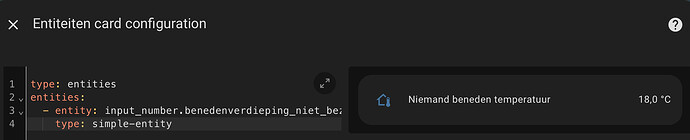

First of all you can display an input_number or number as a text without input box by setting it to a simple entity type, as stated in the docs:
Second, if you do not want the data to be entered by hand then it is key to select the entity helper type that is made for this purpose. It should get its value from somewhere, and there are helpers for almost any way. An input number gets the value from manual input, a template helper from a jinja2 template, a trigger based sensor from one or more triggers, a rest sensor from a rest call, a command line sensor from calling a command line utility, a file sensor from… you get the point. Unfortunately no one has created a stuffing sensor yet :wink:

But have you read the documentation I linked you to? You don’t have to if you want to display it in the dashboard without input box:
