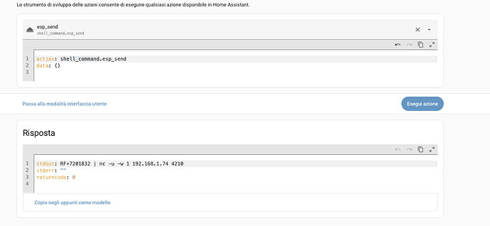

I’ve set the input_text with something that would be recognized be the esp device in this case “RF+7201832” but no command is ever sent and this is what I see in the gui:
Now, the input_text is being correctly pulled in as the correct value can be seen. But for whatever reason, the echo is intercepted by stdout and never correcly executed. I’m not a bash expert, so maybe this is just an issue with some commas, but I haven’t been able to figure this out yet, I hope that I may find my answers here.

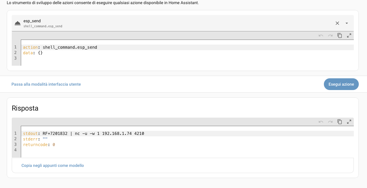

Even with your modification I’m getting the same result:
I still have no clue on why this is happening
Pipes do not work well in shell_command
try
shell_command:
  esp_send: >
    bash -c 'echo "RF+7201832" | nc -u -w 1 192.168.1.74 4210'
