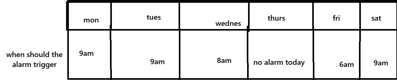

i have an overly complicated alarm automation running to help me wake up but its only triggered by a single date and time entity and would like some help customising it
here is a very basic mock-up of what i would like a dashboard page to look like (at least a section on a dashboard)
i would like to have the days layed out with a time dropdown near it for me to custom set the time for the set day, but then i want that custom set time to become a trigger on my automation, so when the set time on the dashboard is triggered it will run the automation, much like a standard date and time trigger but more custom on the dashboard so i don’t have to adjust it in the automation itself

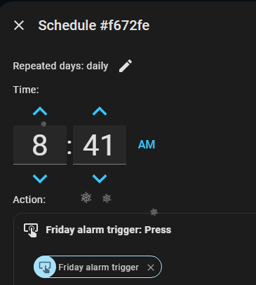

ok i think i get it, make a schedule, set something up on a dashboard to set the day/time then have the on state for the schedule trigger the automation, just need to figure out how to get it set up to be adjustable on the dashboard
got it, using the scheduler card i set it to press a button helper and that triggers the automation :slight_smile:
