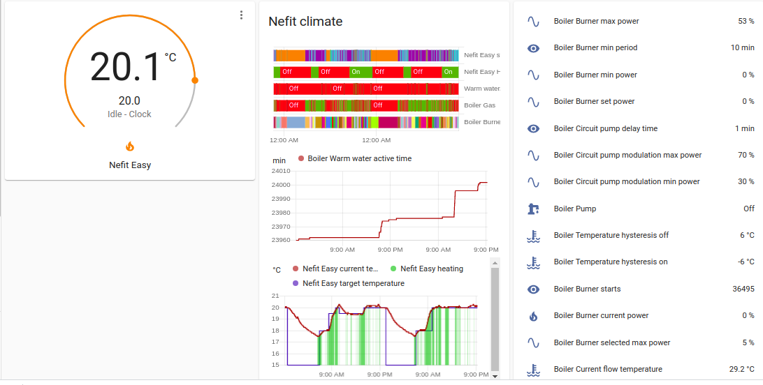

If you want to take a field trip with your Nefit take a look at this https://bbqkees-electronics.nl/product/gateway-standard/
This device is absolutely awesome and reads everything from your Nefit. Highly recommended. The picture below is parts of what the Nefit will show you.

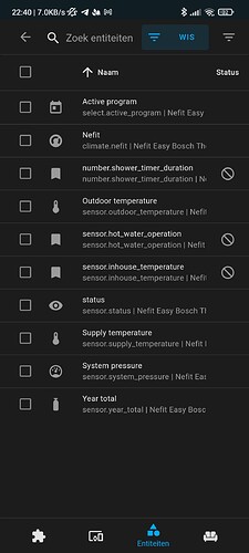

Since an unknown time period all of my switches (weather dependant mode, hot water, active program, etc.) started showing as unavailable.
Therefore I tried deleting the integration from HACS and starting over. But after that it only adds back the sensors.
Does anyone have an idea how to get the switches working again?
Thanks!
EDIT:
While digging through the log I found this error:
Source: custom_components/nefiteasy/switch.py:64
Integration: Schakelaar (documentation, issues)
First occurred: 22:37:45 (2 occurrences)
Last logged: 22:38:48
Error while setting up nefiteasy platform for switch
  File "/usr/src/homeassistant/homeassistant/helpers/entity_platform.py", line 249, in _async_setup_platform
    await asyncio.shield(task)
  File "/config/custom_components/nefiteasy/switch.py", line 40, in async_setup_entry
    await setup_home_entrance_detection(
  File "/config/custom_components/nefiteasy/switch.py", line 64, in setup_home_entrance_detection
    name=basetypeconf["name"].format(name),
TypeError: string indices must be integers```

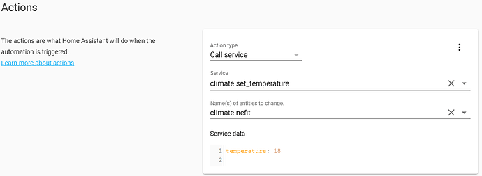

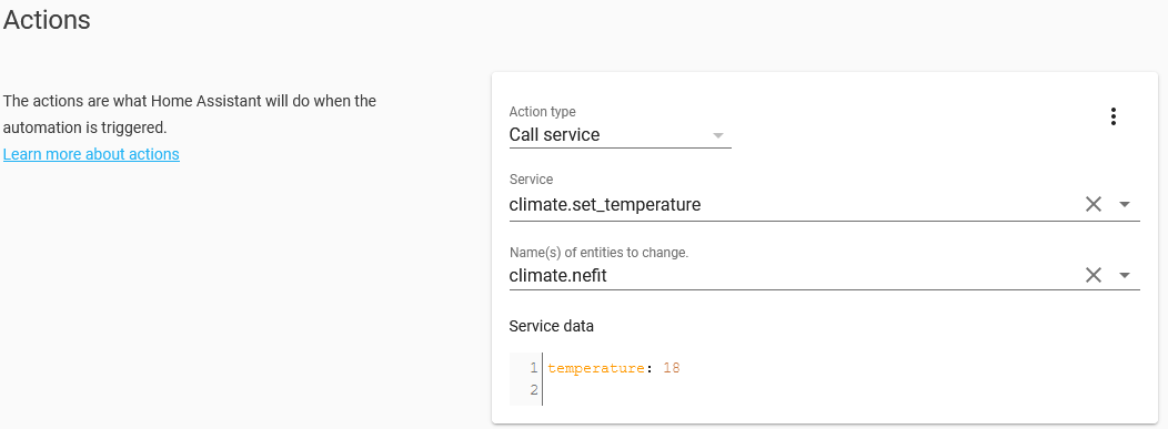

In the developer section it works with setting:
Blockquoteservice: climate.set_temperature
temperature: 19
entity_id: climate.nefit
But i can’t get it working in automation. Got errors. I tried several ways of setting the temp.
action:
  • service: climate.set_temperature
    data_template:
    entity_id: “climate.nefit”
    temperature: “19”
Or this:
- service: climate.set_temperature
    temperature: 19
    hvac_mode: heat
All give me an error:
Invalid config for [automation]: required key not provided @ data[‘trigger’][0][‘platform’]. Got None. (See /config/configuration.yaml, line 1594).
Can anybody help me with the automation of the Nefit Easy Custom Component Set Temp?

Hi Marcel, this works for me:
alias: At 17:00 set Nefit to 20 degrees
triggers:
  - trigger: time
    at: "17:00:00"
conditions: []
action:
      temperature: 20
mode: single
