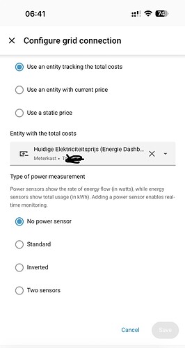

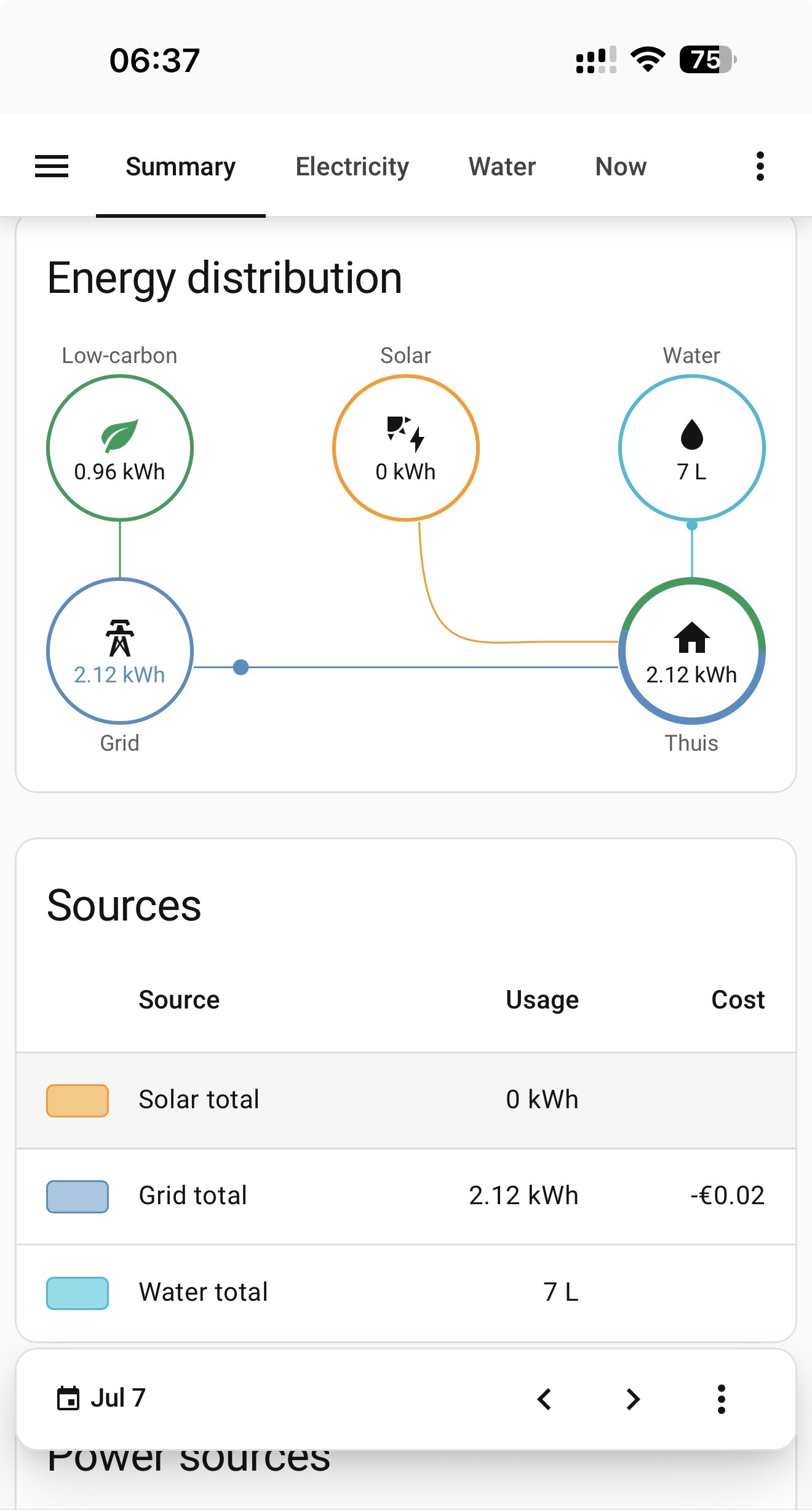

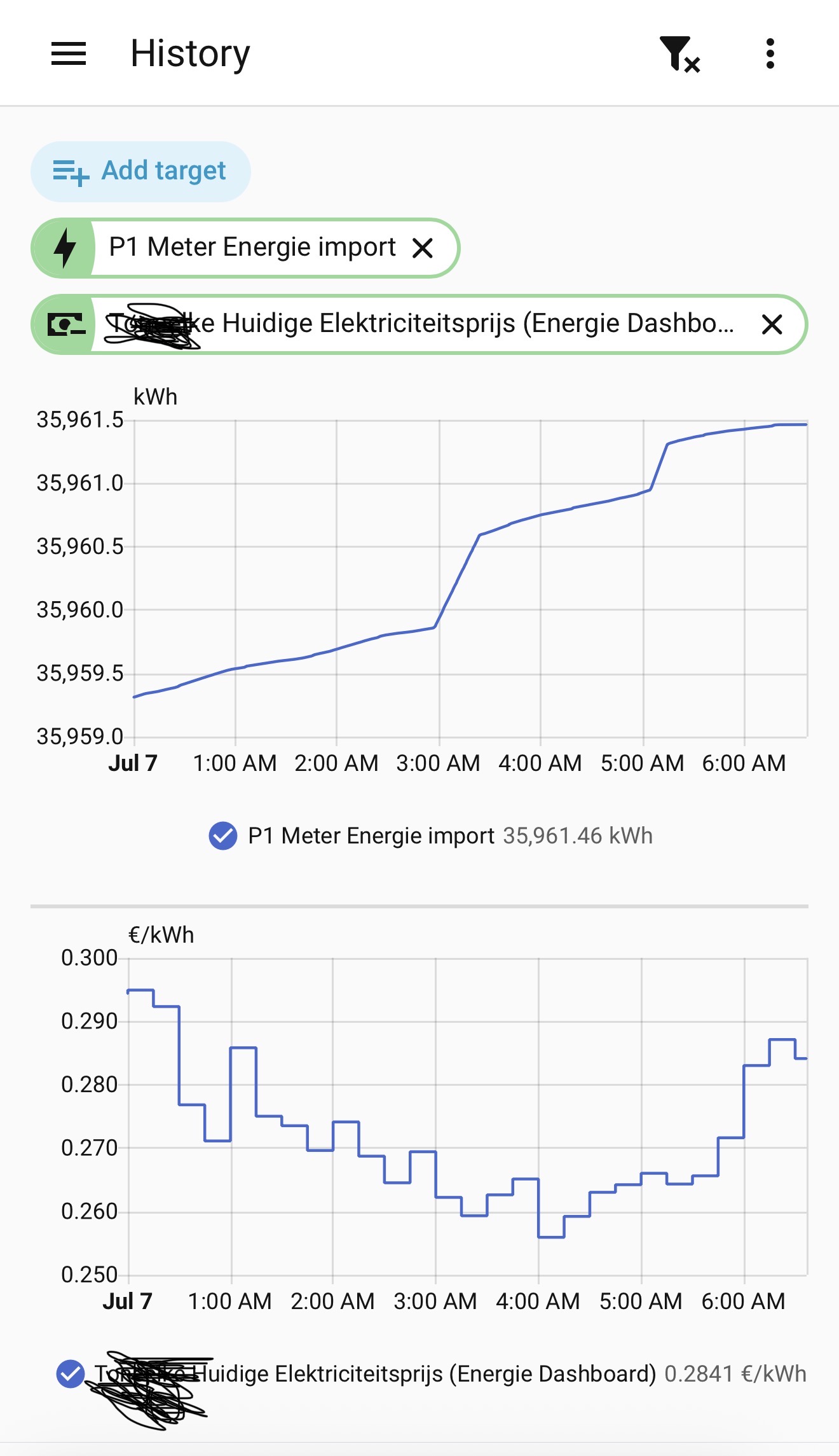

Am starting to become a bit frustrated; am setting up the energy dashboard for a friend. His setup is pretty straightforward with a HomeWizard P1 meter and Tibber (and solar panels). The challenge I am facing is that somehow the price in his energy dashboard always is very off. I have only setup the sensor for imported energy deliberately to do some bug hunting. Can anyone indicate what might be going wrong? See below screenshots from the setup and the values of the used sensors (none of them even hint to being negative).
