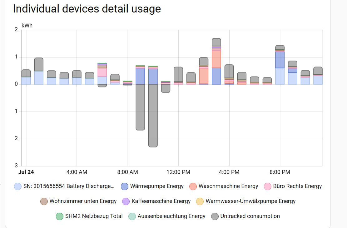

Negative untracked consumption, when battery charge is added to the card

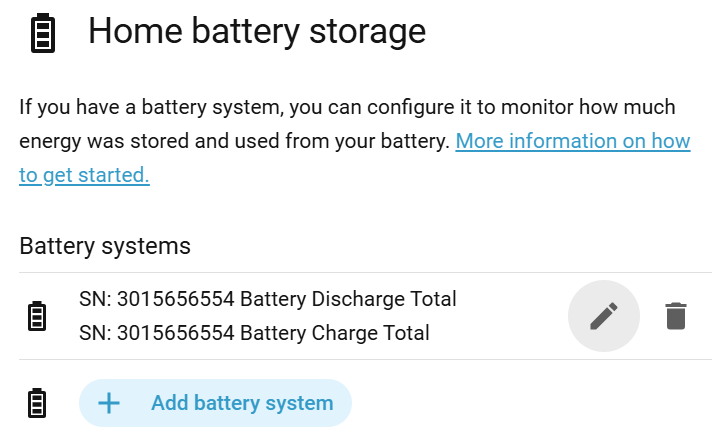

When I add the as battery system the sensor Energy going into the battery, I see negative untracked consumption for the individual devices chart.
When I remove the Charge and add a dummy sensor, then I don’t see the negative consumption.
I didn’t configure for the individual devices any upstream devices.
Do you mean the Stihl battery? How did you add it to the energy dashboard?
Sorry for the late reply. No it’s a BYD battery box.
When I remove the the Battery Charge Total and put a dummy sensor, I don’t see the negative consumption.
