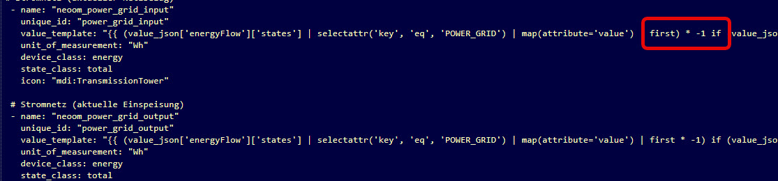

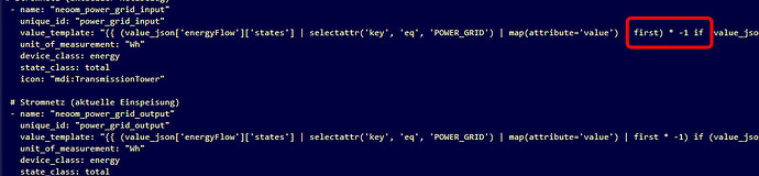

Hey Guys,
can you help me why are my “power_grid_input” have the same value than “power_grid_output”?
      # Stromnetz (aktueller Netzbezug)
      - name: "neoom_power_grid_input"
        unique_id: "power_grid_input"
        #value_template: "{{ value_json['energyFlow']['states'] | selectattr('key', 'eq', 'POWER_GRID') | map(attribute='value') | first }}"
        value_template: "{{ (value_json['energyFlow']['states'] | selectattr('key', 'eq', 'POWER_GRID') | map(attribute='value') | first) * -1 if (value_json['energyFlow']['states'] | selectattr('key', 'eq', 'POWER_GRID') | map(attribute='value') | first) < 0 else (value_json['energyFlow']['states'] | selectattr('key', 'eq', 'POWER_GRID') | map(attribute='value') | first) }}"
        unit_of_measurement: "Wh"
        device_class: energy
        state_class: total
        icon: "mdi:TransmissionTower"
      # Stromnetz (aktuelle Einspeisung)
      - name: "neoom_power_grid_output"
        unique_id: "power_grid_output"
        #value_template: "{{ (value_json['energyFlow']['states'] | selectattr('key', 'eq', 'POWER_GRID') | map(attribute='value') | first) * -1 if (value_json['energyFlow']['states'] | selectattr('key', 'eq', 'POWER_GRID') | map(attribute='value') | first) < 0 else (value_json['energyFlow']['states'] | selectattr('key', 'eq', 'POWER_GRID') | map(attribute='value') | first) }}"
        value_template: "{{ (value_json['energyFlow']['states'] | selectattr('key', 'eq', 'POWER_GRID') | map(attribute='value') | first * -1) if (value_json['energyFlow']['states'] | selectattr('key', 'eq', 'POWER_GRID') | map(attribute='value') | first) < 0 else 0 }}"
        state_class: total
same with template original from neeom:

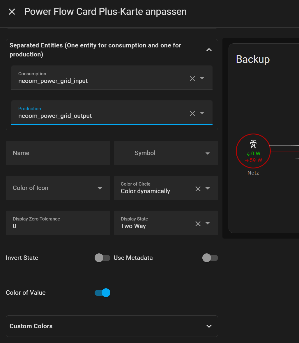

Do you have any idea? In Energy Flow Chart it shows me the same input and output.

In the “Netzbezug” you calculate the value *-1, this you must do only for the “Einspeisung”:
Compare your value_template with my current configuration, I just posted the current one.
I have the same issue as @Dominik1 . power_grid_input” have the same value as “power_grid_output. Any idea how to get the right values there?
