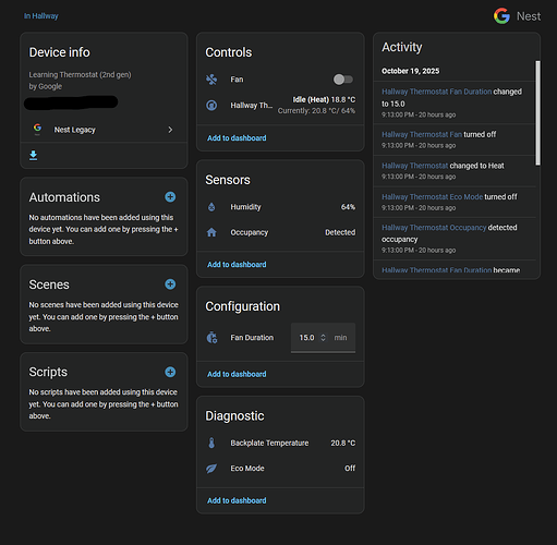

What works. I can change temperature again, mode and Eco and see occupancy, temperature/humidity.
What does not work is Fan control and duration. (That did not work with official integration anyway)
Big success overall. (Until Google pulls the plug on the Gen2 cloud next week).

Here are the screenshots.
