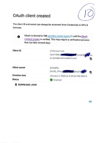

I have tried multiple times to re-add the integration by following these steps as shown in attached pictures .
Every time, after selecting my gmail account I get the error message “Something went wrong”.

it appears you have my project xx-xx-xxxx when it appears in the console to be my-project-xx-xx-xxxx.
But still reading so 1 moment, everything else appears correct, on the nest you can reset it in one of the settings menus(the one asking for the pin).
