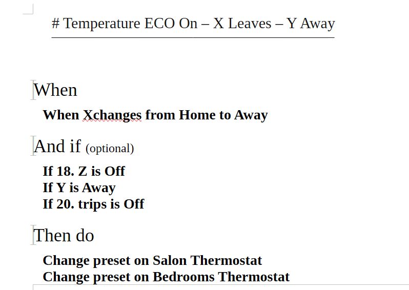

alias: "# Temperature ECO On  - X Leaves - Y Away"
description: ""
triggers:
  - trigger: state
    entity_id:
      - person.sX
    from: home
    to: not_home
conditions:
  - condition: state
    entity_id: calendar.17_Z
    state: "off"
  - condition: state
    entity_id: person.iphone_Y
    state: not_home
  - condition: state
    entity_id: calendar.18_trips
    state: "off"
actions:
  - device_id: ca6f638a89271fb93e4d9497159c
    domain: climate
    entity_id: 3975e1a4764e3cd48db9b3250b2b5
    type: set_preset_mode
    preset_mode: eco
  - device_id: e2ac58cd1c5c5c5405fcd3d565c
    domain: climate
    entity_id: 5a3659b9dad1ebf0962f8fec8f25
    preset_mode: eco
mode: single
If the person X leaves and the person Y is away, and the cleaning lady (person Z) is not in, and we are not on a trip
Then the thermostats are preset to ECO
