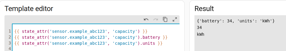

The following screenshot shows how to reference the values.
If you post your Template Sensor’s configuration, I can show you how to adapt it to meet your needs.
