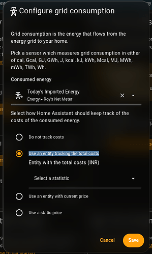

Net Energy Cost Template Sensor Can't be used in Energy Dashboard
My distributor has different charges for different usage of real energy (kWh) in a month, and I have net metering, so my grid exports need to be subtracted from my grid imports to calculate my total cost. Since Home Assistant has no such configuration for net metering (which is strange, since net metering is widely practiced in many countries, and is a huge reason people want to install solar panels in the first place), I had to create a template sensor to calculate the monthly total costs. This is what I have in my configuration file:

The first template sensor calculates the net import from the grid in a month. sensor.monthly_energy_import and sensor.monthly_energy_export are utility meter helpers that calculate my monthly grid import and monthly grid export, and resets according to my billing cycle, so the template sensor also resets monthly.
The second template sensor calculates the actual monthly energy cost according to my distributor’s tariff.
But in the Energy Dashboard, I cannot choose this entity as my total cost sensor.
My template sensor does not show up in this drop down. Home Assistant is recording the statistics of the template sensor, so the troubleshooting link did not help. What am I doing wrong? I’m certain it’s something so trivial that I’m missing it.
It was indeed trivial. The sensor needed the total state_class. With this in my config file, I could select the net energy cost template sensor in my Energy Dashboard.
