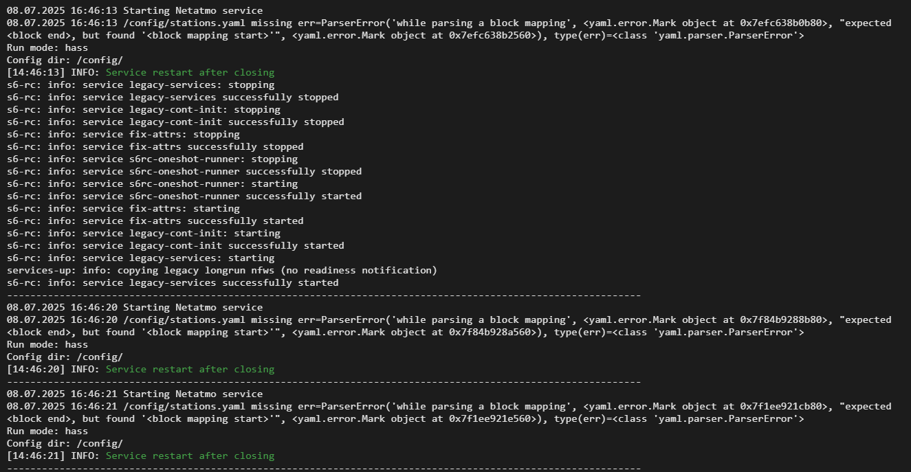

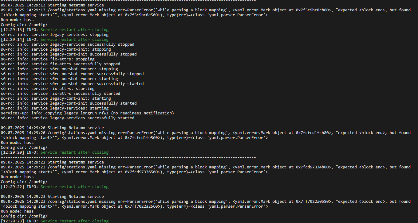

I tried to install and register as described in DOCS.md
But finally I get permanent errors which I do not understand.

can you paste your station.yaml?

can you check if you have one space in front of netatmo_stations: ?
or no space before calculated_sensors:
you can validate yaml here: https://www.yamllint.com/
there was no space in front of netatmo_stations: and one space in front of calculated_sensors:
I delete the space in front of calculated_sensors:
than restart HA + addon

the error message is still there, btw installed HA version is 2025.4.3
you still have one space in front of calculated_sensors.

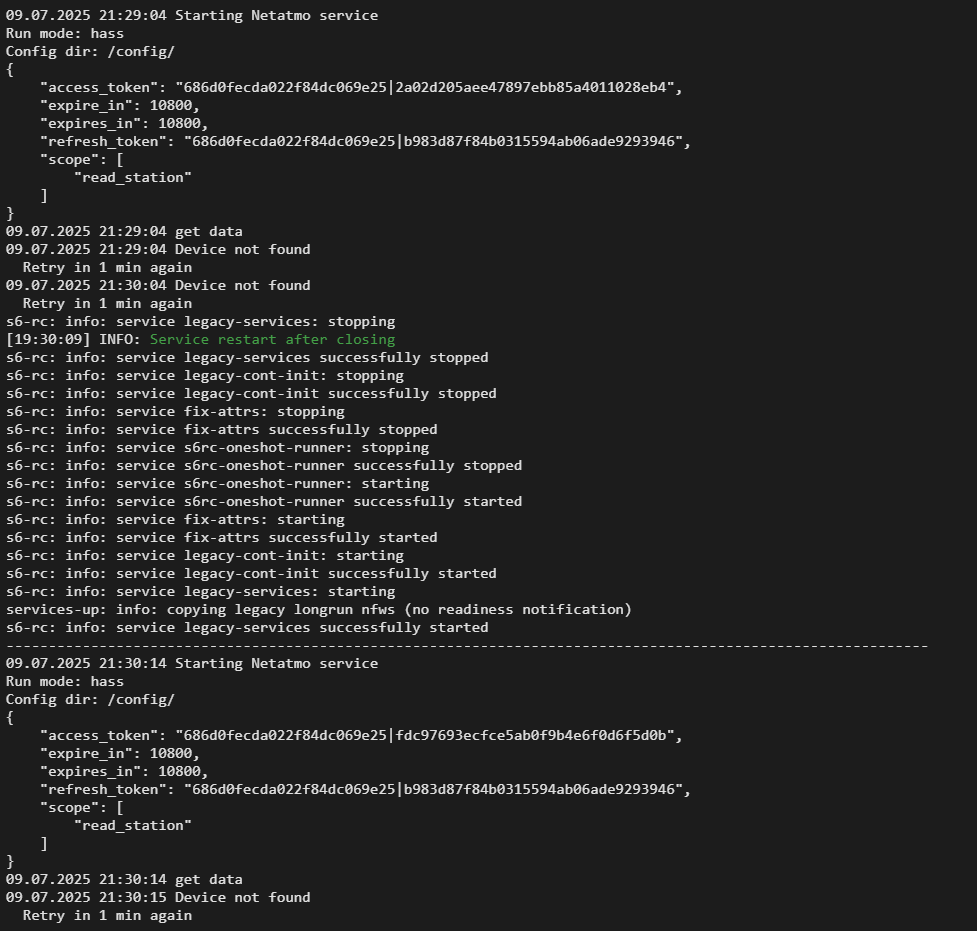

Thanks again for the hint - I correct it - guess we come closer now, but I still get error message “device not found” from the prefered station,
(Other station ID show same behave, )
In MQTT is no NETATMO sensor shown up to now, here my current station.yaml

log file while starting/stopping addon :
We solved the problem.
Error “Device not found” means the station was not added to favourite stations
thanks @GIZMoSK for your support to make the addon run -
works well + looking great
ps: for all beginners, a correct stations.yaml is the key
