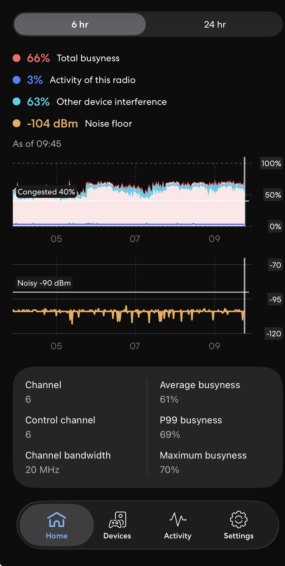

However. One thing that is a concern is heavy saturation on the 2.4ghz channel. Eero nodes showing 60% other device interference.

Well …. I should have been more precise, the issue is other device inteference. see screenshot.
Its an Eero Pro6E and i dont have the data to see if this was introduced during last FW ugrade.
There are 5 eeros at the property. I need to get this to a stage where I can really diagnose the Proxmox drop issue - anyone recommend a good wifi channel analyzer ? - interference my be coming from adjacent properties
