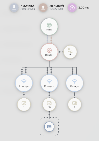

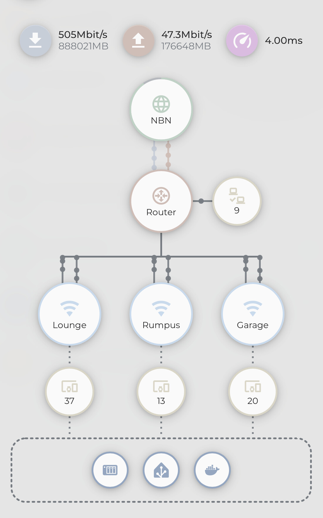

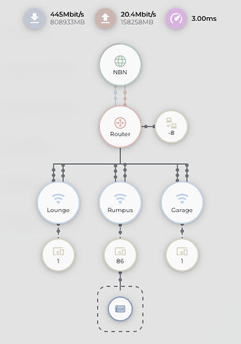

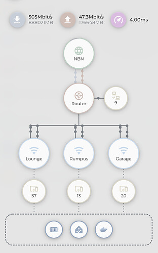

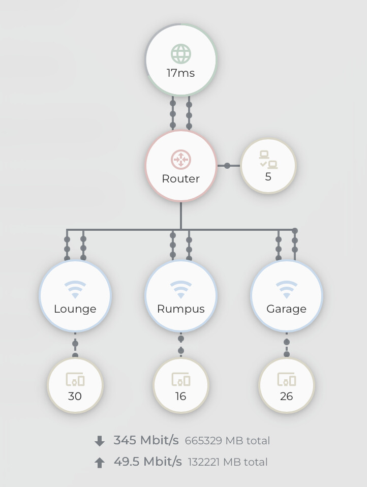

Thought I’d share this card I built based heavily on the Power Flow Plus card, to show network flows. It’s based on my own scenario which has the following integrations:
  1. Aussie Broadband:
  • Billing Remaining (two tone - outer ring of Internet)
  • Billing Length (two tone - outer ring of Internet)
  • Data Uploaded (can hide in ‘Advanced’)
  • Data Downloaded (can hide in ‘Advanced’)
  1. Speedtest
  • Upload (can hide in ‘Advanced’)
  • Download (can hide in ‘Advanced’)
  • Ping
  1. TP Link Deco
  • Connected Devices per AP
  1. TP Link Router
  • Connected devices per LAN (Helper which calculates the # of LAN devices connected by subtracting connected devices per AP from total connected devices and then removing the APs themselves if showing as online)
It’s slightly flexible, in that if you don’t have any APs you can just show the one router and LAN devices hanging off it, and you can add as many APs as you want. I have 3 in my case.
There is a lot that isn’t working but would love feedback on how I can make this more generally usable? It’s all AI coded as I’m no developer so was a lot of trial and error.
To install you will need to manually install for now by adding to your resources file. Source JS file can be found here: GitHub - benmac7/network-flow-card · GitHub.
Will add full install instructions when I get the chance and once it’s a bit more ready for prime time. Other things I want to add:
  1. Show APs if offline
  2. Show Internet if offline
  3. Add individual devices connected if desired eg. 3d printer)
  4. Make the download/upload details look nicer
Latest version now on Github. Still a WIP though with a few bugs, but its useable for now.

Just a “Side-note”, yes it’s a cool looking design
But it seems in your Top post
  • Billing Remaining
  • Billing Length
    So one could think/believe You have a subscription limited to a certain “amount” of usage
And Yet you have a Speed-Test Running pt.2( regularly ) ?, ( Can “Hide” )
Are You aware that a single Speed-Test can consume between 50MB>1GB ?
And regardless of Subscription-Type, a Speed Test, just load your Router and Connections( All other Apps/Services-Transactions suffers during a Speed-Test, Obviously )
Thanks for the note, I should clarify :slight_smile:
I have an unlimited usage plan, but I also have an integration for my ISP (Aussie Broadband) which tells me how many days I have left in the billing month (eg 7 days), as well as the length of the billing month (eg 30 days, 31 days). I figured I might as well use that data, so decided I’d use it to colour the ring around the Internet object.
So the two are entirely unrelated. The billing remaining just works out what % of the overall billing month length is remaining using those two entities, and colours that % of the ring a different colour.
My speed test also only runs every 15mins or so I think, and has never made a noticeable impact to my other internet traffic
Ok,yes a speed-test is relative short in terms of " time of each "
However 4 times an hour could be rather expensive for people with “Payed-by-consumed traffic”.
I only perform speed-tests, on “initial-base” and if i suspect “Issues” in that matter ( Speed will always variate during the Day/Night for various reasons ) and should not be a mandatory enabled feature ( Other-vice All Decent Router Brands, would have such enabled by default )
Lets say you have a free highspeed connection , and each test “costs” 1GB, that’s 4 in an hour … and " 96GB a Day " you bloat the public line with
Imagine if 1 , or 100 millions people do that, Your Speed will “Decrease” :wink:
This is just a card, no obligation for people to put the Speedtest entities in. They are optional :slight_smile:
Maybe you could add a “speed-test” button, which run a speedtest( from within HA :slight_smile: , or as now optional provided speed-test-entity ), and show “latest measured value” ?
Anyways i haven’t looked at Your card-code, but the card looks nice and “clean”

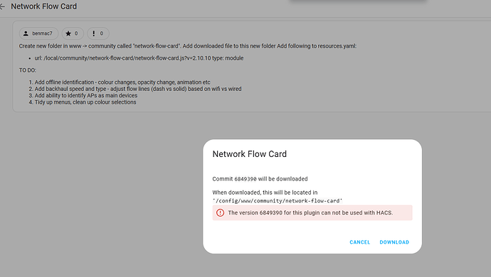

Hello From the BE25. The entity are unable by default
I have this error. I’m a newbie. I copy de the repository Github in HACS then Find it and Download
I haven’t set it up to work with HACS yet. You need to manually download the js and put it in your community folder, then add it to your resources.yaml manually too
Thank yoi for tour reply. Indeed it s mention in your read me :frowning: I m not a pro :slight_smile:

At the moment, the backhaul type is distinguished by dotted lines for wifi vs. solid lines for wired. If you want, I can add a wifi icon to the lines for when its wireless?
