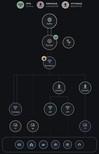

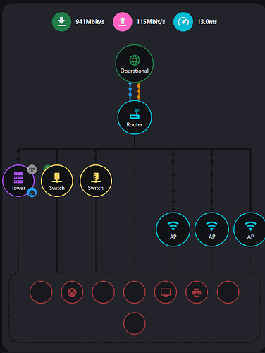

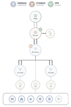

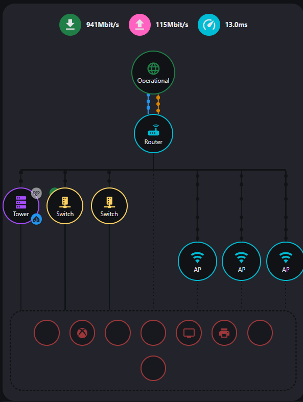

Network Flow Card - Visualise your local network!
NOTE: PLEASE UPDATE TO V3.0.1+ IF YOU ARE ON AN OLDER VERSION. REMOVED DEPENDANCY ON UNPKG AND MADE LOCAL

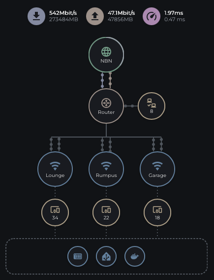

Inspired by the awesome Power Flow Plus card, I wanted to build a card to visualise all my network elements and their status, everything from Internet through to individual devices which I want to monitor whether they are online or not.
So, here is Network Flow Card, a card which allows you to build out your network (hopefully) and visualise in a single card.
Install by adding my custom repository to HACS. Note this is my first time developing and making a card available, so welcome any feedback. I “think” I have covered most scenarios, but if there are any other feature requests people can think of, would love to hear them!
Will post some screenshots of the various configurations I hope this will cover in the coming days.
Network Flow Card
A custom Lovelace card that visualizes your home network as a live flow diagram — Internet → Router → Access Points → Devices — in the same visual style as power-flow-card-plus, but for your network instead of your energy dashboard.
Key Features
Full network topology Internet, Router, LAN, and any number of Access Points, all connected with animated download/upload flow lines. Router is optional — hide it and Internet connects straight to your APs.
Primary Access Point Designate one AP as “primary” and choose how it’s displayed:
  • Tiered — promoted into the main trunk, sitting above the other APs like a mini-router
  • Flat — stays inline with the rest, marked with a small customizable badge (icon, colors, and size all configurable)
Live status at a glance
  • Ping, jitter, and billing-cycle progress ring on the Internet node
  • Per-node offline detection with pulsing warning icons and dimmed, color-coded states
  • Configurable download/upload/ping summary badges (top/bottom/left/right), each hiding automatically if you haven’t set up that entity
Access Points, your way
  • Any number of APs, freely reorderable
  • Per-AP Backhaul Type support — shows a wired or wireless icon on the connector line automatically
  • Connected Devices count per AP, hanging off its own branch
Individual Devices tracker A dashed-bordered box at the bottom of the card tracking any entities you want — presence sensors, specific devices, anything — with the same online/offline styling as the rest of the card.
Make it match your theme Every color defaults to your Home Assistant theme’s variables (works great in dark mode out of the box) and is fully overridable per-element if you want something custom.
One place for sizing Circle and icon sizes for every node type (Internet, Router, LAN, APs, Connected Devices, Individual Devices) are set once under Advanced settings — no need to size each item individually.
Full GUI editor Every option above is configurable through the visual editor — no YAML required (though YAML works too, if that’s your style).
Compatible with card_mod for any additional styling tweaks you want to layer on top.
https://github.com/benmac7/network-flow-card

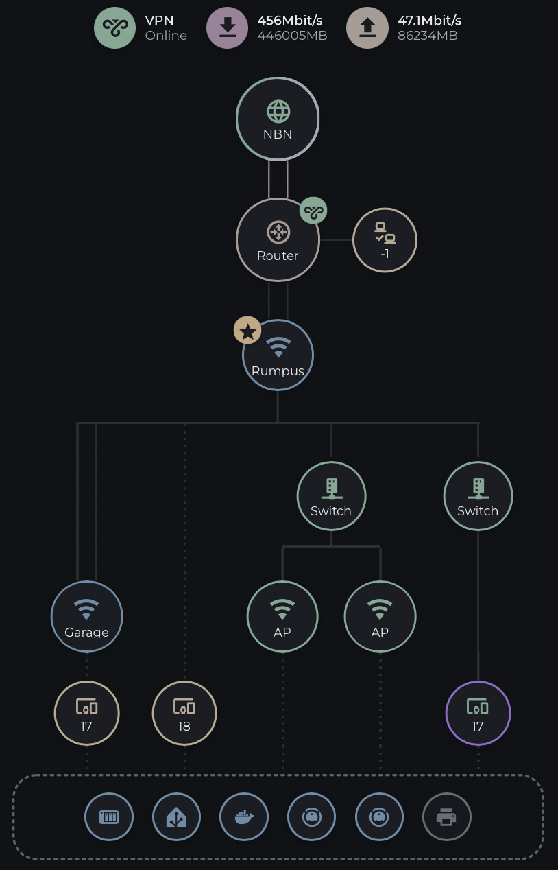

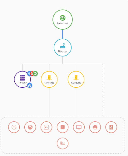

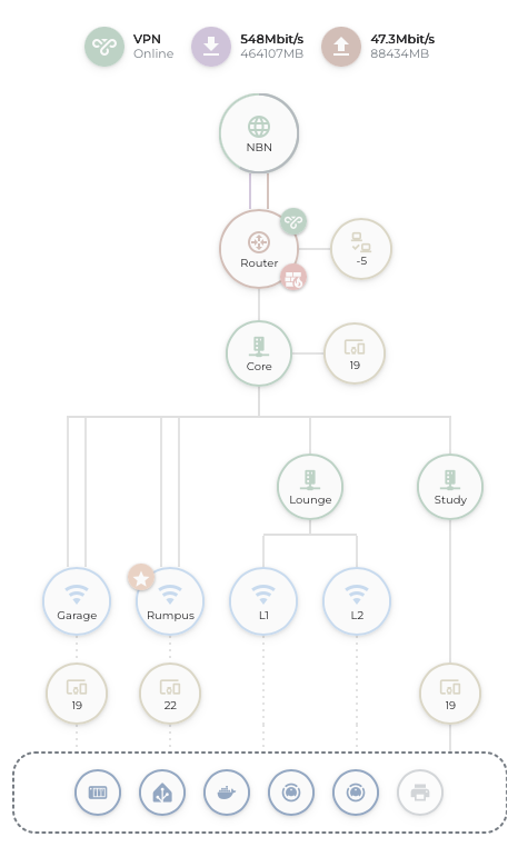

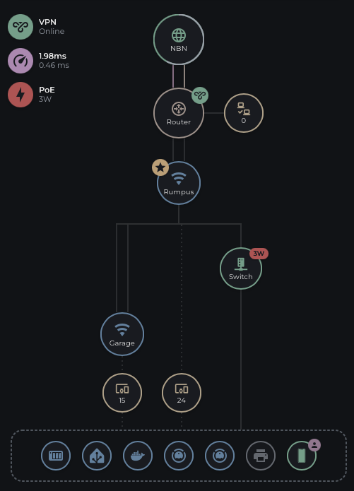

v2.0.0 released with lots of changes! Biggest change is now supporting distribution/access switches and tiered topologies.
[2.0.0]
A major release consolidating everything since 1.4.1 into one stable
version. The headline change is Nodes: Access Points are no longer
the only thing that can hang off the bus - a Node can now be a plain
AP, a standalone Switch, or a Switch feeding one or more of its own
Access Points.
Added
  • Nodes: the Access Points menu is now Nodes. Each entry in
    the list can be:
    • A plain Access Point, exactly as before.
    • A standalone Switch, with its own icon, colors, offline
      detection, and an optional Connected Devices count.
    • A Switch feeding one or more Access Points, connected via its
      own small secondary bus-line - each AP underneath still gets full,
      independent configuration (bandwidth, backhaul, Connected Devices,
      colors).
    • Existing configs migrate automatically on load - every existing
      Access Point becomes its own Node with no visible change.
    • An AP can be flagged Primary regardless of which kind of Node
      it lives in, for the star badge and VPN/Firewall targeting. Tiered
      (promoted-above-the-bus) layout is only available when the Primary
      AP’s Node is AP-only; if it’s inside a Switch’s group, the card
      silently renders as Flat instead of breaking the group apart.
    • The Node containing the Primary AP stands out in the Nodes list -
      icon shown in var(--accent-color), with “(Primary)” appended to
      its title.
  • Security page: the VPN menu is now Security, and sits
    alongside a new Firewall badge - its own entity, an “Applies To”
    target (Router or Primary AP), an Animate-when-Offline toggle, and
    full active/offline color and icon customization. Firewall’s badge
    sits at the bottom-right of its host circle (VPN stays top-right), so
    both can be shown on the same node without overlapping.
  • Fully configurable Summary: choose any 3 items, in any order,
    from Download, Upload, Latency and Jitter, VPN Status, or Firewall
    Status (Advanced → Layout → Summary Item 1/2/3). Replaces the old
    fixed Download/Upload/Ping arrangement and separate per-badge
    “Show in Summary” toggles.
  • Global Flow Line Color (Advanced page): one color now controls
    every connection line and flow-dot animation on the card - Router,
    Switch (top-level and Node-level), LAN, Access Points, Individual
    Devices, and every Connected Devices connector - except the Internet
    connection, which remains independently configurable on the Internet
    page. The many separate per-node line-color pickers this replaced
    have been removed from the editor.
  • AP Column Gap slider (Advanced → Sizes) - controls the horizontal
    spacing between Node columns, so a large number of them can be
    packed tighter to fit on screen instead of stretching off it.
  • Backhaul Icon Size slider, and an Individual Devices Box
    Border Radius
    setting (any CSS length or theme variable; defaults
    to var(--ha-card-border-radius, 12px)).
  • Uniform column widths: every Node column is now at least as wide
    as the largest AP, Switch, or Connected Devices circle actually used
    in that specific diagram, so a column with only a thin connector
    line never looks visibly narrower than its neighbors.
Changed
  • Unified badge sizing: Primary AP, VPN, and Firewall badges now
    share a single “Badge Size” / “Badge Icon Size” pair (Advanced →
    Sizes) instead of separate controls for each.
  • Unified Switch sizing: a Switch’s own Connected Devices circle -
    whether the top-level Switch above the bus, or a Switch-only Node -

NOTE: I have tried to build POE and Guest wifi in for Unify devices, but would welcome testers as I cannot test this myself!
Adds Power over Ethernet (PoE) monitoring for Switches (including a
PoE Total Summary item), and a guest network indicator for Individual
Devices.
Added
  • PoE badge on Switches (both the top-level Switch and any
    Node-level Switch): a small top-right badge showing summed PoE
    wattage, no icon - just the value and unit. Two ways to source the
    total:
    • Auto - sums every entity on the switch’s own device that
      reports watts and looks PoE-related (covers per-port sensors from
      integrations like UniFi Insights without listing every port by
      hand).
    • Manual - sum exactly the entities you list. Works even if the
      Switch itself has no status entity configured - PoE only needs the
      listed sensors, not the switch’s own entity.
    • The badge hides itself entirely when there’s nothing to show,
      rather than displaying “0 W” for a switch with no PoE sensors
      enabled.
  • PoE badge coloring: a single fixed color, or threshold
    colors
    - up to three tiers (e.g. green up to 15W, orange up to
    30W, red above that), each independently colorable. Text color is
    set separately from the badge background in both modes.
  • PoE “Animate when above top threshold” toggle (only shown in
    Threshold color mode) - the badge flashes using the same animation
    as the VPN/Firewall badges once the total exceeds every configured
    threshold.
  • PoE Badge Size and PoE Badge Font Size sliders (Advanced →
    Sizes) - independent controls, so the pill’s size and its text size
    can be tuned separately.
  • PoE Total Summary item: a new option for the Summary rows
    (mdi:lightning-bolt, “PoE” / summed wattage) that adds up every
    PoE badge actually shown across the whole diagram - the top-level
    Switch and every Node-level Switch. Supports the same single-color-
    or-threshold coloring as the per-switch badges (Advanced → Layout,
    shown once PoE Total is selected as a Summary Item); its icon color
    is fixed to match the other Summary badges, and it never flashes,
    regardless of threshold settings.
  • Guest network badge on Individual Devices: a small icon shown
    top-right on any Individual Device currently connected to a guest
    network, only while the device is online. Detected automatically
    from the device’s own entity attributes - no per-device setup
    required:
    • TP-Link Deco - interface attribute equal to "guest".
    • UniFi integration - is_guest attribute equal to true.
  • Guest badge icon, icon color, and badge background color
    (Individual Devices page - background defaults to transparent), plus
    independent Guest Badge Size and Guest Badge Icon Size
    sliders (Advanced → Sizes). All global settings applying uniformly
    to every Individual Device.
Fixed
  • A Switch with no Connected Devices circle showed a dashed
    pass-through line where it should be solid.
    The line segment
    filling that gap wasn’t distinguishing a Switch-fed column from an
    Access-Point-fed one the way the segment above it already did, so it
    always rendered the AP’s dashed style regardless of source.

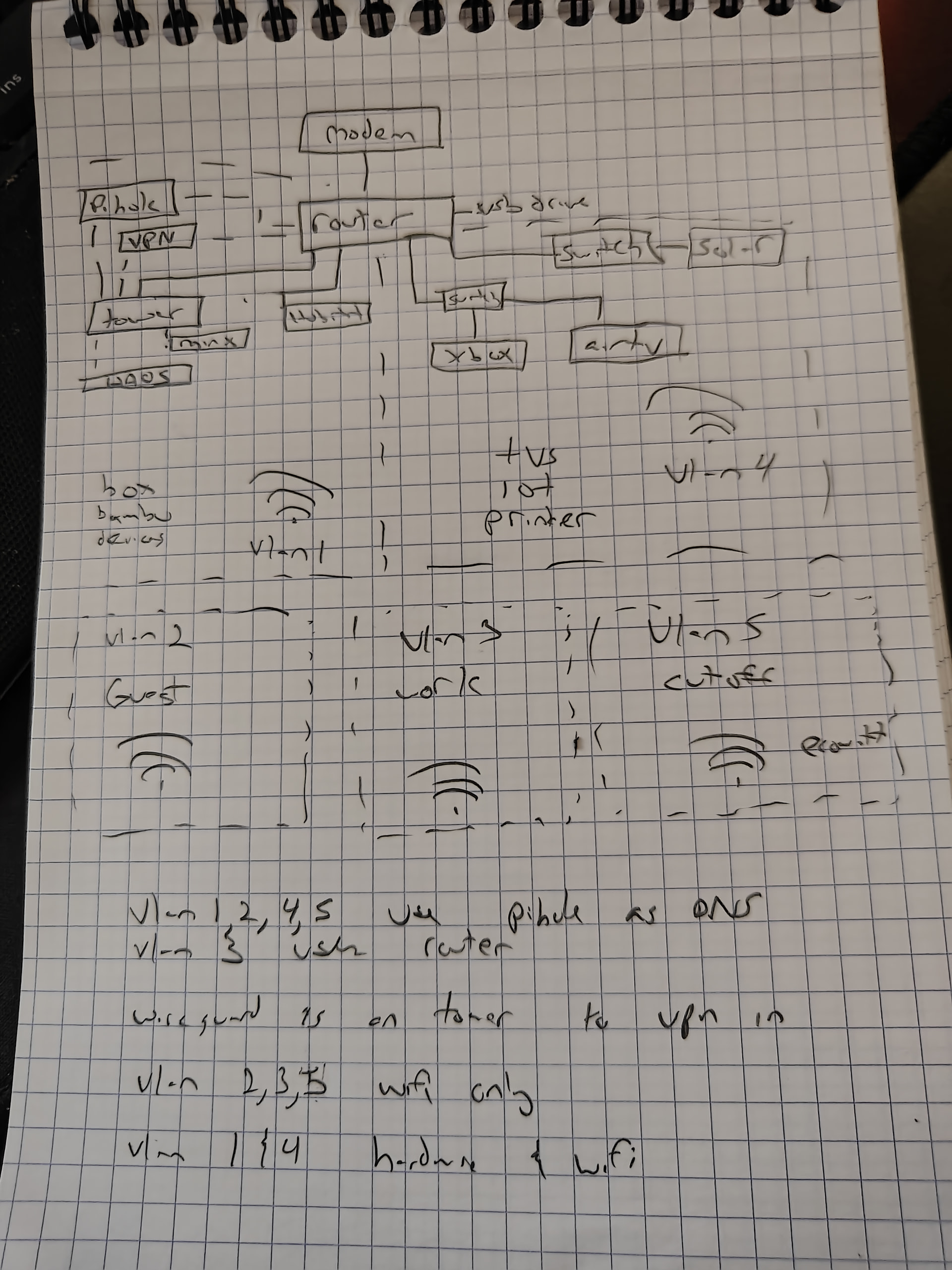

So, great idea, few questions on the card.
1-For any device (router, switch) thats not in HA, do you just use a helper entity?
2-Assuming you can follow any of what I drew, how would you set this up? Essentially my router has 5 vlans and most devices run through pihole/unbound for dns which sits on the same server that runs HA/Unraid.
Thanks for the diagram, super helpful! I hadn’t factored in a server to control VPN and pi-hole etc, but definitely looks like something I should include.
Where are your access points? Is the router itself performing the wifi functionality for all VLANs/SSIDs?
Download 2.3.1 and have a play around. I “think” the below models most of what you have, with the main caveat being I haven’t added the ability to identify which network individual devices are connected to apart from a guest network. Let me have a think about that, but if you can send me any details on what router you use and if/how HA can tell you which network each device is connected to.
Full yaml for my mock up in next message below so you can copy and paste in to your card and then change the entity details as needed.
Use this code, have treated the router as an AP

Yes, the router controls the Wifi/Vlans (I do have a repeater down the line i forgot to show but thats minor)
Its getting closer, there is a width constraint it seems, even setting the gap to low I cannot get more to show. Ideally the wifi would be from the router and somehow showing vlans, but this is a good step.

          icon_color: var(--card-background-color)
          border_color: transparent
          offline_color: 'var(--disabled-text-color, #bdbdbd)'
          offline_icon_color: var(--card-background-color)
          offline_border_color: transparent
          animate_offline: false
    access_points: []
    fed_switches: []
  - name: ''
      entity: ''
      icon: mdi:switch
      devices_icon: mdi:devices
        connected_devices: ''
      colors:
        icon: var(--amber-color)
        circle: var(--amber-color)
        bus_line: 'var(--divider-color, #ccc)'
        offline_circle: var(--error-color)
        offline_icon: var(--error-color)
        devices_circle: var(--purple-color)
        devices_icon: var(--primary-color)
        devices_line: 'var(--divider-color, #ccc)'
        devices_offline_circle: var(--error-color)
        devices_offline_icon: var(--error-color)
      poe:
        mode: 'off'
        manual_entities: []
        unit: W
        icon: mdi:lightning-bolt
        location: top-right
        color_mode: single
        color: var(--orange-color)
        text_color: var(--card-background-color)
        thresholds:
          - up_to: 15
            color: var(--green-color)
          - up_to: 30
          - color: var(--red-color)
        animate_over_threshold: false
    homelab: null
    access_points: []
    fed_switches: []
  - name: ''
      entity: ''
      icon: mdi:switch
      colors:
      poe:
        mode: 'off'
        manual_entities: []
        unit: W
        location: top-right
        color_mode: single
        thresholds:
          - up_to: 15
          - up_to: 30
    homelab: null
    access_points: []
    fed_switches: []
  - name: Router
    switch: null
    homelab: null
    access_points:
      - entity: input_boolean.router_status
        icon: mdi:router-wireless
        is_primary: true
        primary_badge_location: top-left
        show_backhaul_icon: true
        show_primary_badge: false
        connects_to_switch: false
          download: ''
          upload: ''
          backhaul_type: ''
          backhaul_speed: ''
        colors:
          icon: var(--cyan-color)
          circle: var(--cyan-color)
          download: var(--blue-color)
          upload: var(--orange-color)
          line: var(--primary-text-color)
          devices_line: var(--purple-color)
          backhaul_icon: var(--secondary-text-color)
          primary_badge: var(--orange-color)
          primary_badge_icon: var(--card-background-color)
          primary_badge_border: transparent
        poe:
          mode: 'off'
          manual_entities: []
          unit: W
          location: top-right
          color_mode: single
          thresholds:
            - up_to: 15
            - up_to: 30
    fed_switches: []
  - name: ''
    switch: null
    homelab: null
    access_points:
      - entity: ''
        icon: mdi:wifi
        is_primary: false
        show_primary_badge: true
          download: ''
          upload: ''
          backhaul_type: ''
          backhaul_speed: ''
        colors:
        poe:
          mode: 'off'
          manual_entities: []
          unit: W
          location: bottom-right
          color_mode: single
          thresholds:
            - up_to: 15
            - up_to: 30
    fed_switches: []
  - name: ''
    switch: null
    homelab: null
    access_points:
      - entity: ''
        icon: mdi:wifi
        is_primary: false
          download: ''
          upload: ''
          backhaul_type: ''
          backhaul_speed: ''
        colors:
        poe:
          mode: 'off'
          manual_entities: []
          unit: W
          color_mode: single
          thresholds:
            - up_to: 15
            - up_to: 30
    fed_switches: []
  - name: ''
    switch: null
    homelab: null
    access_points:
      - entity: ''
        icon: mdi:wifi
        is_primary: false
          download: ''
          upload: ''
          backhaul_type: ''
          backhaul_speed: ''
        colors:
        poe:
          mode: 'off'
          manual_entities: []
          unit: W
          color_mode: single
          thresholds:
            - up_to: 15
            - up_to: 30
    fed_switches: []
individual_devices:
  - entity: ''
    icon: phu:hubitat
    colors:
      circle: var(--pink-color)
      icon: var(--pink-color)
  - entity: media_player.xbox
    icon: mdi:microsoft-xbox
    colors:
  - entity: ''
    icon: phu:appletv-sim
    colors:
  - entity: ''
    icon: phu:huawei-solar-inverter
    colors:
  - entity: ''
    icon: mdi:television
    colors:
  - entity: ''
    icon: mdi:printer
    colors:
  - entity: ''
    icon: phu:bambu-lab-alt
    colors:
  - entity: ''
    icon: phu:ecowitt
    colors:
individual_devices_box_color: var(--divider-color)
individual_devices_box_radius: var(--ha-card-border-radius, 12px)
show_summary: true
animation: true
min_flow_duration: 0.6
max_flow_duration: 6
