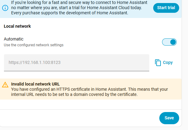

I have been having issues with HA network connections since 2026.8 updates. I notice today that the settings are changing by itself!
I have turned off the automatic as well as put in my url (the same as my external) and sometimes I go back here and the url I put in is removed and it is changed to automatic.

Thanks. I did all of this. Still seeing spotty network issues where I need to refresh connections with mobile app. I had none of these prior to this update. I had issues during beta where I needed to change duckdns settings. I added NGINX after the beta started so it did not get migrated. I followed the latest directions when I installed it and it says to put all the http stuff in the configuration yaml file. I have since removed it from the yaml file and added it to the NGINX configuration. Hopefully I will figure out what I have done incorrectly and get my system back to normal soon.
I believe I have fixed the issue with my network. I changed my external connection from https://xxxx.duckdns.org:8123 to https://xxxx.duckdns.org. It has been stable since I changed this. I can not find any documentation on this “New” system \ network tab. The release notes mention nothing on the settings. They only talk about the port. I am still not sure if local should have the 8123 or not?
