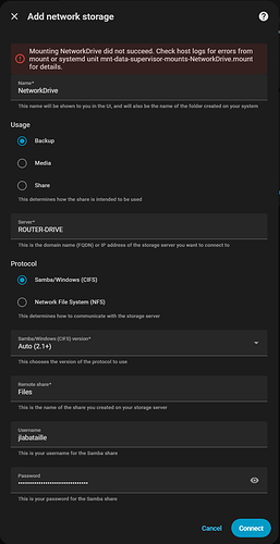

Network storage will not mount. Config error?
I have a hard drive connected to my network that I want to use for backups. It is connected via my ASUS router using their samba share feature.
Windows PC works fine to access this folder, but I cannot get HA to accept the share.
The error and configuration are below. On my Windows PC, I can access the share via path \\ROUTER-DRIVE\Files\HA Backups\.
Any idea what I could be doing wrong?

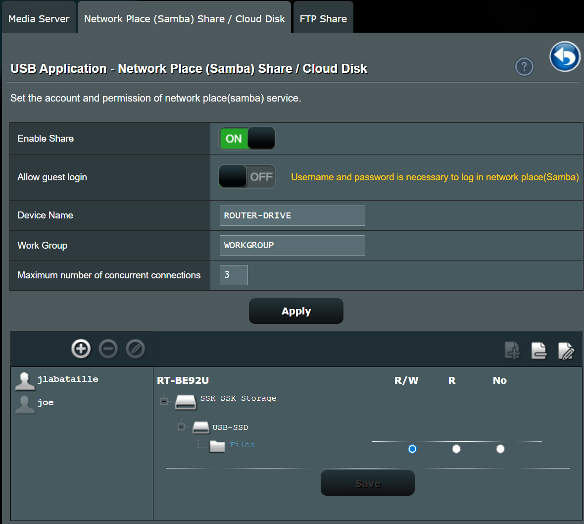

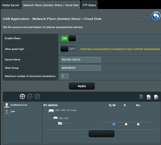

Here is the configuration. It’s pretty simple and my Windows PC can see the drive. I do not have any media servers or UPnP configured.

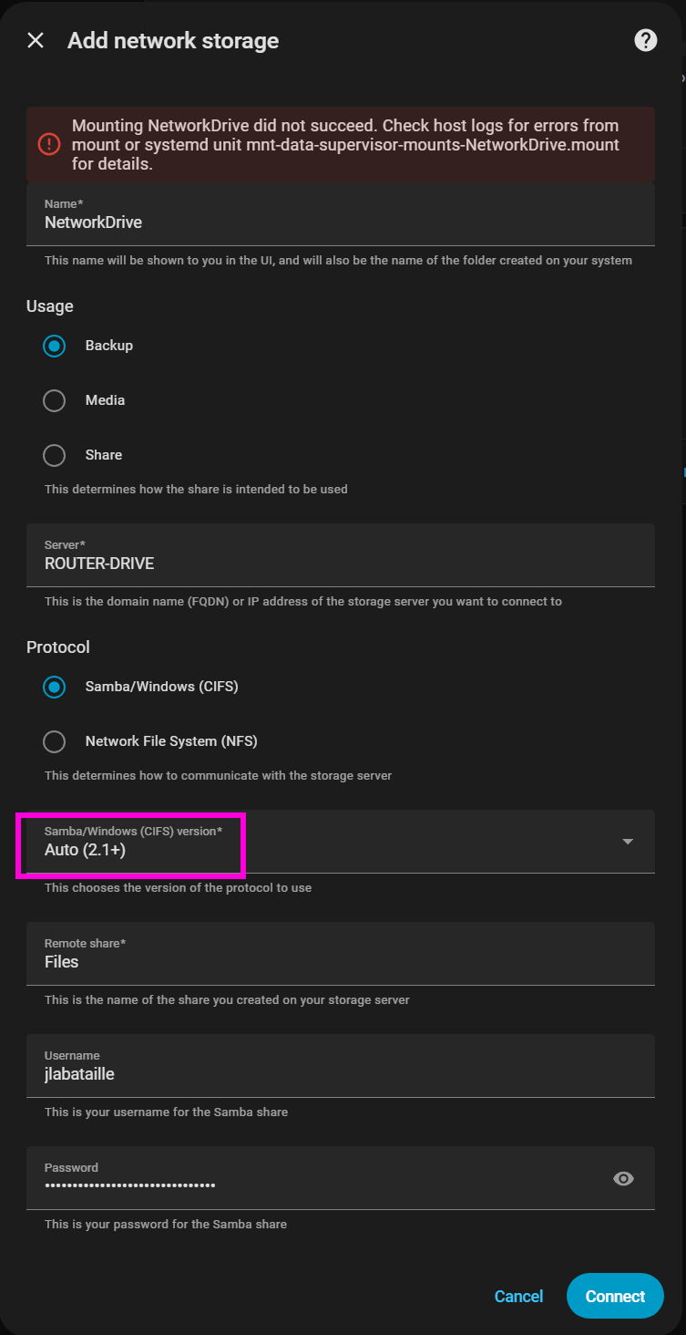

My guess is that it is using SMB 1.0/CIFS. A quick google search seems to confirm it.
Try changing this:
I tried both v1.0 and v2.0 and they both return the same error as before. Could there be some other conflict I’m not considering?

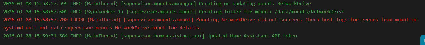

Check the logs on your router and the host like the error says.
^ This, check logs in the Asus UI first
If that doesn’t return any info, try setting Remote Share to ROUTER-DRIVE also
The ASUS routers shows nothing new in the general log (or any log) after I try to mount the remote drive in HA.
FYI, theh HA Host log shows this, which isn’t very helpful:

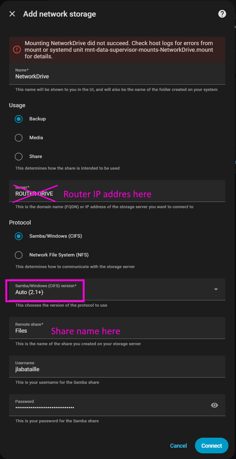

You need to specify the ip address of your router in the server field. Home Assistant cant resolve “ROUTER-DRIVE”
I’ve tried using the IP address of my router (192.168.50.1). It gives the same error unfortunately. I also tried the earler samba versions without success.

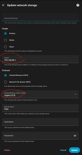

I got it to work, but it requires a strange sequence done exactly like below. I suspect a weird samba implementation on my router. Here is the sequence that worked:
  1. First, reset a samba user (delete user and add back the same user). Why this is required is unknown.
  2. Use the following settings exactly:
    • Server must be IP address
    • Use Samba version legacy (2.0). DO NOT USE v1.0 or v2.1.
