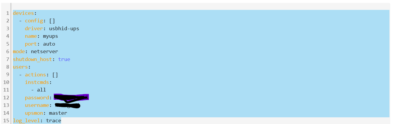

The NUT add-on configuration is a follows
Any hints how to set it up to switch both the HA machine and UPS when low battery threshold has been reached will be appreciated

Thanks for the answer. I found a discussion about this in the nut add-on issues (Not powering down the UPS · Issue #35 · hassio-addons/addon-nut · GitHub). I understand that it is not possible to implement the shutdown of the UPS from the add-on container. Therefore there is no simple solution to the problem. I am considering to put another system (pi zero?) running nut as primary and make it shutdown the system running HA OS (running nut as secondary) and the UPS.
