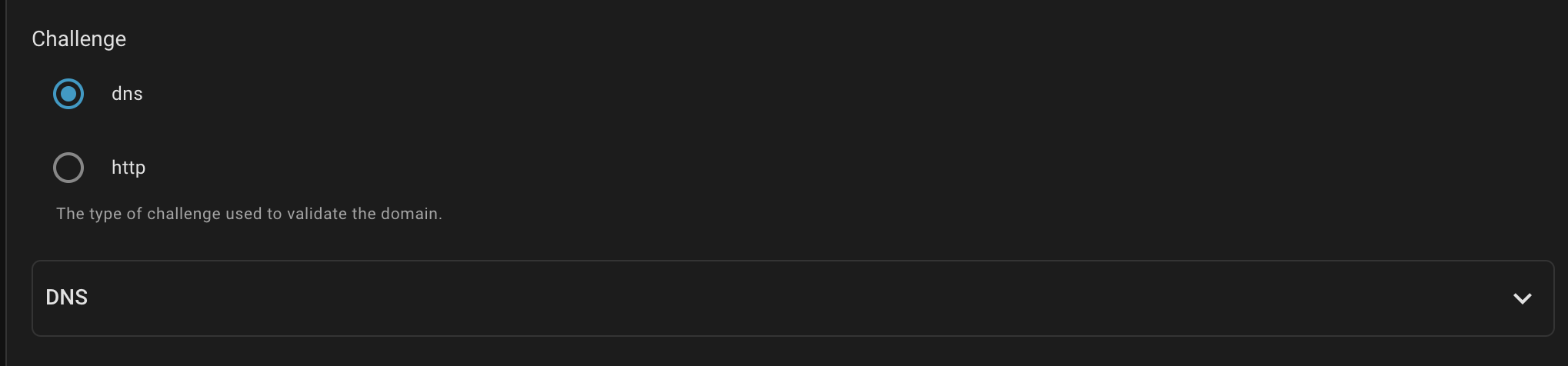

FWIW: The Certificate Expiry Addon does support “DNS-Challenges”:

Could you expand on the Certificate Expiry Addon please? I just found a Certificate Expiry Addon which can’t actually issue certificates (I believe).
