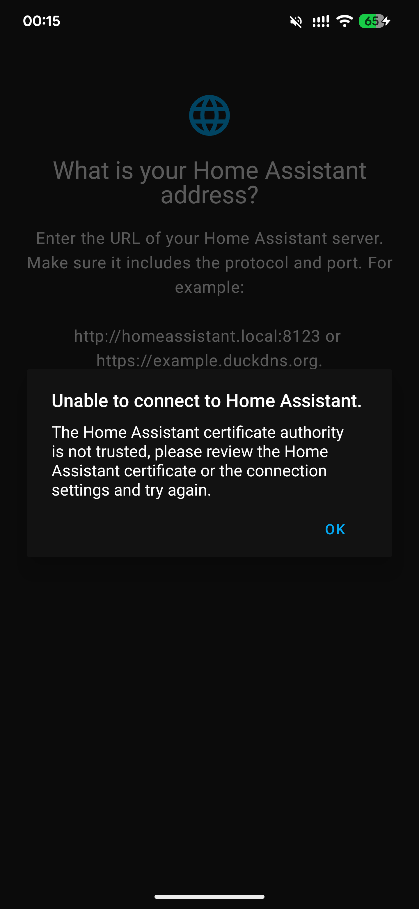

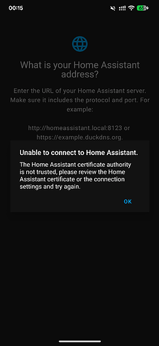

I suddenly get that this error screen in the Homeassistent App since some point yesterday. I’m using the Local tunnel setup.
Accessing hass through the browser on the same domain still works fine on both the same phone as well as other devices (with the certificate being valid)
The app also works totally fine on another phone with the domain, it’s only this specific pixel 7 with this domain with which the App doesn’t work anymore. I also connecting to a Friends instance that’s also tunneled through Cloudflare and that also works. I also already tried deleting cache/data/reinstalling/restarting but that didn’t help. I tried connecting through Tail scale in the app which worked fine. I didn’t change anything about my setup, especially not when it stopped working.

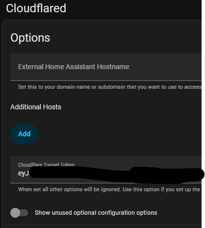

Cloudflared is installed as addon within ha os? Or external machine? Could you also send the addon config what the settings look like…
Thanks for getting back to me. Yes Cloudflared is set-up as an add-on, but I’ve set-up the tunnel first on Cloudflared as the sub domain is the one used by my own machine. So the config for the remote tunnel in the add-on is just the tunnel token.
BTW I did try localhost:8123 first, but that appeared to use the ipv6 loopback address and failed just the same
