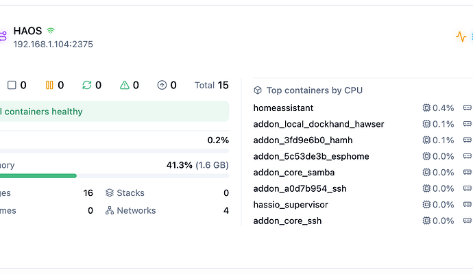

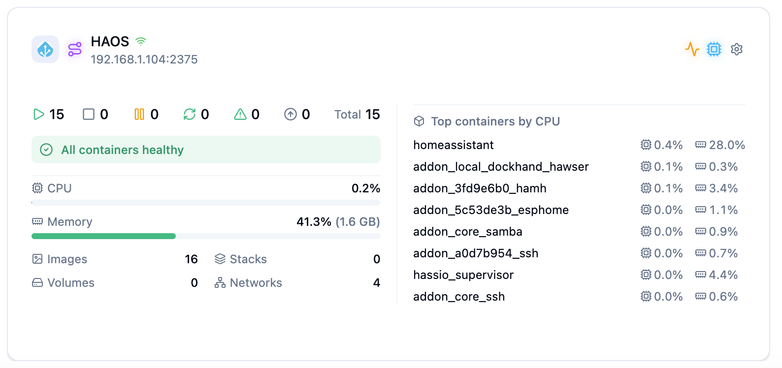

Your HA host appears in Dockhand as a regular Docker host, with a live overview card (container counts, CPU/memory, top-CPU containers), the full container list with state/image/uptime/resource usage, and a built-in terminal for exec'ing into any container:
