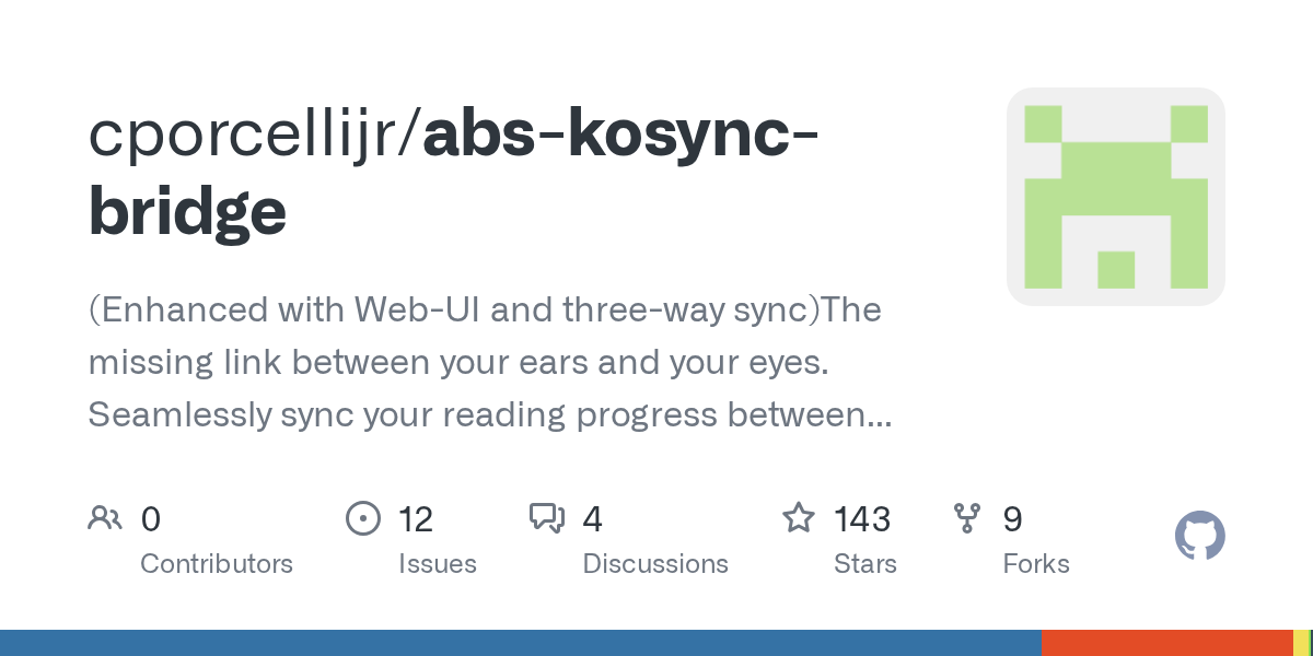

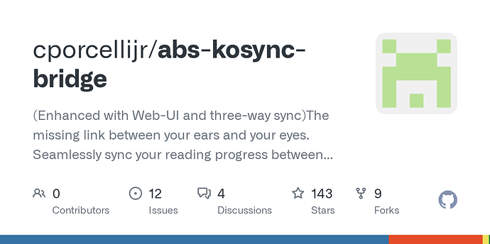

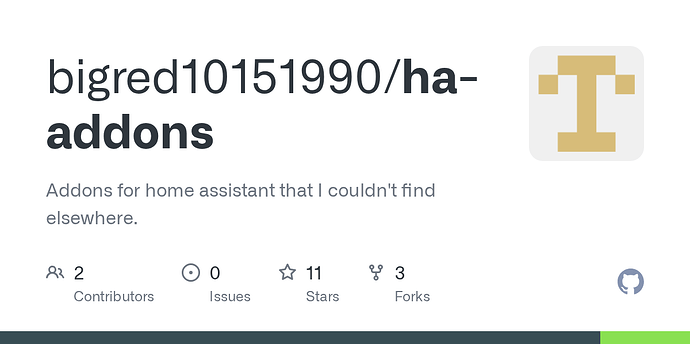

Next step for myself - find a way to get this working with Audiobookshelf for synchronization!
I make use of the HA Audiobookshelf server app and I see there is an interesting project in the works ā€˜abs-kosync-bridge’ if you were ever interested in taking a look.
The synchronisation project:
The ABS home assistant app I’m using:
