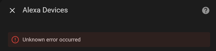

I opened up the Home Assistant app on my phone tonight and found that there was an update. I had a bit of a look at what changes had been made, and saw that there was a new Alexa integration which I thought would be cool. So I updated and then tried to set up the integration, but I haven’t had any success.
When the integration setup opens, I find that the correct country, which for me is Australia, is already selected. I enter my email address, password and then the corresponding code in from the authenticator app and I then get a message above all this that says - Unknown error occurred.

I’m back to trying to get this integration to work. Each time I’m getting the error “Unknown Error Occurred”.

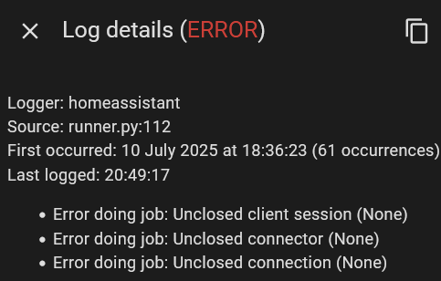

I removed the Alexa integration and now I get the same error as described above when trying to readd it. The following entry from my log appears to be relevant:

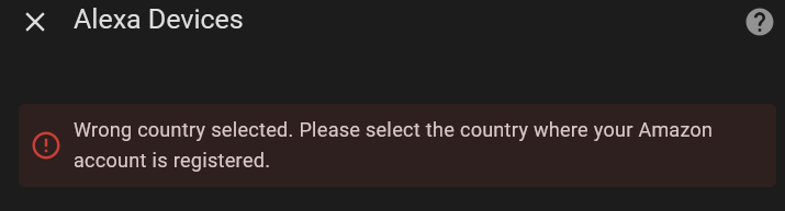

I’ve managed to setup the integration. I’m in Australia, so I was selecting Australia as my country but it wouldn’t work. Tonight I set the country and USA and it worked and I was able to setup each of my devices. Not sure if it actually works, but at least I’m that little bit closer.

Going back to Australia give the unknown error:

Exact same issue. Also in Oz.
Might be related to this "Unknown error occurred" when setting up Alexa Devices (Australia) · Issue #148777 · home-assistant/core · GitHub
I would say that’s exactly the issue. Good to see that there is a fix coming.
