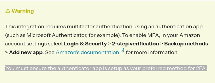

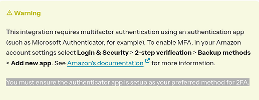

Based on the docs, you need to set up an authenticator app, not use SMS OTP from Amazon/Alexa:
