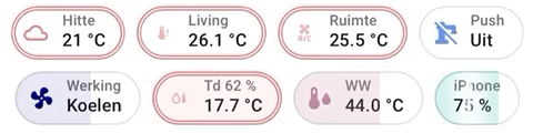

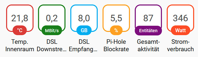

New badges and card-mod customisation
hey Liquid
While you’re at it, could I tempt you to check 🔹 Card-mod - Super-charge your themes! - #2052 by Mariusthvdb?
Ive managed the badges nicely and they are customized the way I want, including borders box-shadows etc.
however, setting a box-shadow reveals the border of the section below the badges sharply when using the new scroll feature… without it, it is perfect.
Scrolling makes the section border quite visible directly under the box-shadowed badges.
please have a look if you can find the element we need to adjust to prevent that, I am not entirely sure which it even is, is it the section below, the set of badges…
Really nice work on the badges and the information you provided is robust!
It also helped me solve card-mod issues with Mushroom Template Badges.
I’ll definitely take a look!

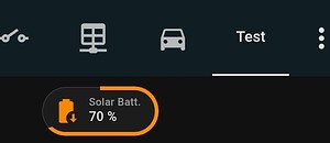

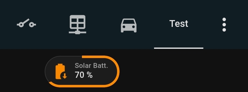

This certainly works, it gives you examples of a bit of everything : color, icon, border, animation, etc.
Hope it helps (this is the result of various explorations and tips from others in this thread)
type: masonry
path: test
title: Test
cards: []
badges:
  - type: custom:mod-card
    card:
      type: custom:mushroom-template-badge
      content: "{{ states.sensor.qcells_cloud_soc.state_with_unit }}"
      icon: >
        {% if states('sensor.qcells_cloud_battery_charge') | float(2) > 0 %}
          mdi:battery-charging
        {% elif states('sensor.qcells_cloud_battery_discharge') | float(2) > 0 %}
          mdi:battery-arrow-down
        {% elif states('sensor.qcells_cloud_soc') | float(2) < 11 %}
          mdi:battery-10
        {%- else -%}
          mdi:battery
        {% endif %}
      color: >
        Green
        %}  DarkOrange
        {% elif states('sensor.qcells_cloud_soc') | float(2) < 11 %}   Red
        {%- else -%}   Green
        {% endif %}
      entity: sensor.qcells_cloud_soc
      label: Solar Batt.
      tap_action:
        action: more-info
    card_mod:
      style:
        mushroom-template-badge:
            ha-state-icon {
                animation: pulse 2s ease-in-out infinite;
              {%- else -%}
                animation: none;
              {% endif %}
            .badge::before {
              content: '';
              position: absolute;
              top: -1px;
              left: -1px;
              right: -1px;
              bottom: -1px;
              border: 3px solid var(--badge-color);
              border-radius: inherit;
              mask: conic-gradient(rgba(0, 0, 0, 1) 0% {{states('sensor.qcells_cloud_soc')}}%, rgba(0, 0, 0, 0) {{states('sensor.qcells_cloud_soc')}}% 100%);
            @keyframes pulse {
              0% {
                transform: scale(1);
                opacity: 0.7;
              50% {
                transform: scale(1.2);
                opacity: 1;
              100% {
                opacity: 0.7;
          ha-card {
            background: none;
            border: none;

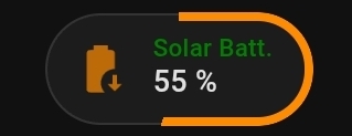

Replace the last block with the following (I used green as a target color):
      ha-card {
        background: none;
        border: none;
        --secondary-text-color: green;
