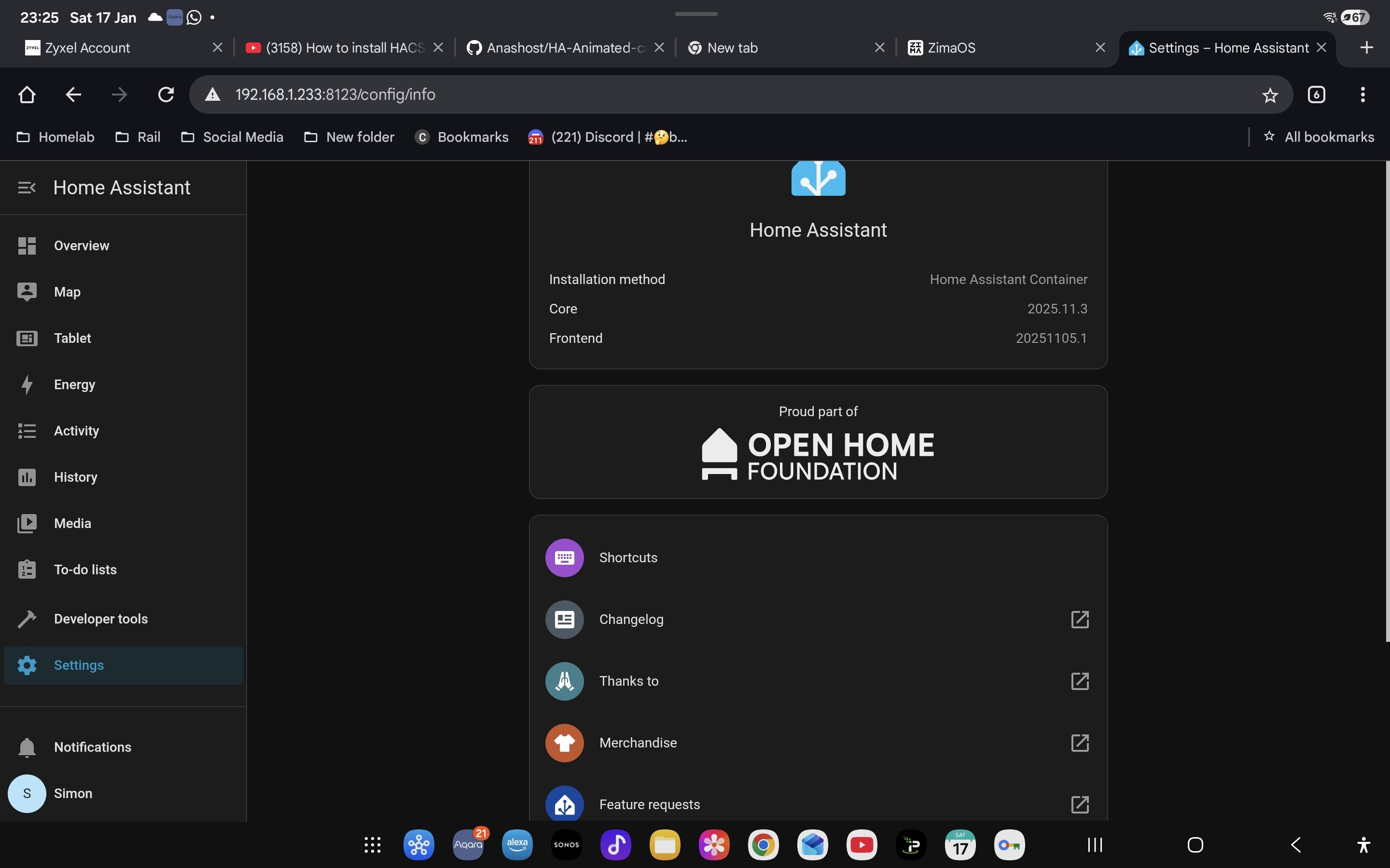

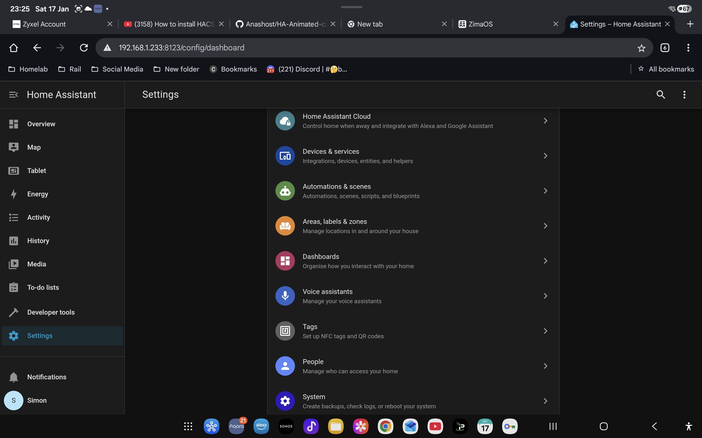

I have just installed HA on zimaos for some reasonson there is no add on feature so i cannot install hacs also it says the version is 2025 11 03 but says no updates

You are running a Container install which does not support Add Ons or One-click updates. Please review the Installation documents for more information on what is supported by your chosen installation method.
See also: Common tasks - Container
To install HACS you will need to follow the directions for Downloading HACS - Container.
Settings > Terminal wget -O - https://get.hacs.xyz | bash -
