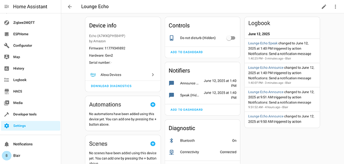

A restart resolved it, thanks!

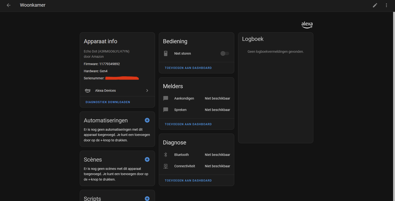

The state of my speakers are still ā€œunavailableā€.
Did a simpel HA restart and a complete system reboot (dedicated x86 system) with no luck.
