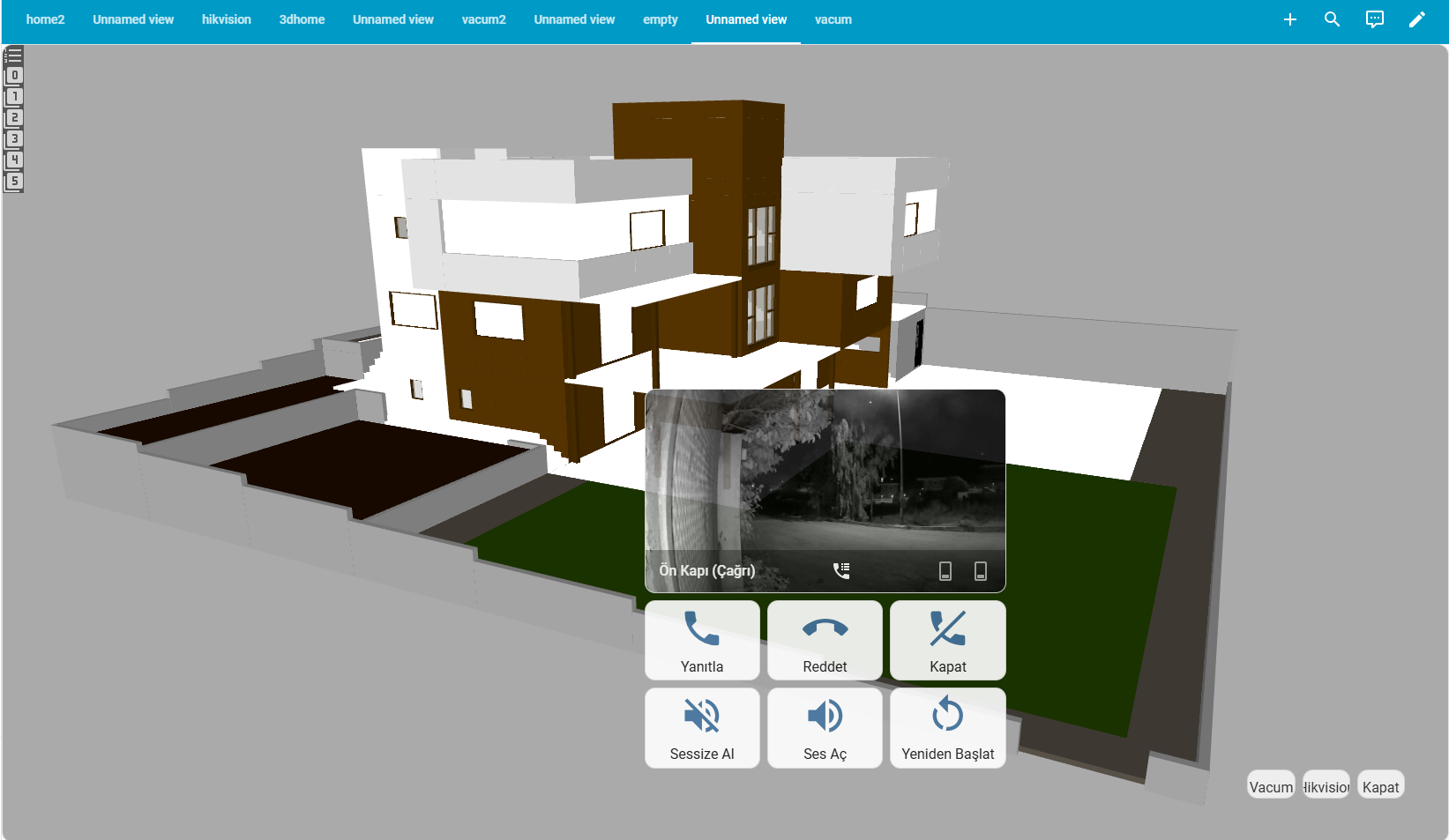

Very good idea and work. Congratulations…
I use this code a little differently.
Panel view
Horizontal stack card
Card1-Live 3D home plan works with three js
Card2-Vertical stack for Embedded View Action Codes “tap action”
Card3-Embedded View card with css (card-mod)
type: custom:embedded-view-card
mode: dynamic
target_entity: input_text.window_view
ha_card: false
card_mod:
  style: |
    :host{
      position: absolute !important;
      z-index: 1;
      right: 100px !important;
      bottom: 50px !important;
      opacity: 0.9;
      height: 50% !important;
      width: 50% !important;
Is it possible to call cards?
Is there a close action? (I used***data: value: dashboard-test/empty)
Some css (bottom, right, left etc) The positioning of the cards behaves differently and cannot find their place properly.
Can anyone advise me how to use CSS (Card-Mod) effectively?
Thank you in advance to those who will help

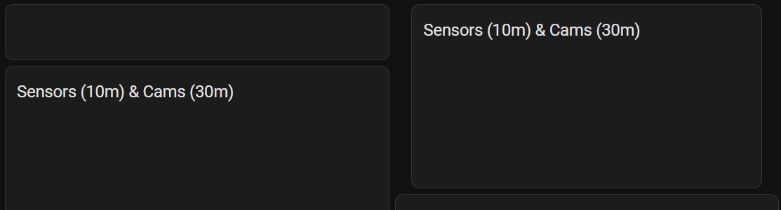

I’ve started on a modular dashboard setup and ran into an issue:
I haven’t found a setting yet, that works when I want to integrate the module view into an existing view so that it fully lines up with the other cards.
The card on the right
and the card on the bottom
are the embedded cards.
I’ve tried a lot of different values for the ‘Bleed inline’ and the ‘Bleed block’ but can’t get it to work so that the embedded view card lines up with the other cards in the view.
I seem to be able to be getting it right for one view or the other, i.e. one or more, but not for all of them.
And then viewing it in the mobile app does something different again - the bottom card is the embedded one:
Any hints?
Hi, thanks a lot for your comment. :orange_heart:
Action support will be implemented in the next version. I’m currently working on it, but unfortunately I’m running out of time at the moment. As soon as it’s available, I will post an update here in the forum.
A dedicated close action is also something I will look into during development. It sounds useful and should be technically feasible, so I’ll test whether it can be added to the next release as well.
Regarding the CSS: I’m not fully sure yet what the exact issue is, and I’m not experienced enough with complex Card-Mod positioning to give reliable advice here. If you can explain a bit more about what happens on your setup, I can try to understand the problem better.
